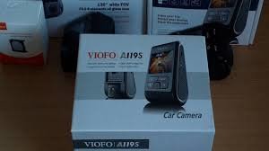

    I've heard that the s model isn't worth the extra cost over the older 119
  5. Feb 1, 2017 at 8:35 AM
    #145
    greentaco84
    greentaco84 Well-Known Member
    May 30, 2015
    #156350
    78
    dan
    02 green ext. cab sr5
    I saw a YouTube video of both A119&A119S and decided to get the s version.
