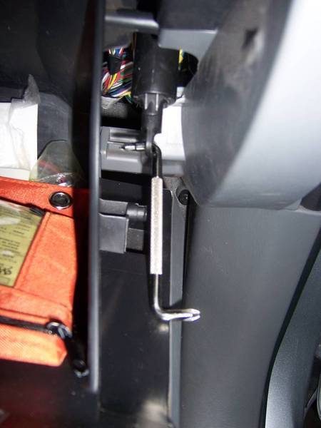

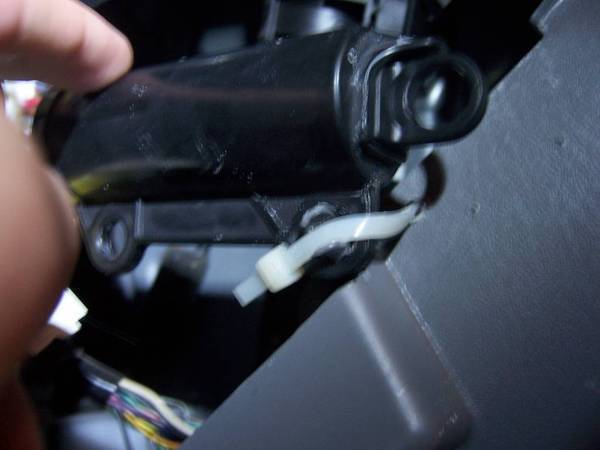

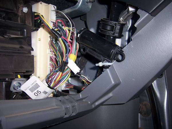

    Well I lost my bag of zip-ties so I don't want to take this one off but here is the final product.
    up close. line up your hole with the slot. then attach the damper, thread in the zip-tie, get it snug, and cut it. there was nothing behind that panel for me but check before drilling anyways.
    I can't get my hand in to pull the damn thing down to attach it to the glove box, so I use my handy dandy screwdriver thingy to pull it down.
    and all done! enjoy! :D

    Sorry guys, but it's not the damper that's the problem. It's the dash. And a dash will cost you more than $3 (or even $14). The problem is that the part that's supposed to stay spread on the dash that slides into the hole on the damper doesn't stay spread apart. Thus the damper just slides right off.
    To the OP, I'm sorry but that just looks tacky IMO (plus zip ties wear out and do break). Should have either gone the screw route or the double-sided 3M tape as shown in the link I provided. I can say the screw method has held up for over 5 years now since it was winter 2005 when I installed mine.
