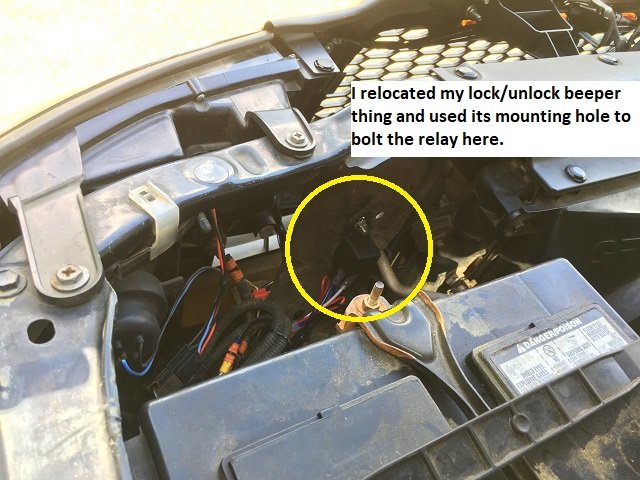

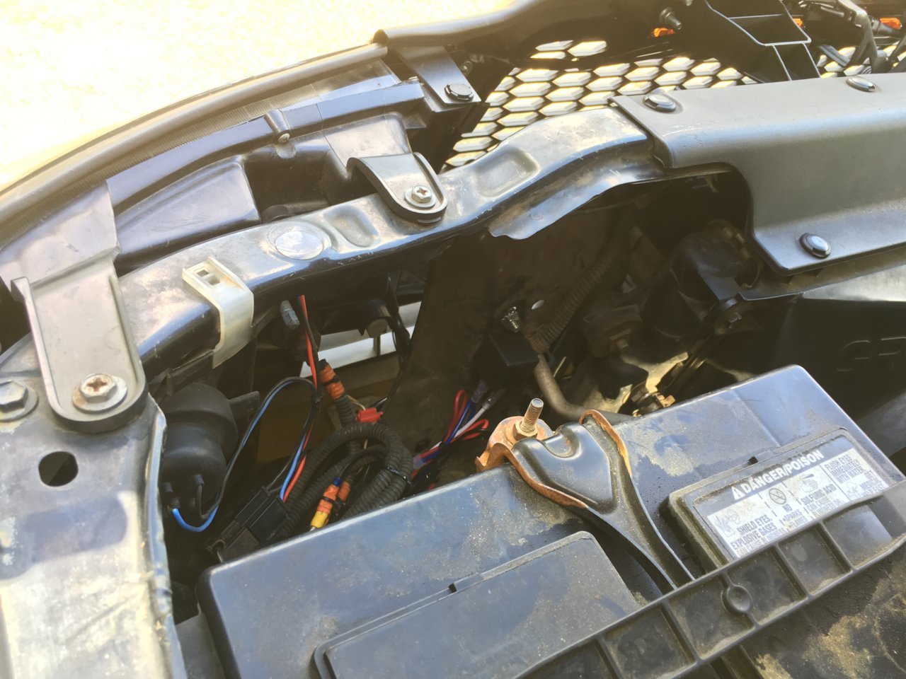

    I mounted the relay behind the grill next to the radiator. There was a beep module there that made a beep when you unlock/lock the doors with the key fob that I disconnected on day one of owning the truck. I relocated that module to the passenger side fender and bolted the relay in its mounting hole.

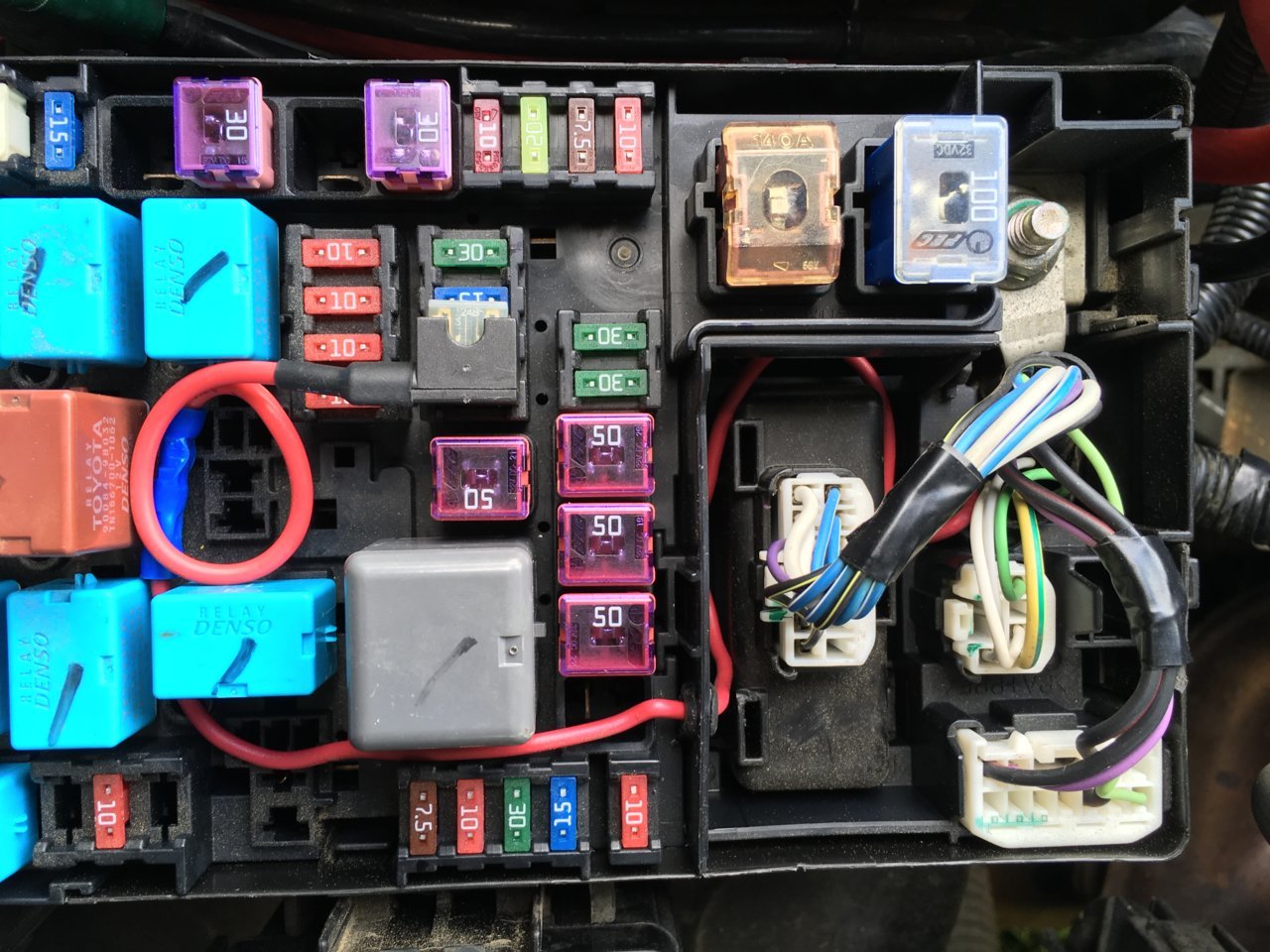

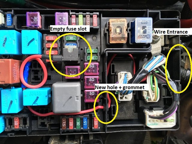

    I grabbed the power for the lights I added from the engine compartment fuse box. There was an empty fuse slot with constant power on it so I ran a wire through the main box entrance on the engine side, made a hole in the divider and installed a grommet to run the wire through to the fused lead.
    The relay you need is a simple automotive relay with four terminals. The five terminal version gives you both normally open and normally closed contacts which you don't need for adding lights unless you want to get fancy with control options or something.
    Essentially you power your ON/OFF switch (which controls the relay coil) in the cabin off of an add a fuse, run the power out of the switch to the relay's coil contact marked 86, and ground the other relay coil contact marked 85 in the engine compartment. This enables you to run a single wire through the firewall for controlling the relay (use automotive primary wire).
    The power you steal in the engine compartment fuse box goes to terminal 30 on the relay, and your light positive wire connects to the NO (Normally Open) relay contact numbered 87. When the relay coil is engaged, it connects the two terminals and passes power on to the accessories that are connected to it. Your negative for your lights needs to be connected to a decent convenient ground location to complete the circuit.
    Power from the switch and power feeding the lights are isolated from each other now, and you can use the appropriate sized fuses to protect each circuit.
