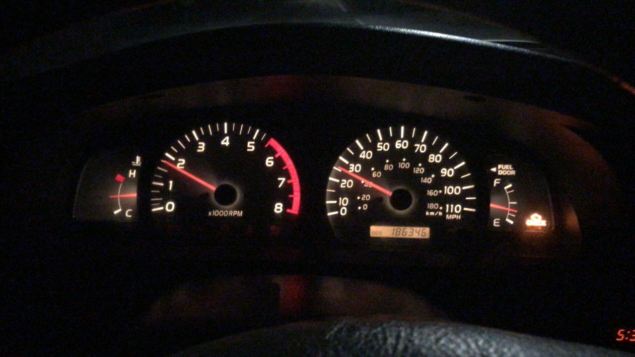

    I thought the blown fuse must be why lights aren’t working but I replaced it and still nothing. The bottom dash lights do work (Battery, Ebrake, etc)

    Replaced everything with 194’s and it works.

    That CEL is so bright it looks like it might melt :facepalm::annoyed:
