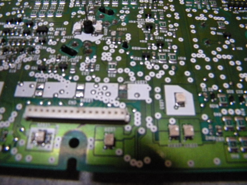

    hey guys...i did the mod the other day and i got most of the leds to work. the main speedo and odo will not light up....i think i may have jacked up a connection point on the board..anybody know how to fix that?

    Open it back up and check all your solders. You probably just have a cold solder so just check them all and also make sure the polarity is correct.

    ya could be polarity or it could be solder shorting out the pos and neg terminals, you should just remove them clean all the solder of the led and the pcb, then start over.

    take a pic of how you jacked it up so we can help you...if possible...

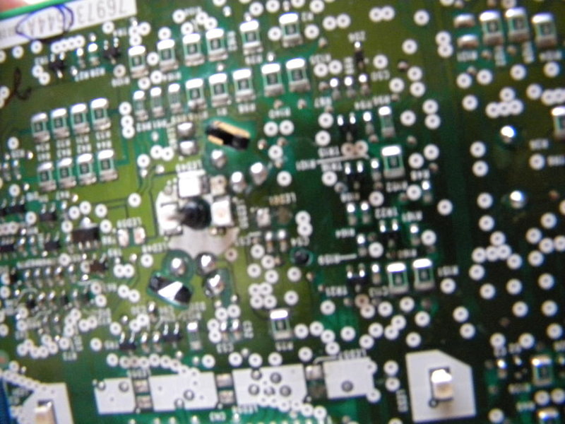

    hey guys these are the pics of my board...idk what to do the speedo and odo dont work anybody have an idea

    To me it looks like a connector on the board came off
