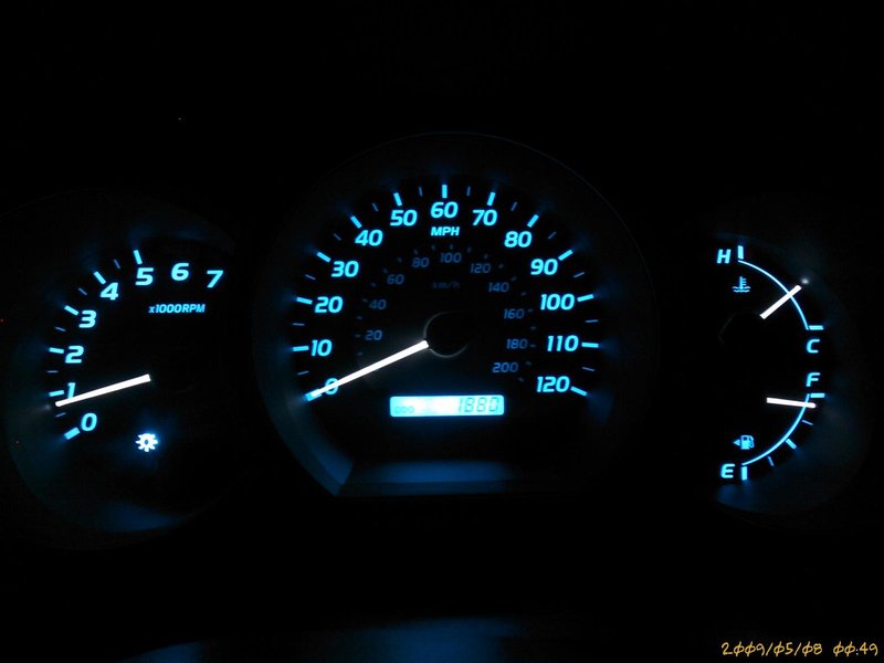

    I did mine, but the only thing is that the red in the RPM side and the red on the temp guage does not show up, I dont know why. I used the blue leds from oznium, and replaced them accordingly. Everything lights up beautifully except for the red parts. Anyone have any idea?

    What is still supposed to be red?

    On the RPM gauge where it hits 5.5K RPM it goes redline, mine doesnt light up like the other blue on in the second post.

    it really depends on what you want to do. here is a list how many LEDs you need:
    Tach = 2
    Tach Needle = 2
    Speedo = 3
    Speedo Needle = 3
    Temp = 1
    Temp Needle = 1
    Fuel = 1
    Fuel Needle = 1
    Odometer = 3
    Turn Signals = 2 per side
    Additional indicators (ie gear selectors, CEL, Batt, Cruise etc..) = 1 per light
  17. May 15, 2009 at 2:37 PM
    #37

    well, then according to what i gave you above, you need....
    tach
    speedo
    temp
    fuel
    odo (if you want this too)
    ....i'll let you do the math;) also, i doesnt hurt to get a few extra LEDs just incase!
    i personally did everything possible (but warnings and R) blue and left the needles as is. some have changed everything, others have changed the bare min....its really up to you what you want.

    needles have their own LEDs as well as there is an orange film on the backside. some guys have scraped that off w/ a knife or rubbed it off w/ alcohol.
    i dont even know if you can just buy the needles anyways. w/ this mod, you just change the LEDs, nothing else gets swapped out.
