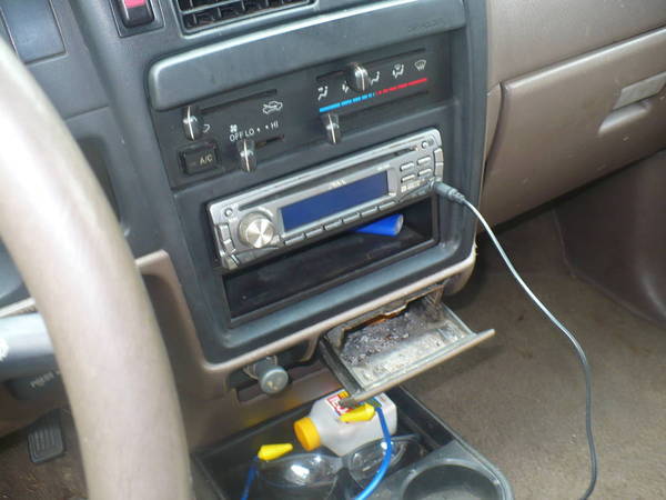

    Any chance you have an after market head unit? When I put mine in my old taco the same thing happened. Took it in and they said that I pulled just enough on the wiring harness to unplug some of the wires that run my dash cluster lights? Kinda a shot in the dark but I figure I would throw it up there

    This is what I have. It came with the truck, just a face plate. Radio doesn't work, because antenna is broken. Previous owner broke it off, I guess. I put it in the truck when I first got it running, and it's had it installed for a while now- it's been just the past few days that these problems have been coming up with the lights.
    I don't even have trailer wiring on the Taco. I don't even have a receiver. I will eventually, but when I bought it, there was no sort of towing package on it. It's probably never pulled a trailer.
