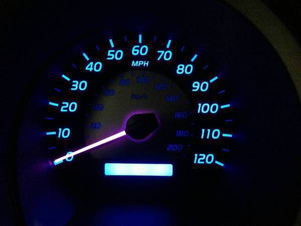

    Here's an example of a purple needle since I haven't seen any pics of one. I did this as a test using a white, blue, and red led, but ended up using only white and blue. The needle is painted white too.

    The needles in my truck are red so dose anyone know where I could get some clear ones or any other ideas would help thanks
  6. Aug 31, 2013 at 10:10 PM
    #186
    yosh2000
    yosh2000 Well-Known Member
    Sep 18, 2007
    #2733
    2,936
    CO
    '17 Tundra CM 5.7
    needles are clear with an orange film on the back of them. to get clear needles, scrap the film off (either by hobby knife (what i always do), chemical (acetone or nail polish remover im told) or sandpaper). to change the color, replace the LEDs that light up the needle. i highly suggest you also paint the back of the needle as well so that light shows up. i personally always suggest white, as this will have whatever color you change the LEDs for the needle to show up well at night.
    to my knowledge, there is not a company that sells just the needles. have to get a spare cluster to get them...which i would imagine would be costly.

    So if I paint the back of the needles white and put blue LEDs it will show blue ?

    ^^yes it will be sort of a light blue...for a darker blue paint them blue lol

    yep. the white basically gives something for the light to reflect off of, so it shows the LED color.
    they will be a nice blue, just like the LEDs original color. if you paint the needles blue, they will not be as bright at night and the needles could possibly be harder to see during the daytime. this is why i always suggest to anyone that i do the cluster for that they keep the OEM needles or go white on the background. it does not change the LED color at all and is still easily readable during the daytime light.

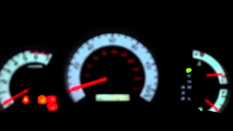

    Hi there, I am new to this forum. I am looking to do the dash board lights as my first Mod on my 2015. However I prefer the look of the older dash templates (not sure what its called) where its predominantly backed out and the numbers glow. As opposed to the 2015 dash template where the outer half is lite up and the numbers are black. Does anyone know if you can order different templates? and if so where?
  20. Apr 14, 2016 at 9:06 AM
    #200
    BCtacogirl
    BCtacogirl New Member
    Apr 14, 2016
    #184283
    4
    2015 Black Tacoma TRD
    This is my dash currently.. (sorry for the bad photo )
    Looking to change it to this ;
    Any help on tracking one of these down would be greatly appreciated :)
