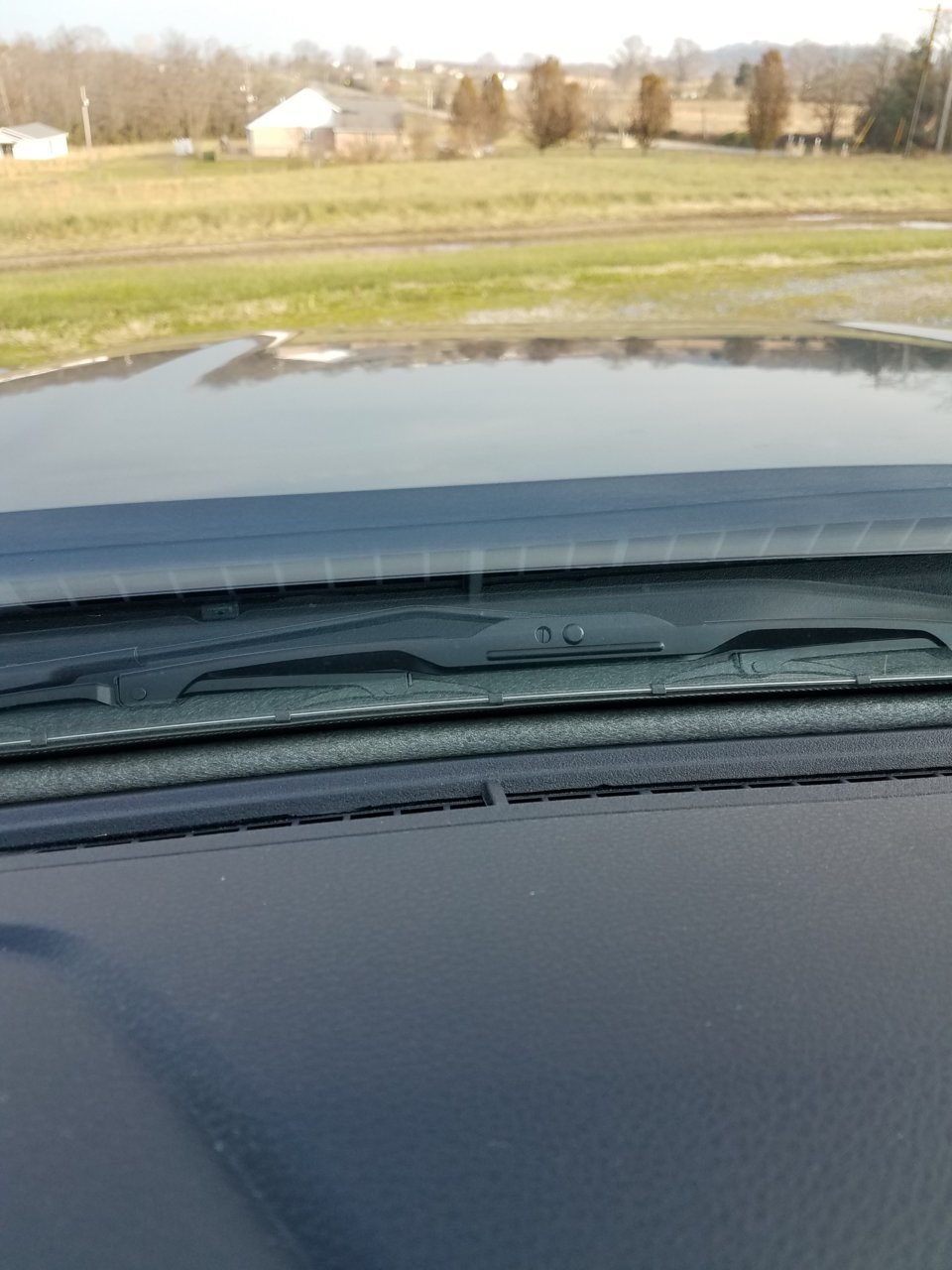

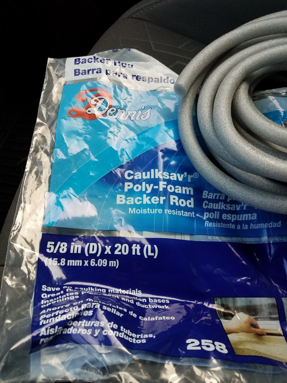

    I was actually going to make a new thread on this, I put stuff around the passenger side speaker grille and yet still had weird annoying dash noises. I picked up some of this round rope weather strip foam and stuffed it down between the windshield and dash and it is finally quiet.
