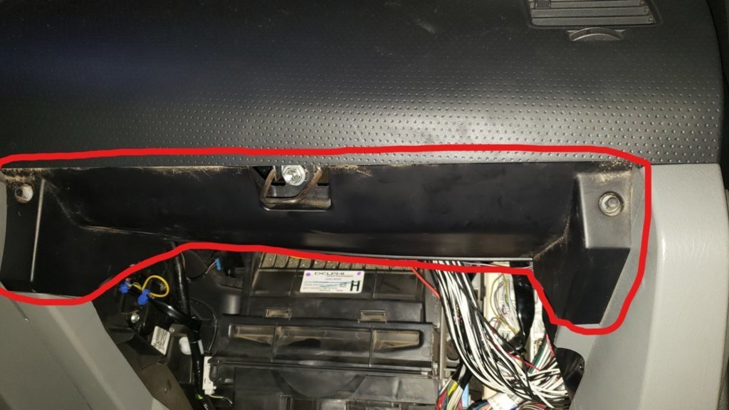

    Are you talking about this piece?

  5. Mar 31, 2025 at 1:53 PM
    Dm93
    Dm93 Test Don't Guess
    Mar 3, 2015
    #150066
    13,649
    Texas
    2014 DC OR 6spd 4x4
    Predator tube steps, Ranch Hand grill guard, Magnaflow CatBack exhaust, Toyota tool box & bed mat, 2LO Module by @Up2NoGood, Rearview Compass/Temp Mirror, Tune by @JustDSM.
    Yea that would be the whole dash pad your talking about.

    I enjoyed perusing the post you provided but saw nothing about removing my part. See my post for clarification.

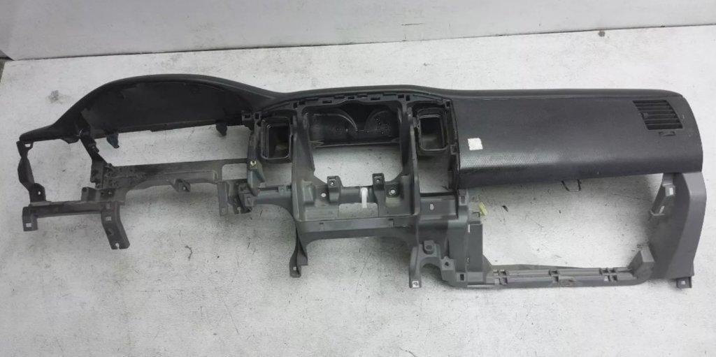

    Unfortunately, you're confused but @bagleboy and @Dm93 are steering you in the right direction. Maybe you shouldn't be rude to them. The part you referenced is "the dash". It's not part of the dash, it's the biggest of the dash - it IS your dashboard. The part with the dimples like you mentioned is not a separate piece which you can remove on it's own. You have to pull the entire dashboard as one main unit.

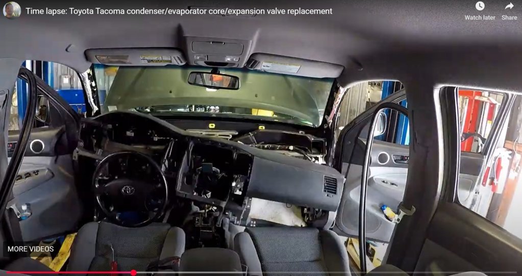

  10. Mar 31, 2025 at 2:17 PM
    Dogota
    Dogota 2015 DCLB
    Feb 10, 2019
    #282592
    132
    Mark
    Seattle, WA
    SR-71A and clenkeit like this.

    Quick. Guide. Remove A pillars covers. Remove left and right kick panels. Remove lower dash panels, remove glove box. Remove center console. Remove instrument cluster. Remove radio center dash pieces. Make sure to mark all plugs for reference. Then there will likely be 8 bolts and the dash pad will come off. It’s not a super hard job it’s just a lot of pieces to keep up with. Good luck.
