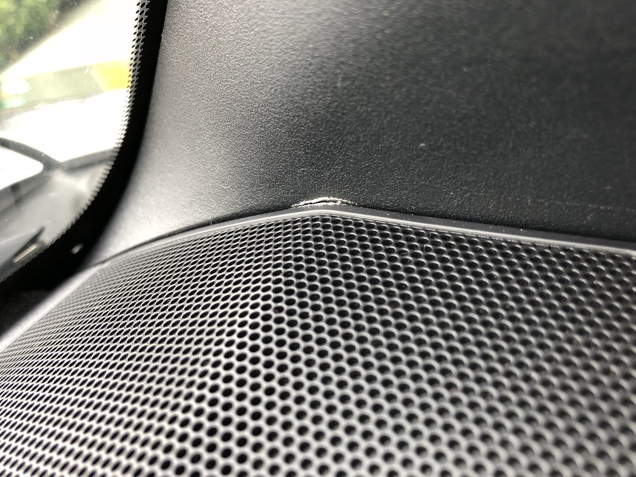

  8. Feb 7, 2018 at 3:53 PM
    Hank Heel
    Hank Heel [OP] Well-Known Member
    Sep 18, 2016
    #197637
    1,644
    WA
    Yea I looked at it and it looks real flimsy, also I don’t want to leave any marks from poking around. 03364F92-6889-4C65-AF74-3099D26C8B35.jpg

    I removed the speaker panel and A-post trim and used a one-sided razor blade to shave off a little surface plastic from both to create a little space between them where they were rubbing together. Also used a little thin foam and silicone caulk inside of both to reduce vibrations.

    So...to remove that rattling speaker cover, one needs to remove pillar cover first. I didnt do that, so broke a bunch of tabs on the cover. i ordered a new one and it should be here saturday. Once it gets here, ill go ahead and use some cloth tape and line all around the speaker grill, i hope that works.
