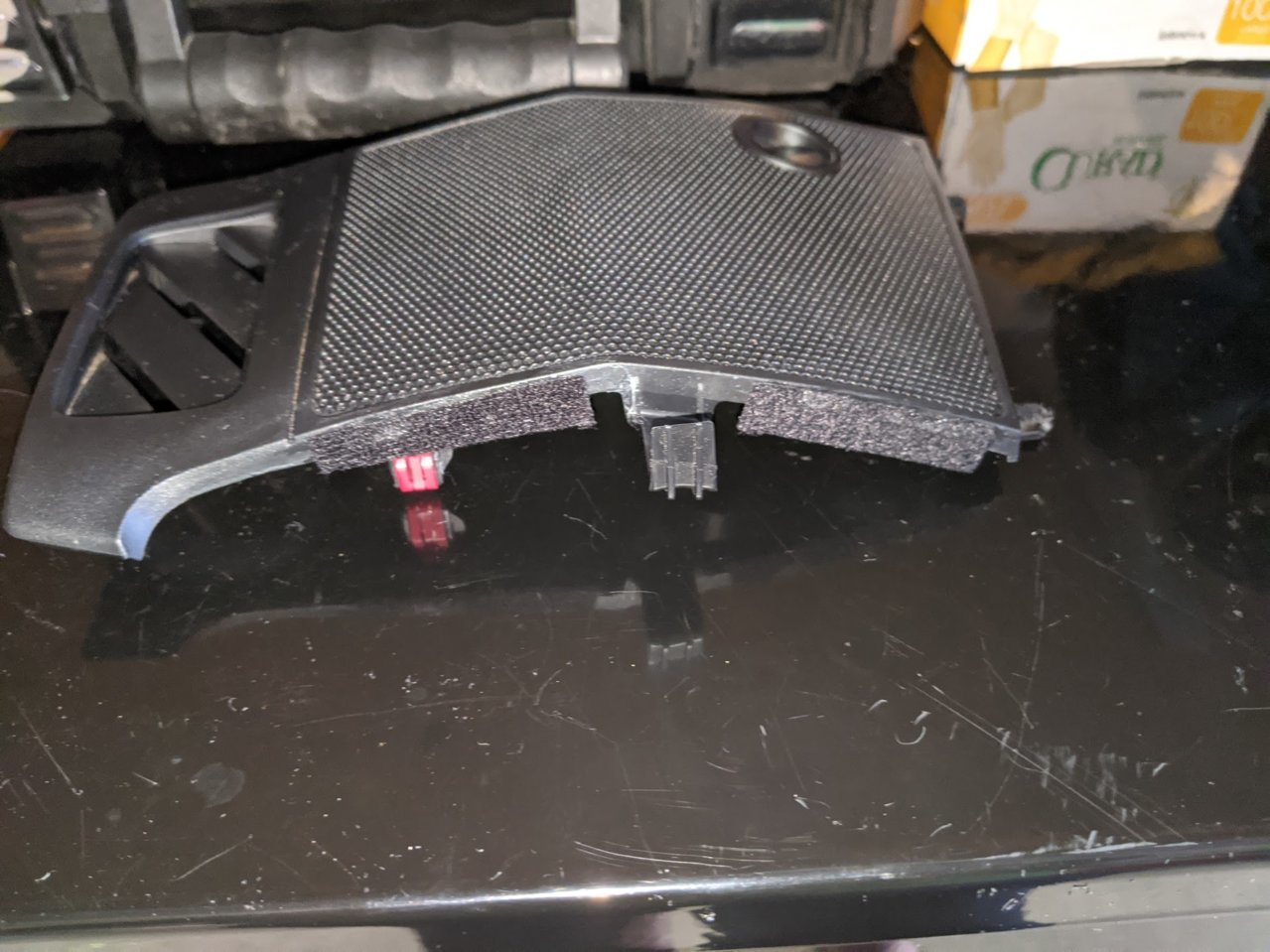

    If you stuff anything that you hope to not see, it will move and the noise will come back. This happened to me twice using sticky back loop tape. The summer heat and relative movement had it sliding off. This time, I used non-sticky back and crazy glue (cyanoacrylate):
    This was actually a couple pieces of one wrap. I shaved off the hooks. They are the little dots on the tool chest.

    Maaan thank you very much for the info and picture, this helps a lot. Do you know of a video or tutorial to remove these parts? I don't want to break any tabs or clips lol.
