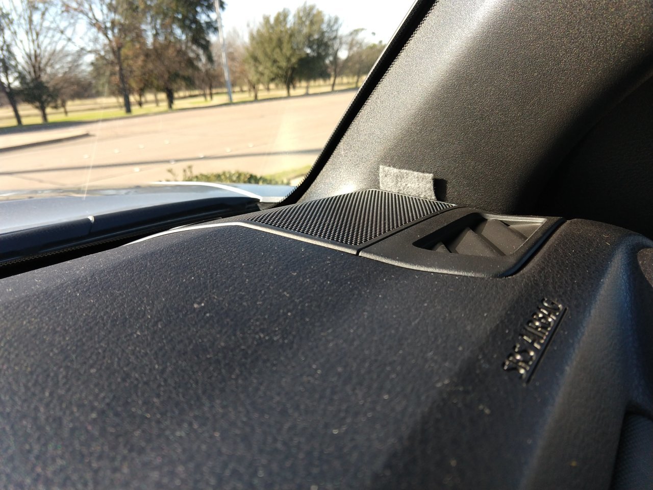

    The passenger side tweeter/a pillar was the culprit on mine. Had the same rattle on my 2017.
    I put a piece of felt in there. Here's a pic of where the felt is (I trimmed it after I verified this would fix it)
    fiftyxp likes this.
