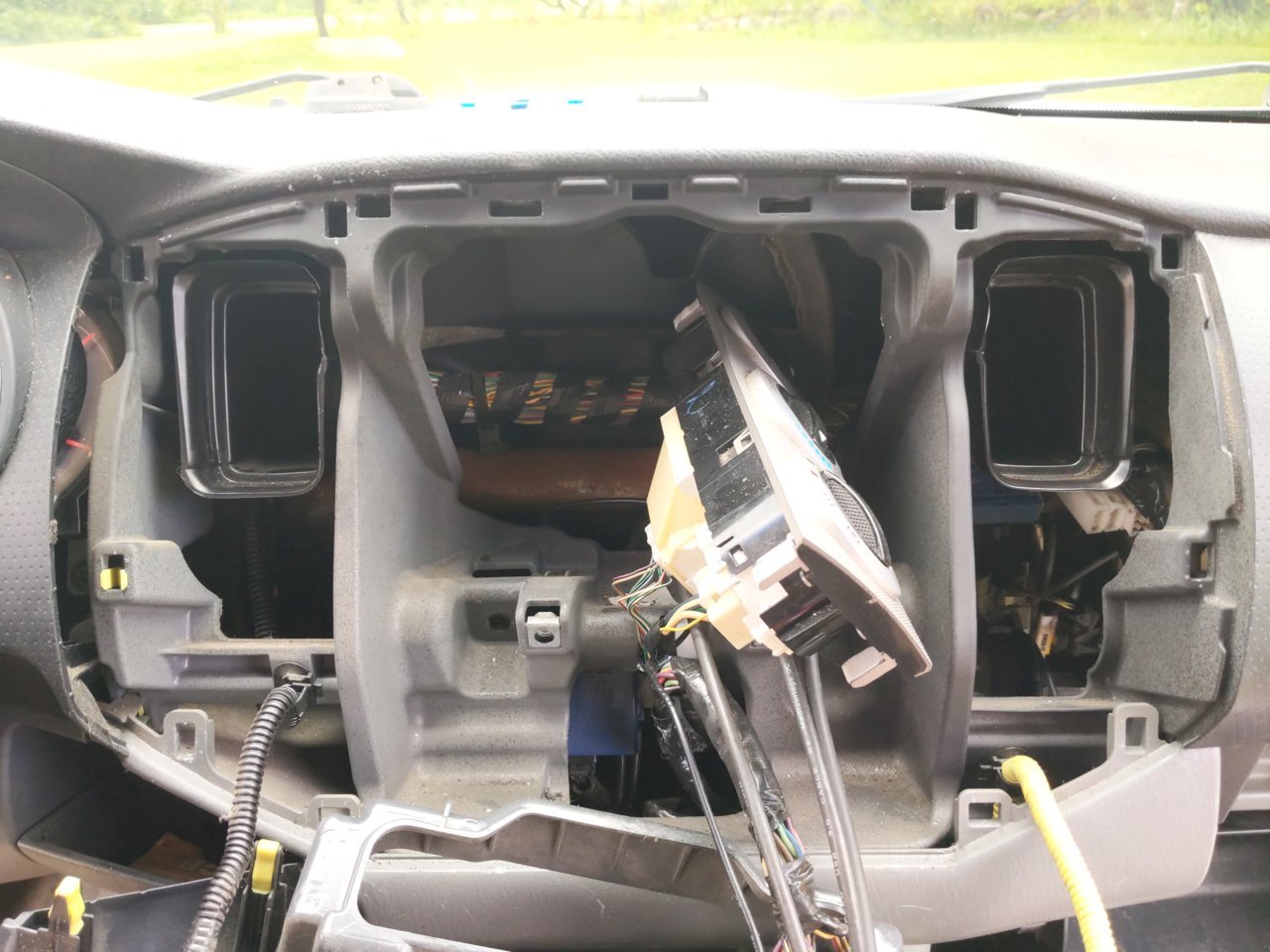

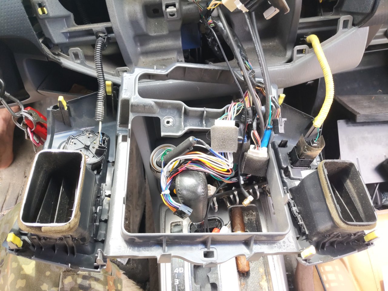

    The center bezel that carries the AC louvers and the head unit is held in by 8 push clips - the yellow guys in the below pic, same as what hold in the head unit:

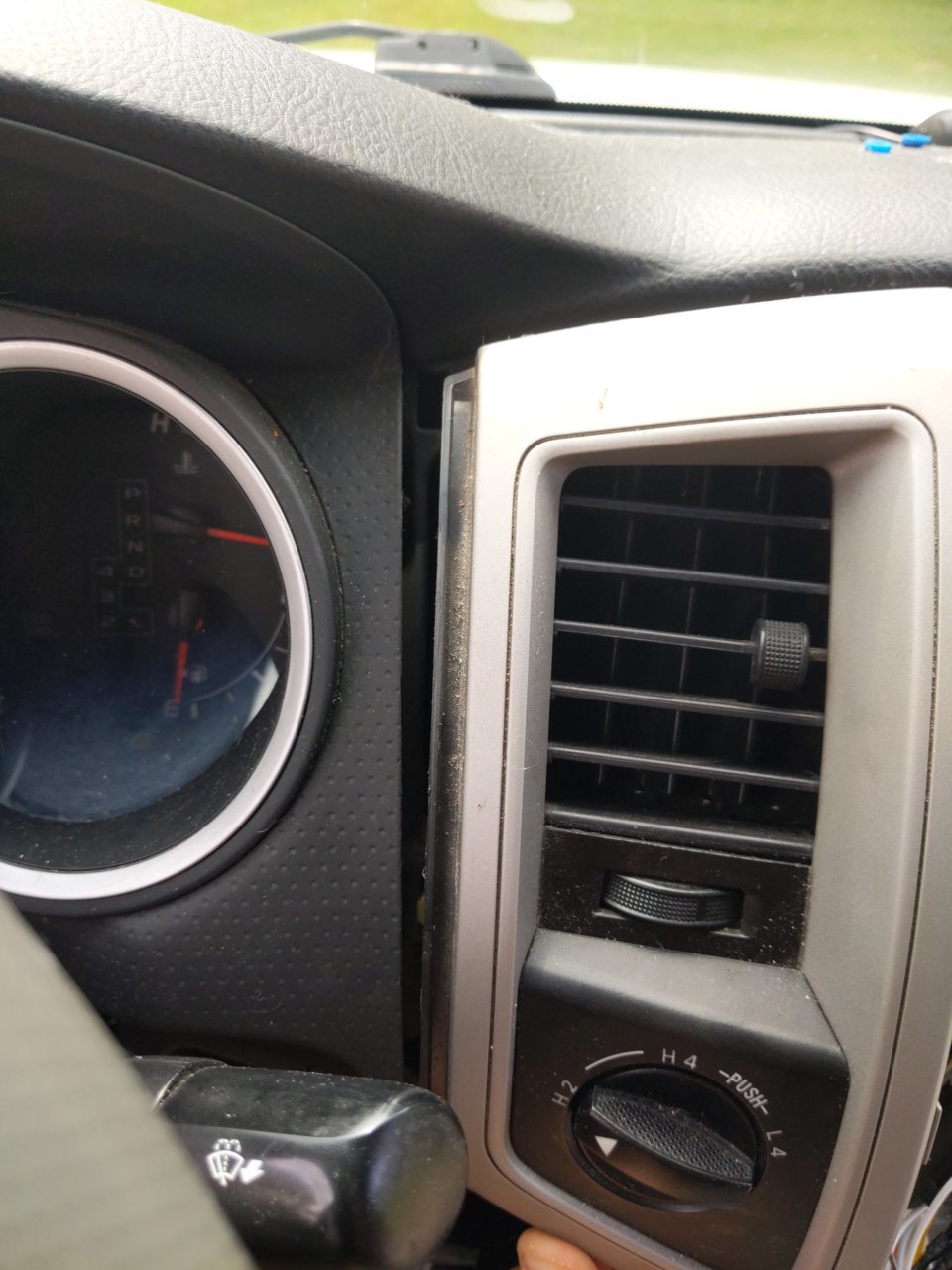

    The driver's side sits under the dash cluster trim with a lip. You can get it out without loosening the dash cluster trim but trust me, you can't get it back in without doing it:

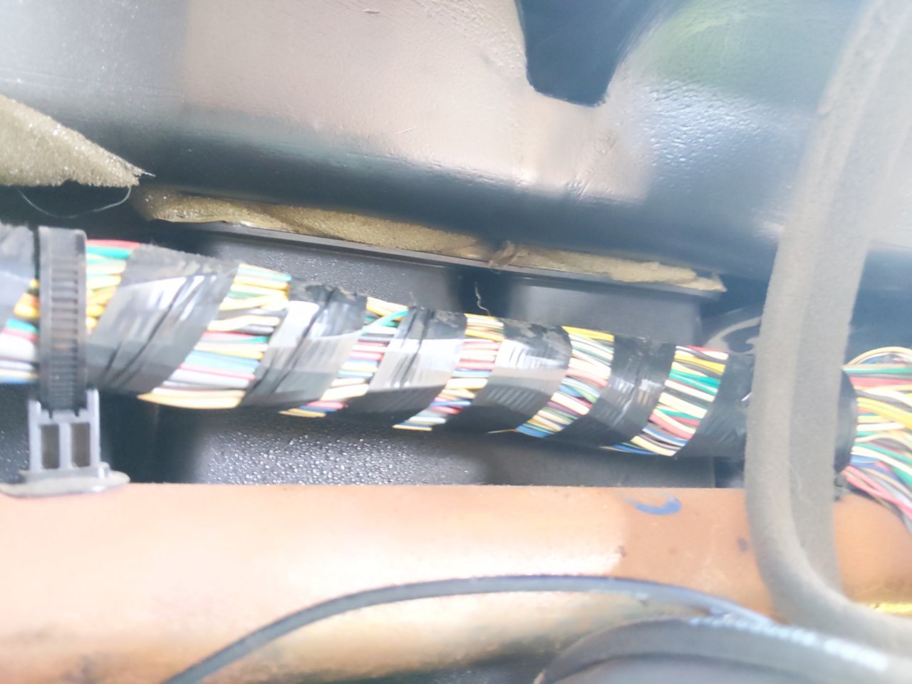

    The culprit was loose raggedy foam filler from the driver/passenger AC split manifold:
    I ran a coathanger with a scotchbrite pad wadded up on the end through the manifold. A shitload of foam dust came out but the noise was still there.
    After running a razor between the seam (as shown above, right above the wire bundle) and stuffing the scotchbrite through again, a big chunk of foam came free. Noise gone.
