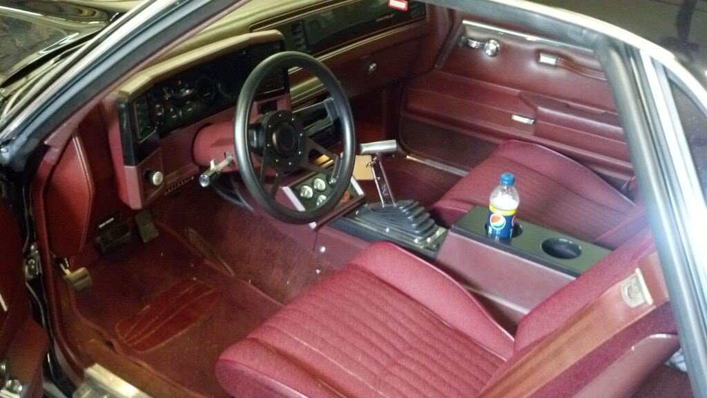

    I used SEM paint to paint the console in my el camino from black to maroon and it came out good but the color is a little lighter. you just have to clean it really good before you spray it. SEM paint touches up really easily to and isn't to glossy or to dull either.

    Looks good man. The part I'm dreading is tearing out my dash. Has anyone ever done this before? Is it a pain? I dont think I can but I only need to front part of the passanger side out.
