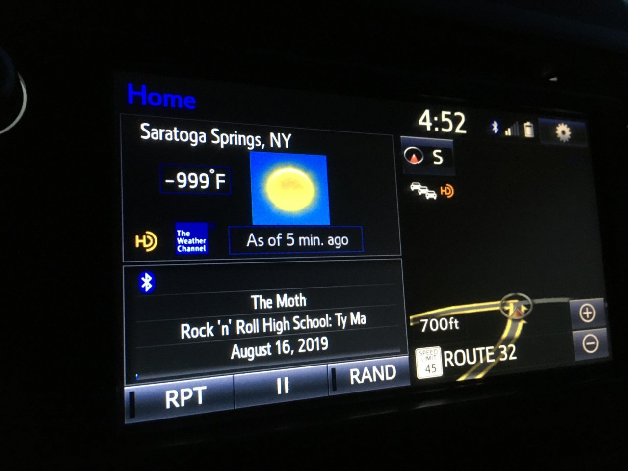

    Hey, 100 deg I can handle, but this?
    Actual outside temp was probably about 15deg F
