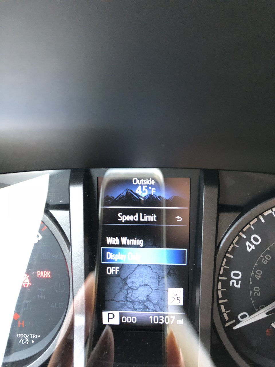

    Sounds like that dude was selling snake oil. I've been through the settings and there isn't a way to turn it off. Also, go through your steering wheel settings with the car parked. U can choose what info is displayed on which screen. Distance till empty, fuel mileage, compass and speed limit etc.

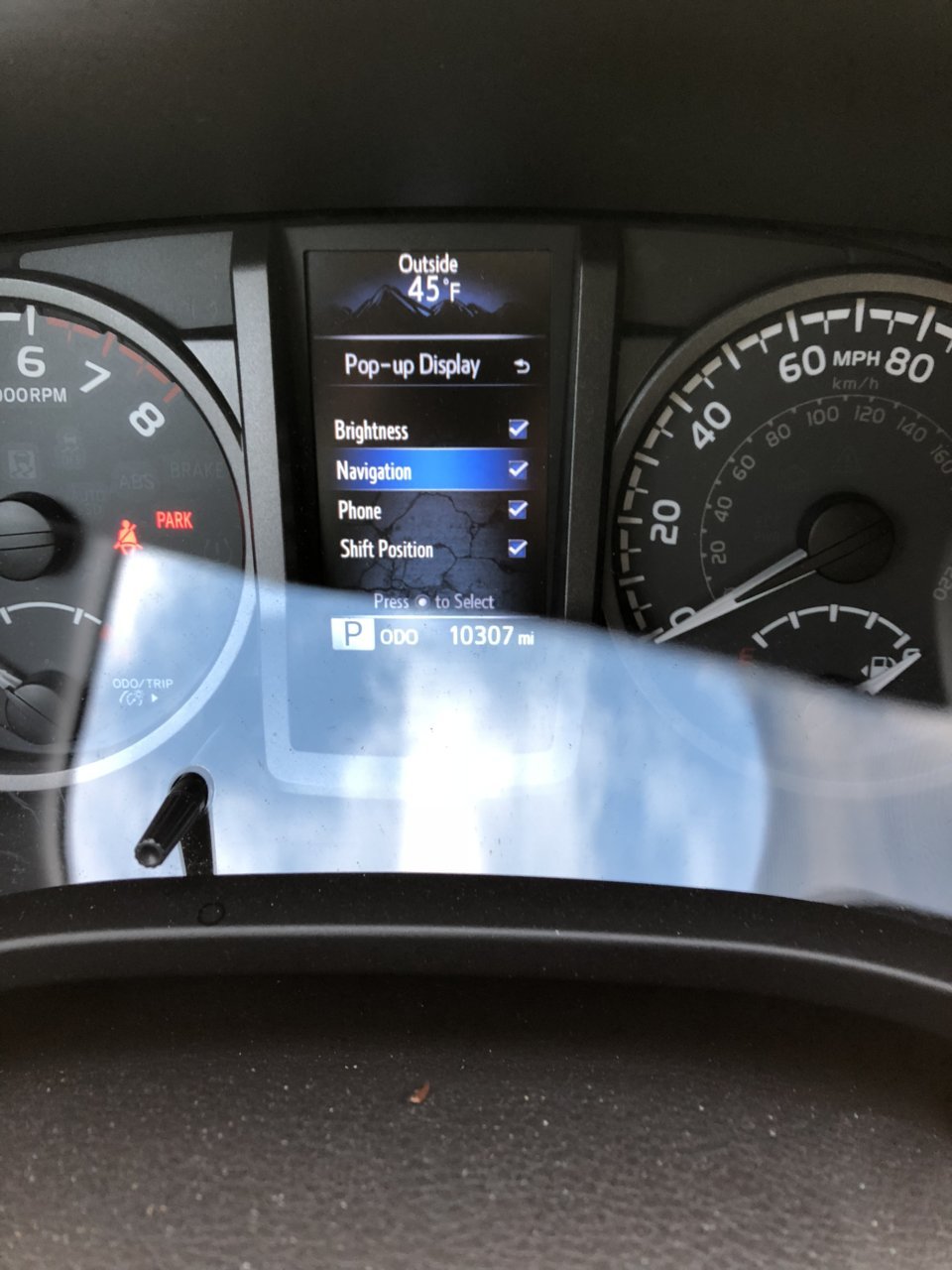

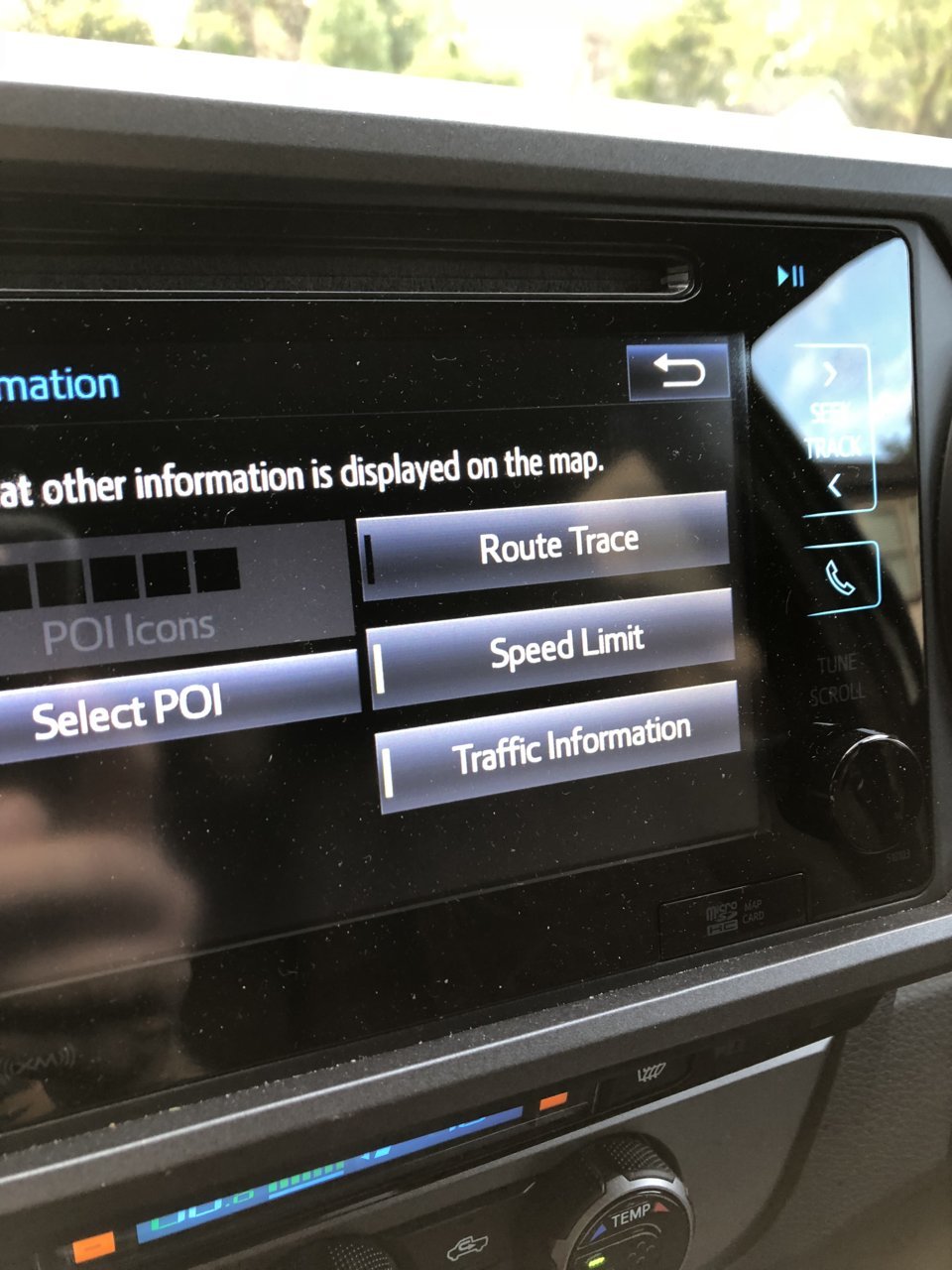

    To change nav. Info displayed go to
    Apps>navigation>map information and make sure speed limit is selected. Keep in mind that not all speed limits are loaded into the nav. Database,so sometimes one won’t pop up for me.

    Also try scrolling to the right, using steering wheel controls to the little gear lookin thing...select it, there are two areas to check, first select pop-up, and make sure navigation is checked. Then back out and select speed limit make sure it is set to display only
