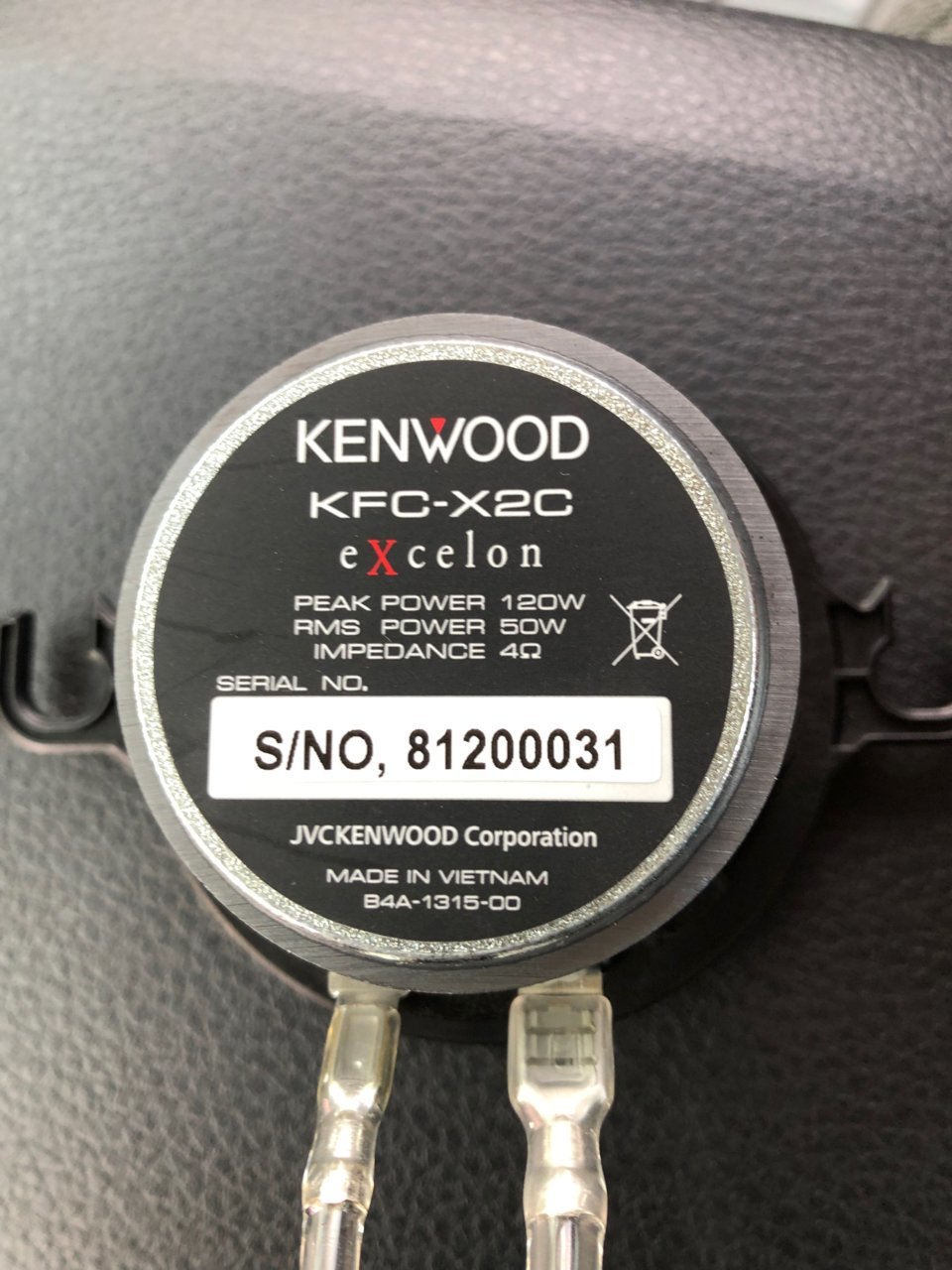

    I opted to replace all of my factory speakers. I used the recommended Kickers for the front and rear doors, but instead of using the Subaru dash replacements, I chose to use Kenwood KFC-X2C and the harness from ********* ($$$). It came out to a little less than the Subaru speakers and they are higher quality, IMO. The install was very easy and the speakers fit perfect into the Toyota design.
    Crutchfield was out of stock, so I ordered them online from Freeman's Car Stereo. They arrived in 2 days
    I have a standard radio, without NAV or SiriusXM. The dash speakers make an enormous difference.

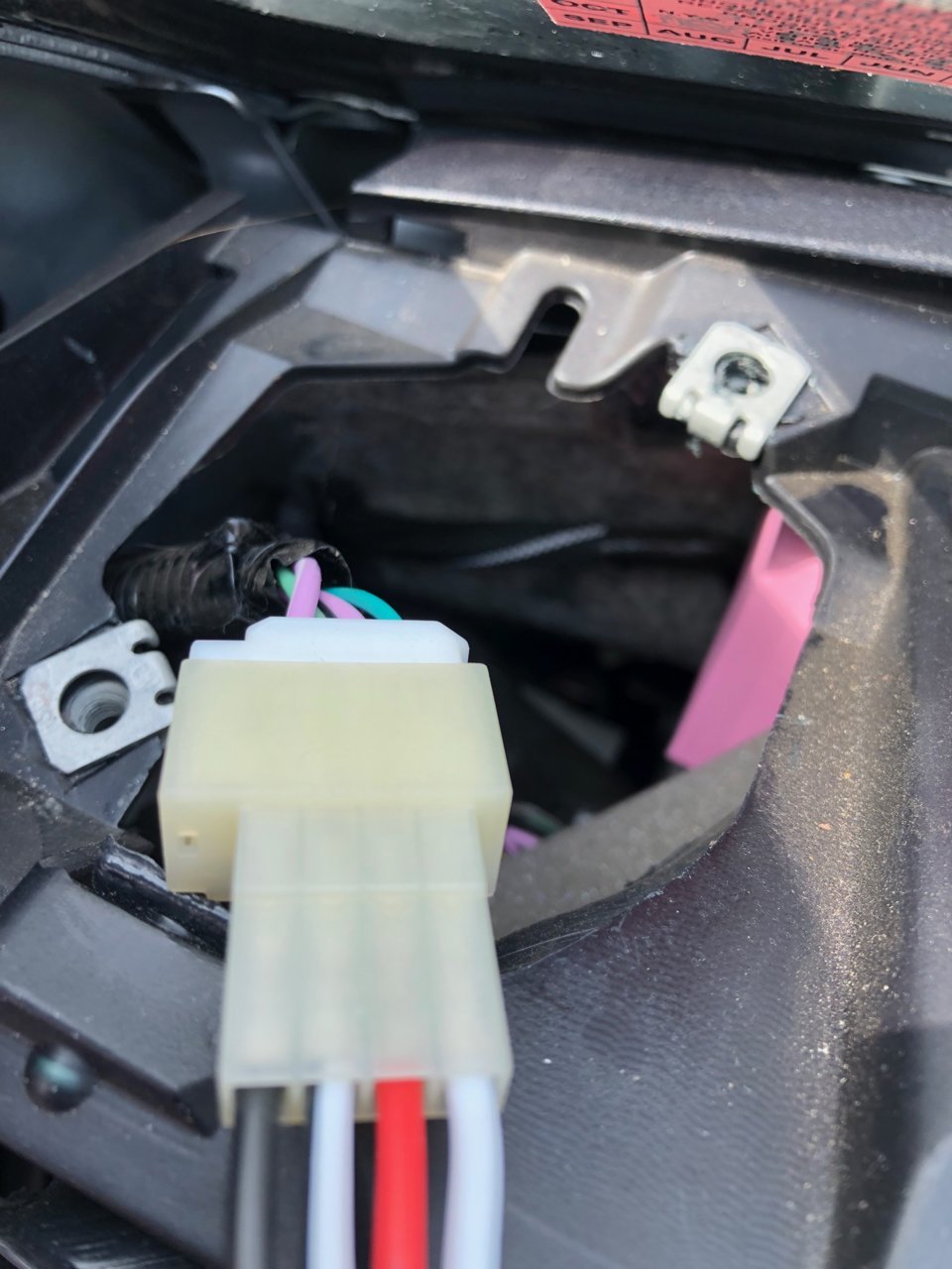

    How'd you wire the red, whites and black wires from that connector to the speaker?
    And did you leave the in-line crossover in place?
    Thanks

    If you do front speakers and get pigtail from crutchfield, make sure to zip tie pig tail to door on inside to eliminate getting caught in window regulator ... from experience after slicing wiring after a few window up/down operations

    I bought the speaker wire harness from *********. A bit pricey @30, but plug and play.

    Right, so did I. The thing is the plug and play harness has 4 wires coming off it, those 4 wires need to be hooked to the positive and negative on the Kenwood Speaker leads. It has to be wired in parallel so the door speakers will still work. So that was the question, how did you wire those 4 wires to the speaker?
