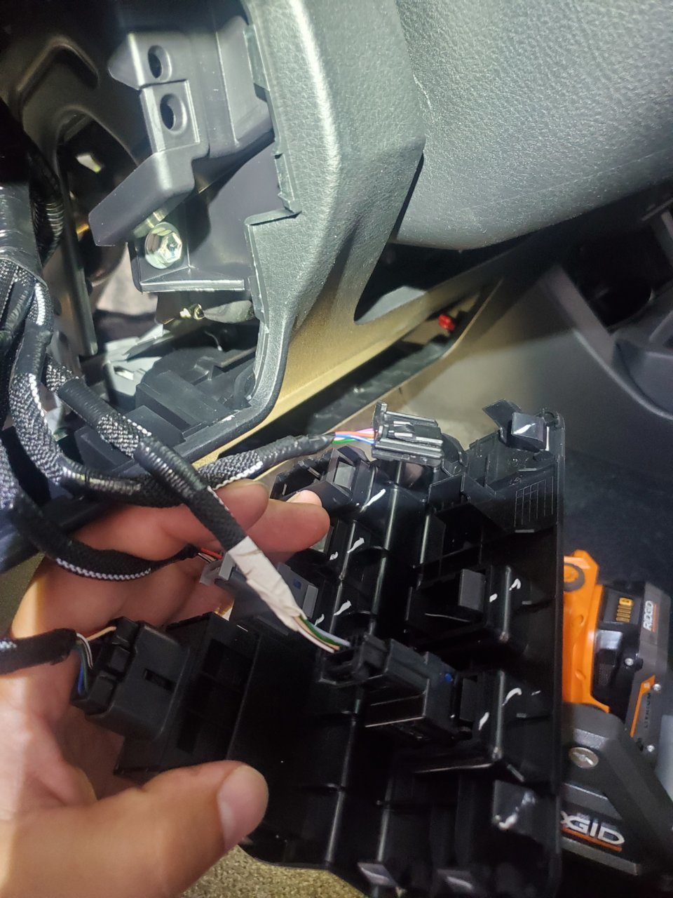

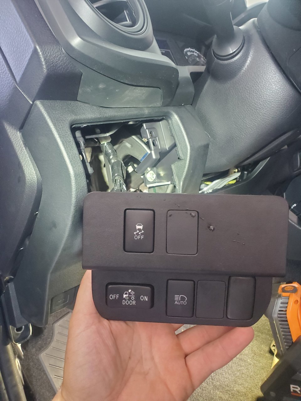

    Pulled dash switch panel to install brake controller. Can seem to find where this plugs into...

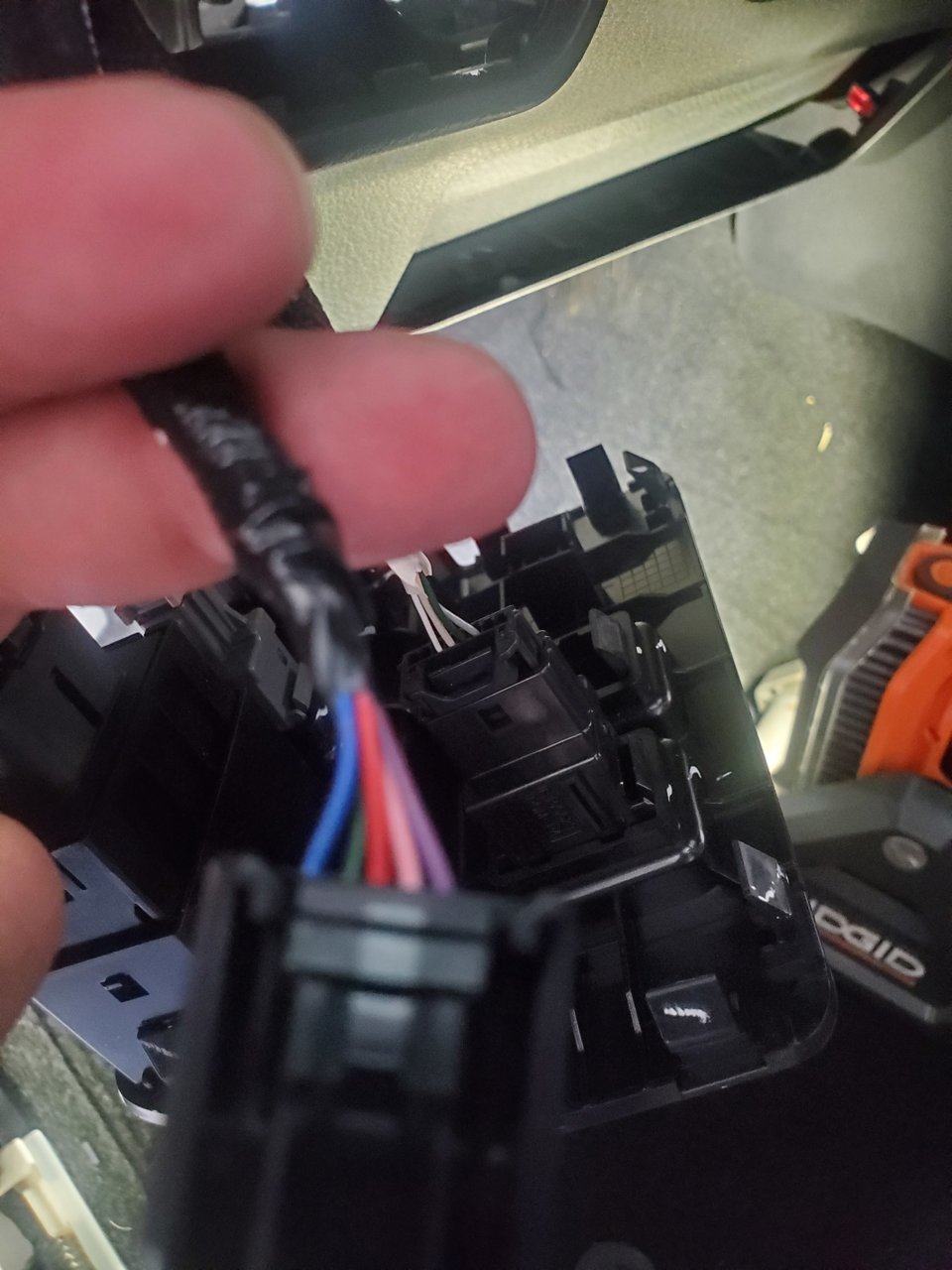

    This plug. Blue green red pink purple wires.

    Thats the brake controller plug that comes with the tacoma, it plugs into your brake controller. If you don't use it there is a false plug on on the back of the switch housing it can go in.

    Yes it has it. The v6s have it installed from the factory. My white plug is behind the driver's kick panel. Thanks for the responses.

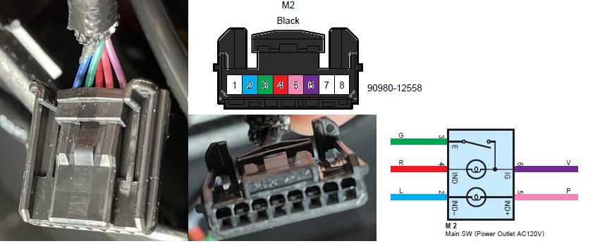

    The connector is for the inverter switch your SR does NOT have.
    If you add switches, you have 2 wires there that provide fused IGN source. Slot's 5 & 6.
