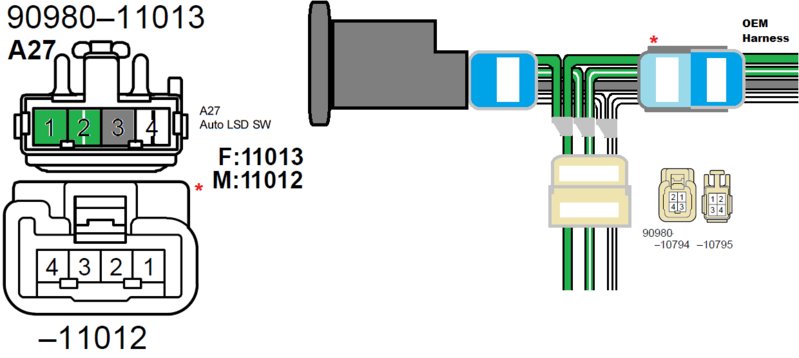

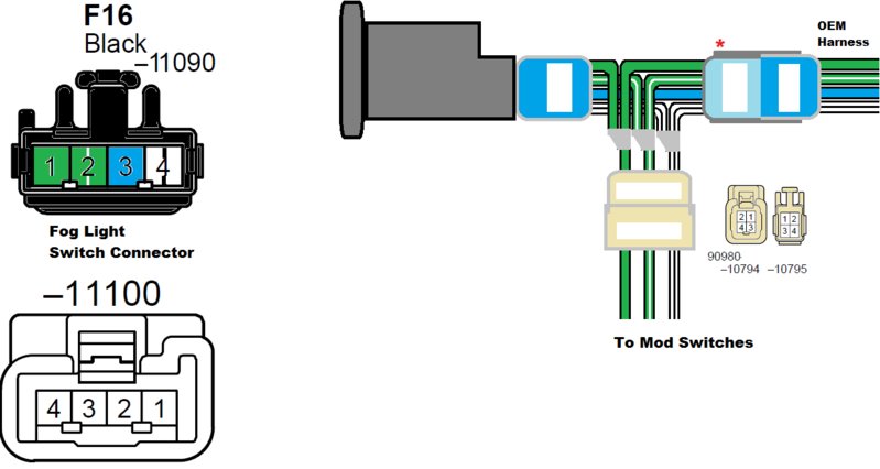

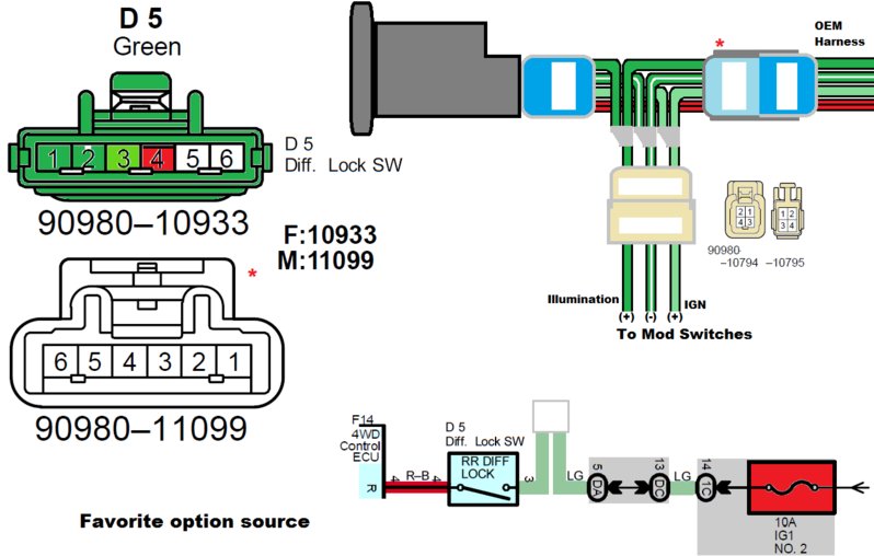

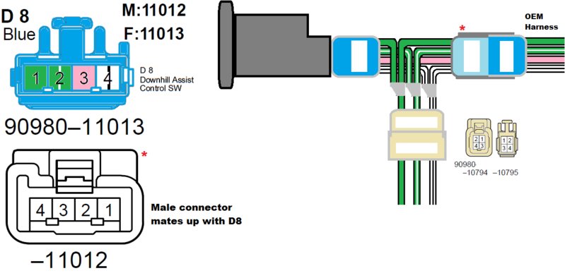

    This be another unnecessary, overbuild T harness to tap the illumination circuit and ground from the dash switches.
