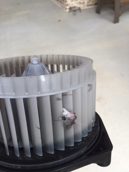

  4. Nov 11, 2018 at 10:19 AM
    Muddinfun
    Muddinfun Well-Known Member
    Apr 17, 2017
    #216500
    7,489
  5. Nov 11, 2018 at 10:27 AM
    jamcross
    jamcross Member
    Aug 4, 2018
    #261693
    14
    J
    2010 Black Tacoma TRD 6" bed
    bahaaa! that might do it
