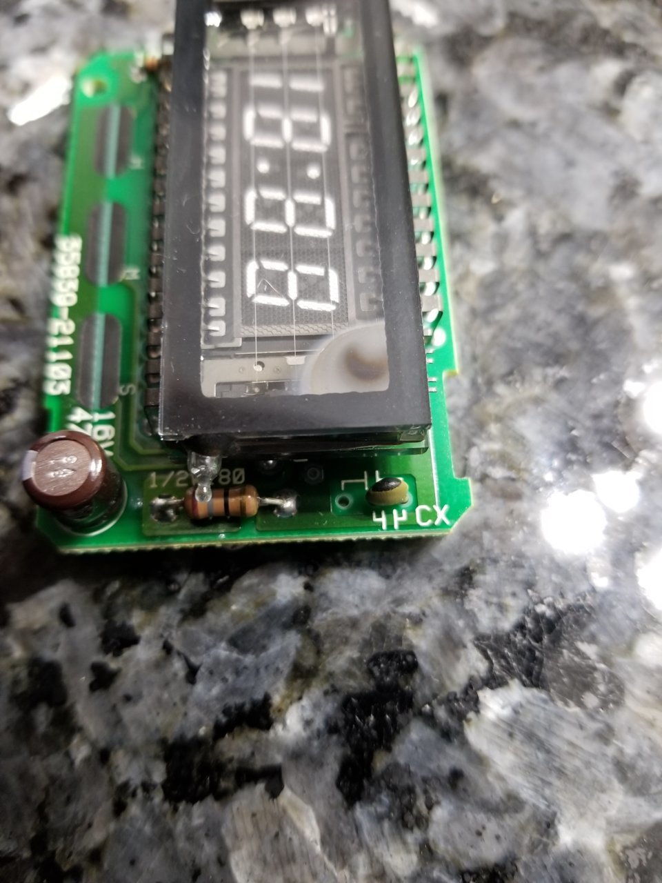

    So reading other post on reviving my dashboard clock, i tried resoldering c9nnections for better contact with no luck until I realize there is a burn mark on screen of clock. Read it's a due to a burn fused. Haven't seen if this is repairable, but now thinking putting a single digital gauge with multi function meter. Dont know how to house it and trim cover for it.

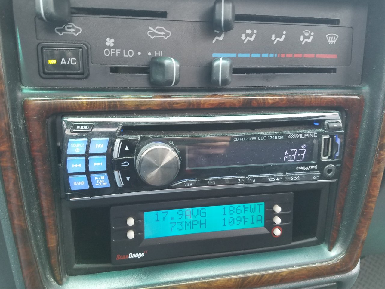

    You can have both too :)
    Clock reads time all the time
    When my radio is on clock goes away because the channel comes on

    Woe what's that unit under radio? I want that!

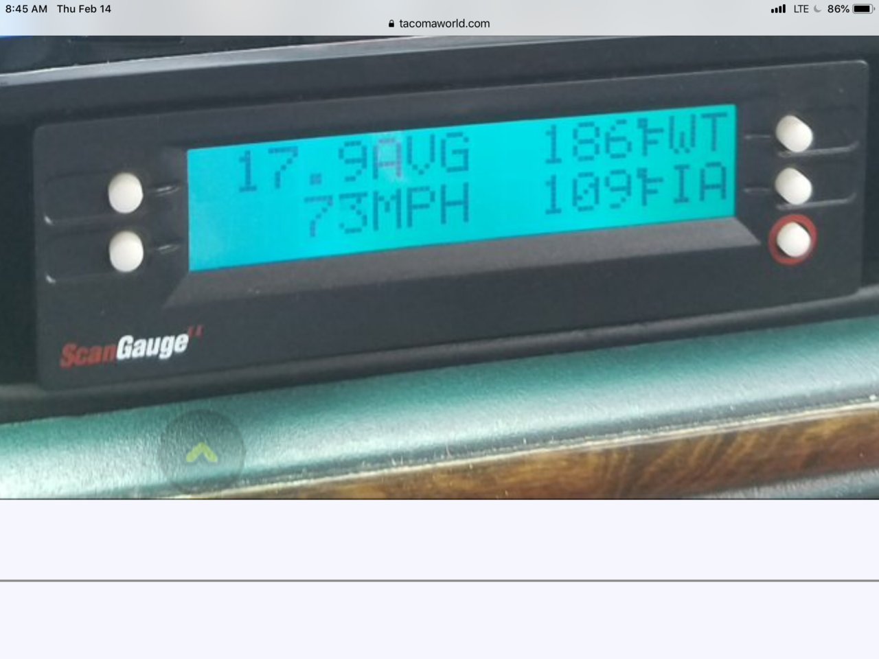

    Scangauge II, takes 5 minutes to install cost around 150.00.
    Plugs into the OBD

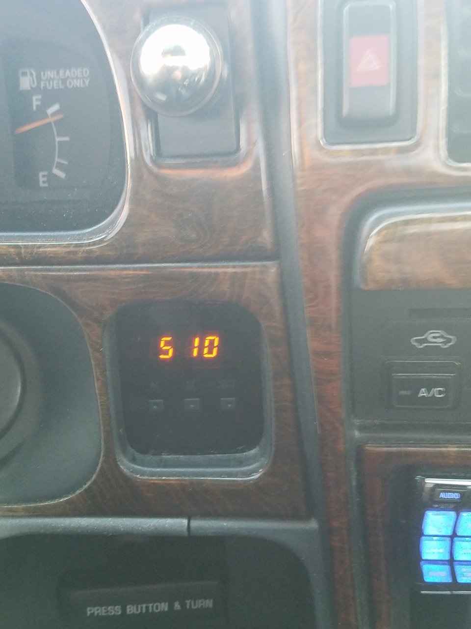

    Update*
    Dad found 2 wires that were cut. That seem to give me power for radio, cig lighter and clock. It's alive!!! I'll update on Saturday as dad will show me then.
    Man clock was a shocker seeing how it showed screen had a burnt.

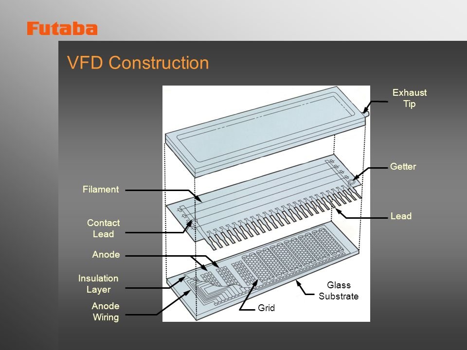

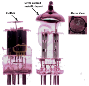

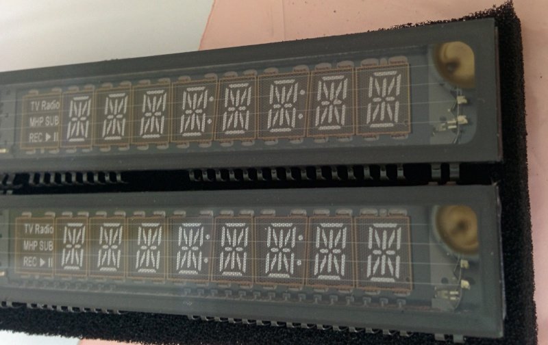

    That burn mark is an integral part of a Vacuum Fluorescent Display, it is not a defect.
    https://en.wikipedia.org/wiki/Getter

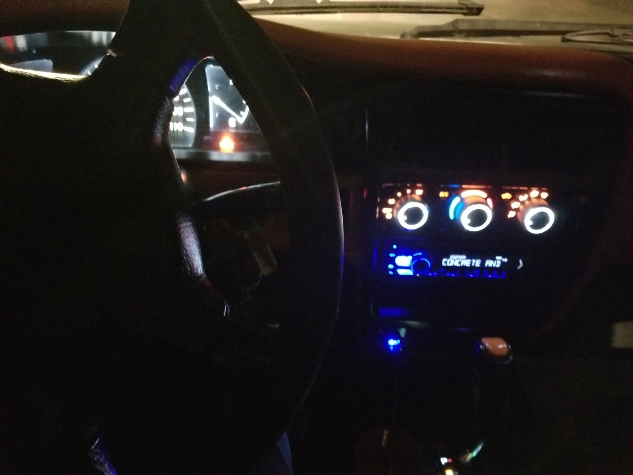

    Crap...ill look into this further, but for now this is how it all looks lit. Glad i picked orange for dash. Girs with climate controls and chrck engine light (ignore that)
