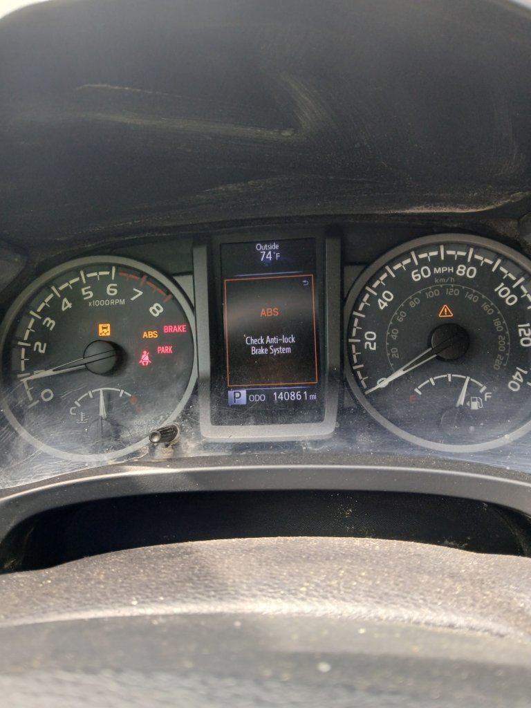

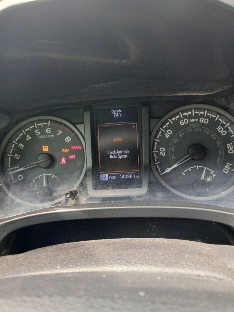

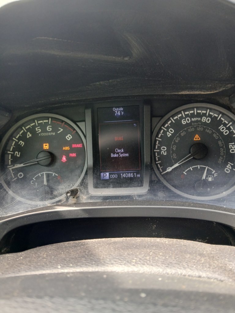

    Been going through some bumpy gravel road and this all these lights comes on but the truck run just fine, it comes on sometimes and it disappeared. And it will not let me put on 4x4 if all the lights comes on, I don't know what the problem is.

    Check codes in everthang and report back..

    Possible issue with one of your speed/abs sensors. The front 2 are in a somewhat vulnerable spot. Def pull the codes though and see what its got.

    If you can't get the codes; Get under and take a look at the sensors and wires. With your milage and years of use rust in the mounting holes is a real possibility. Water could travel either through the hub/bearings or around the sensor mount.

    Loose ground connection on the battery?

    abs warnings is going to be a wheel speed sensor. just a matter of which one.
    i find it funny that 4wd, which locks all 4 wheels together, is prevented from working though.

    Check the wires too
