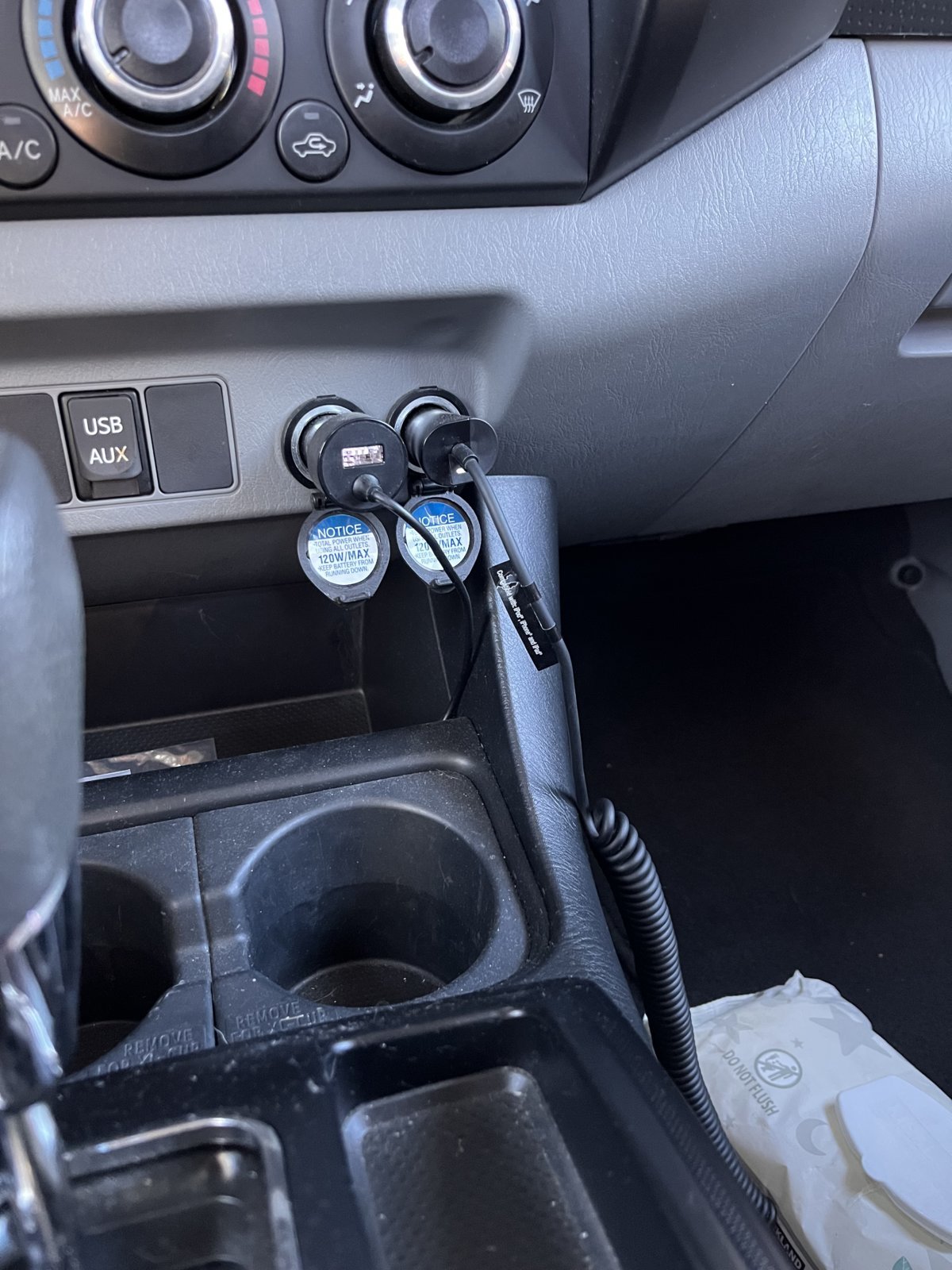

    I have a cheap Apeman dash cam (forward facing only). It was like $45 if i remember and works great. I've tested the video via the MicroSD on my computer and it looks great, high resolution. No sound. I have it plugged into a cigarette lighter but have the wiring all hidden so all you see is one wire coming up out of the center console (by the cupholders) and into the plug. Would recommend for a basic one.

    No panels needed to be removed. I mounted the dashcam, and then ran the wiring along the headliner and front windshield plastic piece just by pushing the wire in with a plastic tool, same down the A-pillar side, just pushing it in between with a tool. Then ran it up under the glove box out of the way with some zip ties and to the center console. Coming up through the cup holders was easy just remove the cupholders and a big hole opens up where you can just run the final wiring up to the cigarette lighter. Put the cupholders back and bam, all good. I drove my 4runner to work today but i can take a pic of how it looks in my Tacoma later today.

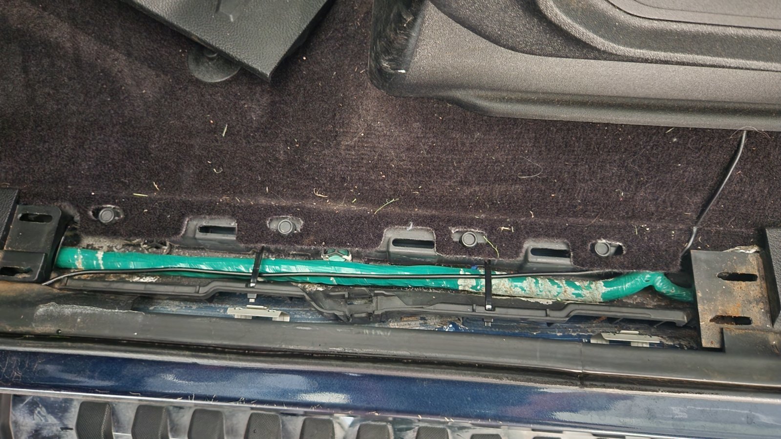

    For the install on my truck and my buddies (which I helped him with and is the same model of vehicle and camera) I ran the power wire along the headliner to the A pillar where I tucked it behind the trim along the top, into the weather strip down to the door sill, ran it under the sill, had it run under the seat and into the center console. Only trim piece that was removed was the door sill plate and that just comes up by pulling on it. I insulated the floor on my old 2nd gen while I still had it and it's much easier to remove than the F150s trim pieces...

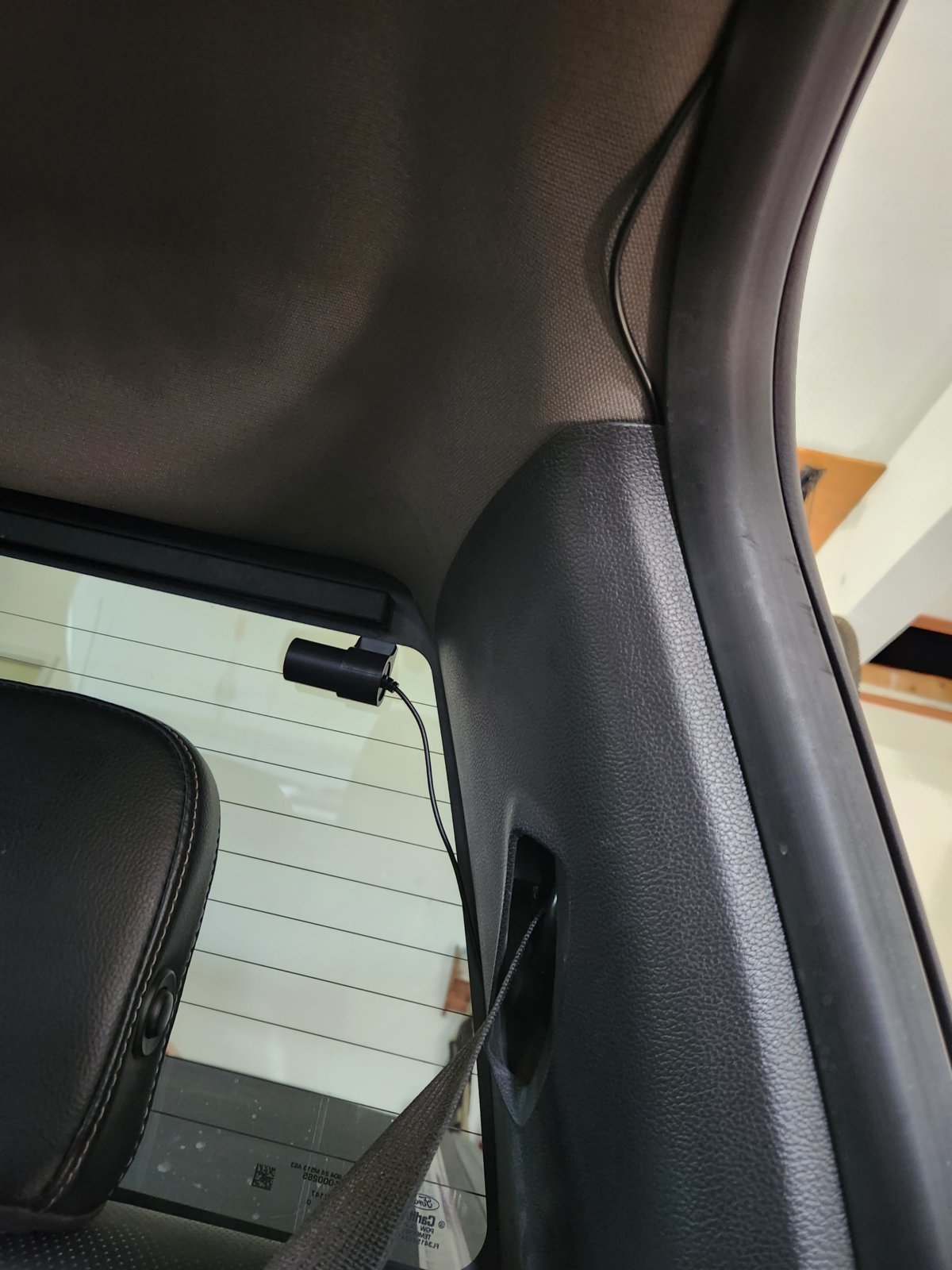

    For the rear camera I ran it along the headliner like the power wire but ran it in the weather seal to the B pillar then under the rear door weather stripping to the C pillar trim. I looped the extra and tied it up with the twistie that comes in the kit. Tucked it behind the C pillar and stuck the camera on...

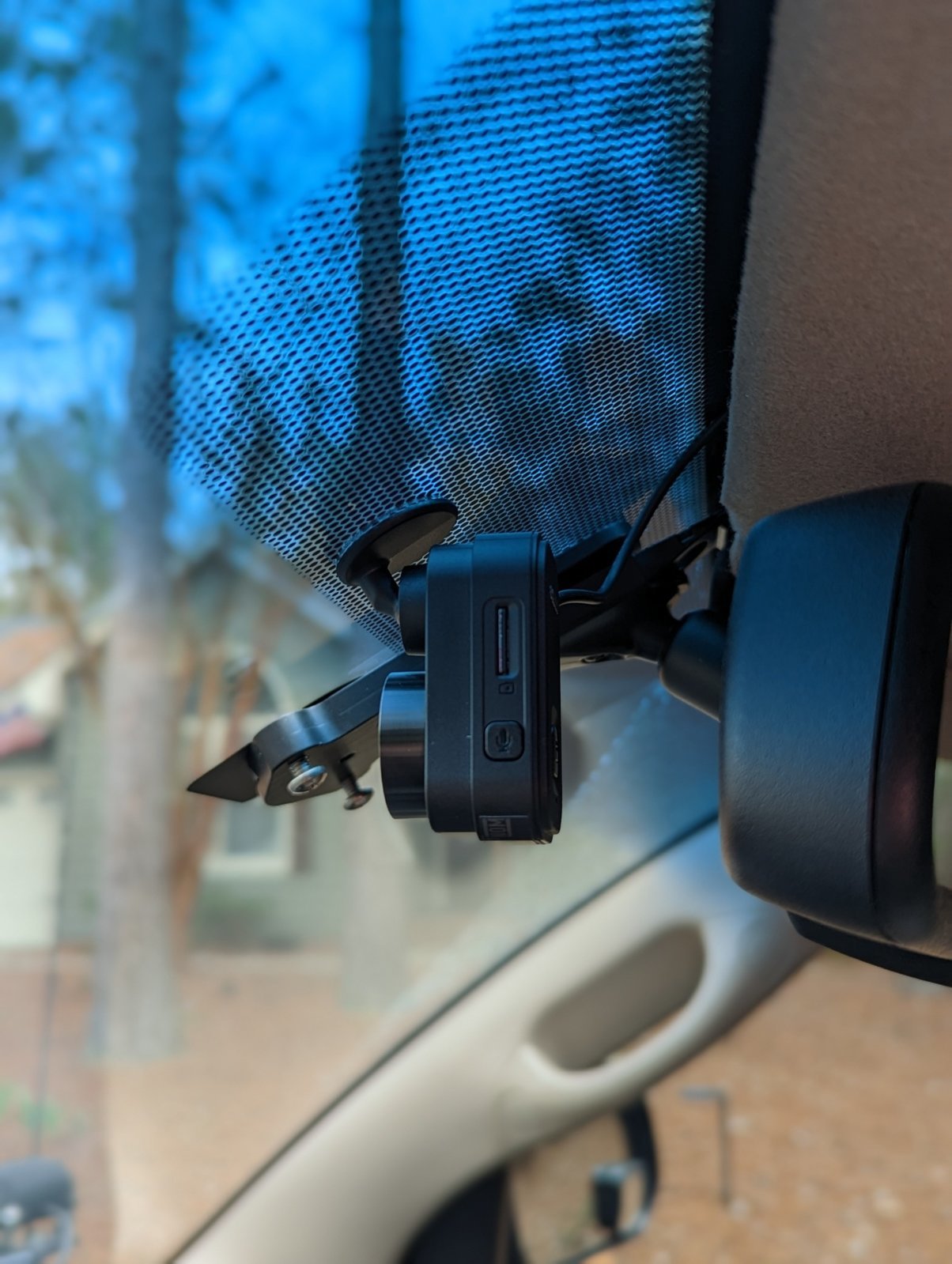

    Garmin Mini 2

    I have the Garmin, started with the original Mini, and just added the Dash Cam 47, moving the Mini to the back of the shell for rearward facing video. Since I have a base model, I didn’t have the fancy power in the mirror, so I used the Garmin harness for both cameras, which also gives me monitoring when parked.

    This is the only cable you see from my installation:
    The left plug (right one is a phone charger cable). Just tucks up under the cupholder, everything else is hidden.
