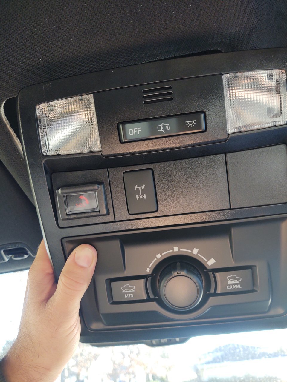

    I have ordered a dash cam off of ebay. I am mulling wiring it to a wire up in the roof for the overhead console/cabin lights. I did this when I had a 2010 Tacoma and it worked quite well.
    My questions are:
    To pull out the overhead console do I pull on the back side edges and then it sort of hinges off in the front? Or do I pull on the front side edges and then it sort of hinges off in the back?

    There is a wire up there. Mine is wired to something up there that’s on 24/7 I can’t remember the color though. I can check later this week though. Have to pull that console thing off for something else.

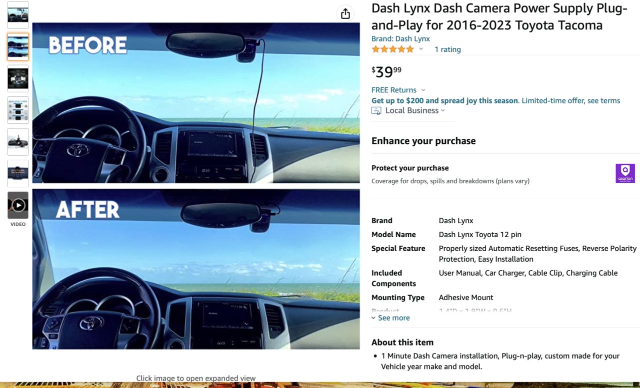

    This is the one I used on, I like it because it has two USB I mount my phone up on the windshield during my longer road trips where nav is more important.
    Dash Lynx Dash Camera Power Supply Plug-and-Play for 2016-2023 Toyota Tacoma
    https://www.amazon.com/dp/B0BK5FRCNV
    I also bought one of these for my CRV since it does not have a power mirror to tap off of, however I was very disappointed with the fuse quality. Highly recommend using a real OEM fuse, take one out of your spares, the lower the better, 10 amps through that wire will cause a fire, you only need like 2 amps max for Dash cam. There was another brand I bought that had fake fuses in it, the fuse looked like a fuse, smelled like a fuse, but I went to test it and it would not blow even at 20 amps, upon closer inspection it was actually used as a jumper/bus bar not a fuse, but it was inside of a standard fuse. Can't sue china...https://www.amazon.com/dp/B07FXJD8W1

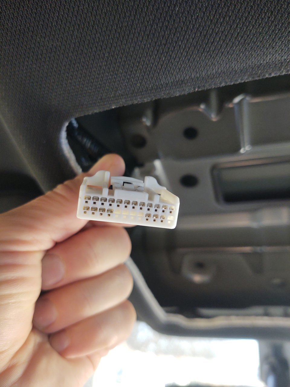

    I'm trying to find the wires now. Any wizards out there know which ones to use for constant power?

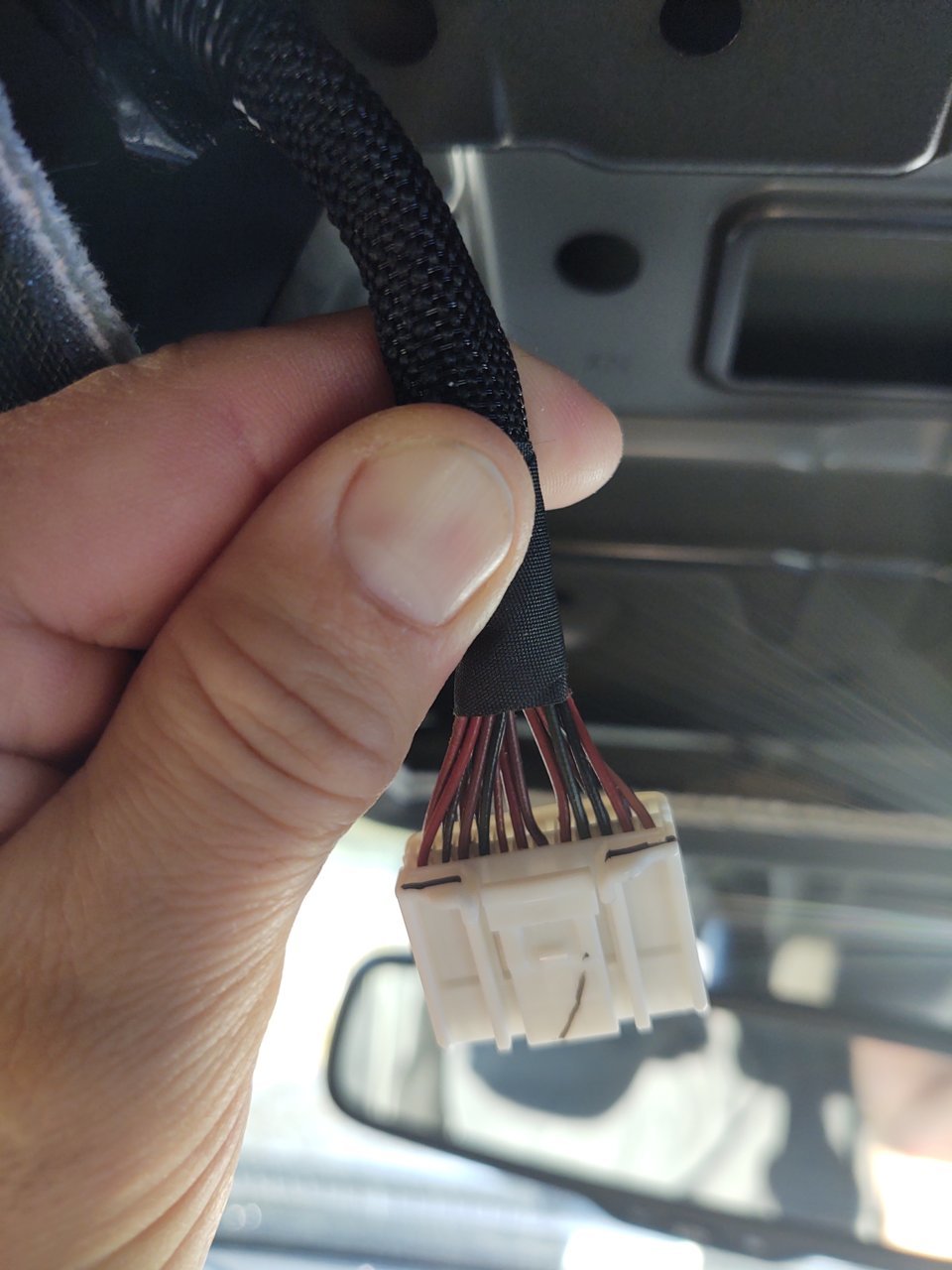

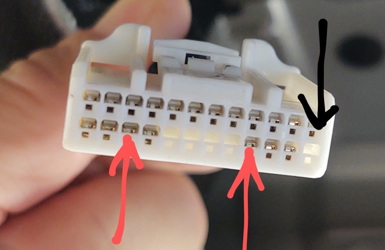

    This is what I got so far. Assuming the wire with the black stripe being the ground I got got constant 12v on the two pins in red with the vehicle off. All the wires are different shades of brown so identifying them by color seems futile.

    I usually put my ground alligator on the cig lighter outlet, side of the barrel, and probe for hot. Then put the meter on ohm setting and try to ohm out a black or brown wire for <1 ohm to ground. However the best way is to look for a schematic. also try to figure out the power budget, I wouldn't pull more than 1-2 amps from the wires unless you are sure what else they go to. The newer tacos do some weird stuff like run the vanity and RVM off of an ECU branch, so if you short it out you wont need to put up Xmas lights this year cause they'll all be on your gauge cluster.
