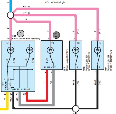

    2014 Tacoma spruce mica
    These are from a 2019 but should be the same.

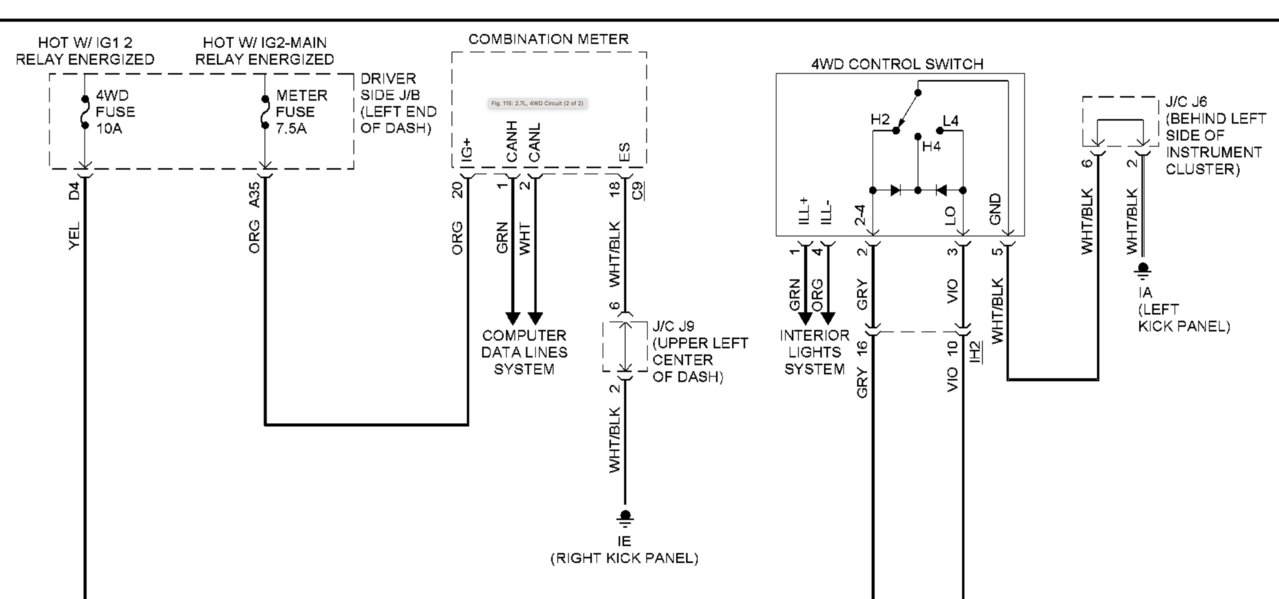

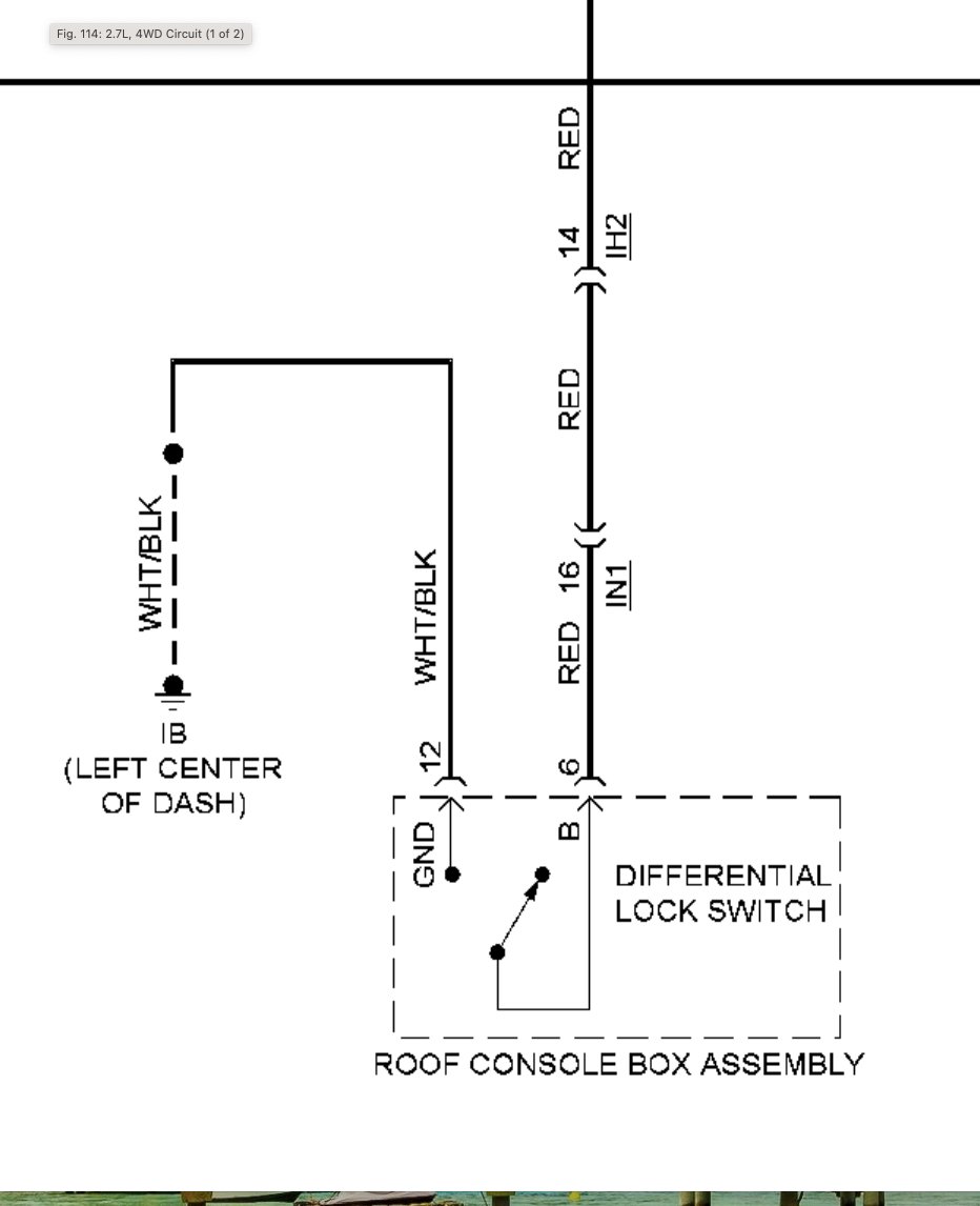

    Actually may be wrong on that, I'm not sure if the 21 is different from 19. I don't have the 21 wire diagrams on me at the moment.

    Ideally I'd like to find the constant power wires for the overhead lights. Those have to work

    Thats what I was thinking, I started snooping around on the overhead lights, but I think they may be going to the BCM on a timer. can you leave one of them on and see if it turns off? or if I can get to my other computer I can check a better schematic. Im using Mitchelle and I dont really like it. Im more of an all data fan for wiring diagrams.

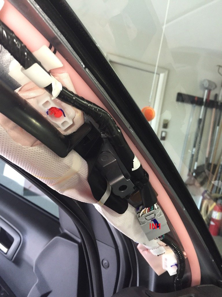

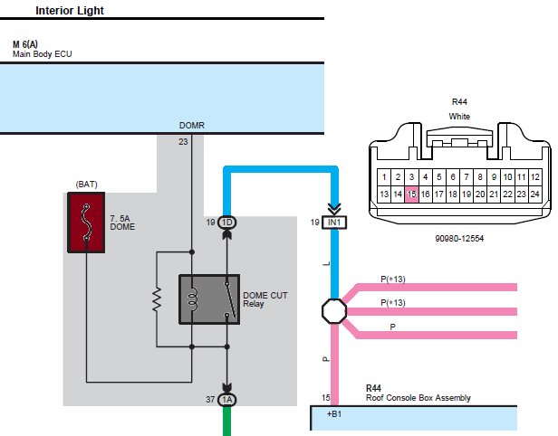

    If your taco doesn't have the sliding roof, lower the fuse from 20A to 5A or less. Add the missing wire and terminal to the overhead from IN1 behind the sail panel.
    P.S. Always hot (battery) circuit, not IGN.

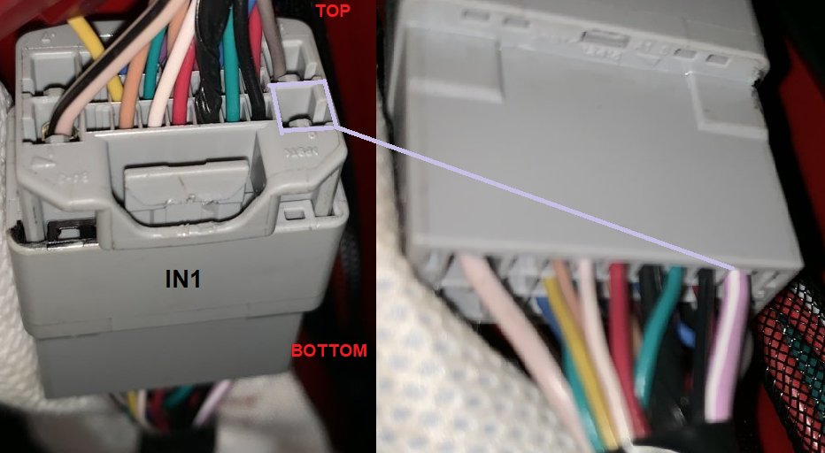

    What wire (+) position did you use?

    3rd pin second row.

    Circuit turns OFF after 20 min of engine off.

    Door was open and you didn't disconnect the ground cable to battery negative.
    Leaving the Overhead Illumination switch ON provides power to #21. Flows from same source.

    No wire always on.
    If you were to use #21 and turned off the overhead illumination, you'd cut power to camera.
    Again, if you don't have a sliding roof, that circuit just requires a terminal and wire to the camera and a lower amp fuse. It's located on connector IN1 which resides behind the sail panel on driver's side.
