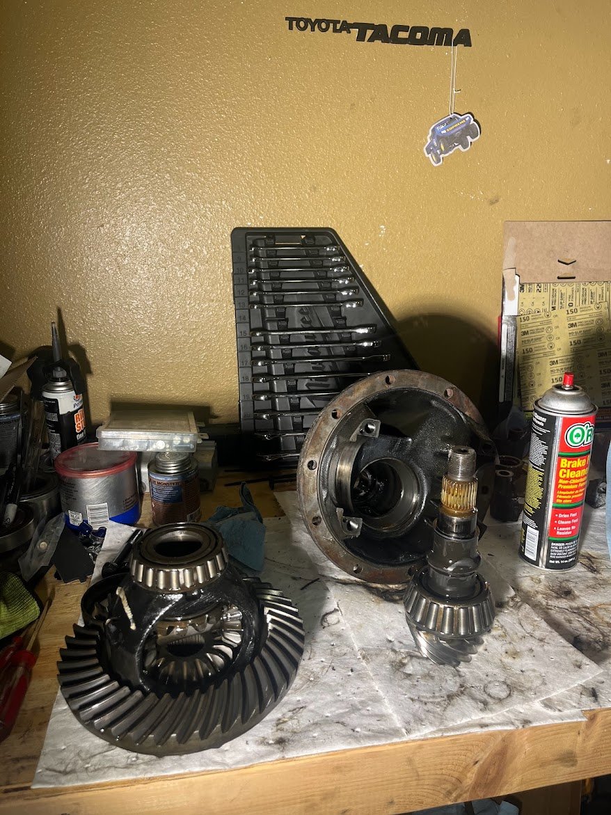

    Pulled my spare 3rd member apart yesterday to get ready to throw some 4.56 gears and a truetrac in since my 4.56 open decided to start spewing oil from the pinion after i changed the pinion seal :bananadead::bananadead::bananadead:
    Ordered an install kit last night from East Coast Gear Supply, waiting on that to get here and then the fun begins

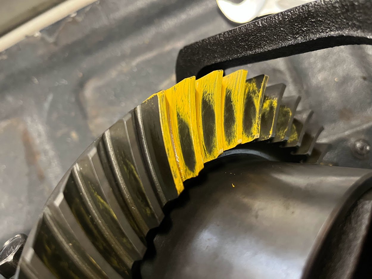

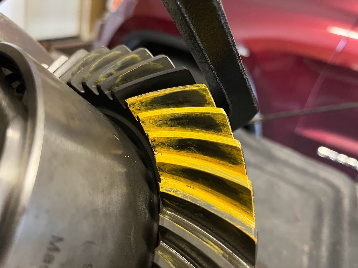

    Install went well, about 250 miles on it so far no issues
    ZdoWlVuqFPjNQsQ8DWweP6q4_gGbCef7Yw3hMJ5B_3379ca5fd0172e06e88d7e29d12d748c392eb327.jpg
    QGO1UBN8_gcLp2_bFp95USST23Y6hDzDOdb34WJE_43a2dd9f4243d4fe44cce6dd78b99aa3d9753851.jpg
    10in/lb preload on just the pinion
    18in/lb on the pinion and carrier
    Total preload is 20in/lb
    Backlash is 0.007 avg
    Bandido, Lfaub03 and ToyRyd04 like this.

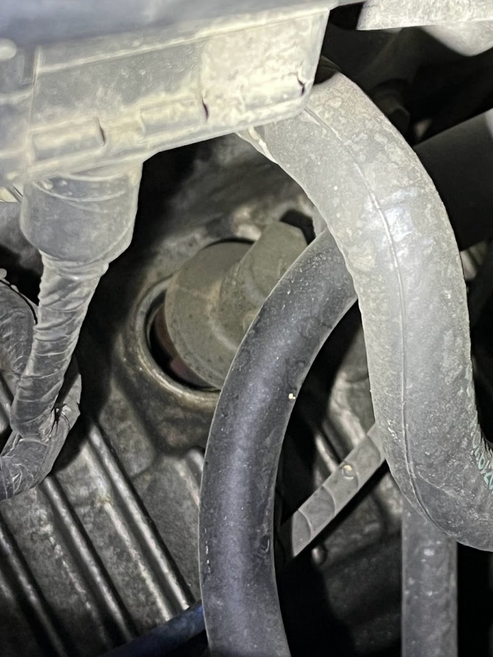

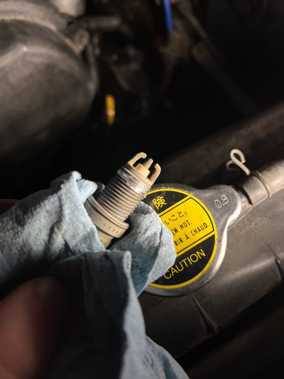

    And the tacoma decided it wanted to back a plug out and start misfiring
    iQatswVEfzx8ON-0S9xIF2UCM6gtg1ufl5tsfONL_c22f139bccb40fd237a17fa46f9ca68c9d5c68dd.jpg
    mvuKKGWpZNUr_FHngNpA6yZyjuitDJPPFn4wukYi_0eabbf991c529dbe8631c5fa86055ac6cc456602.jpg

    What happened to the plug? Just backed out or are we gonna be breaking out the helicoil?

    It just backed out and galled the threads a little. I think I just need to chase it with a tap and put a new plug in.
