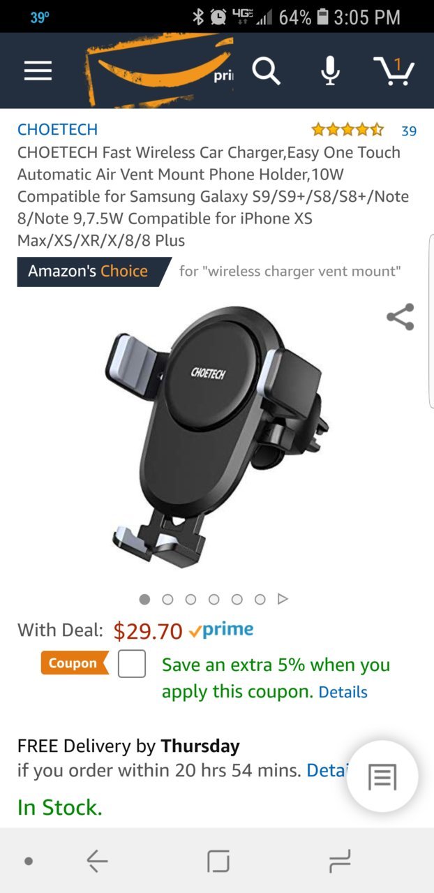

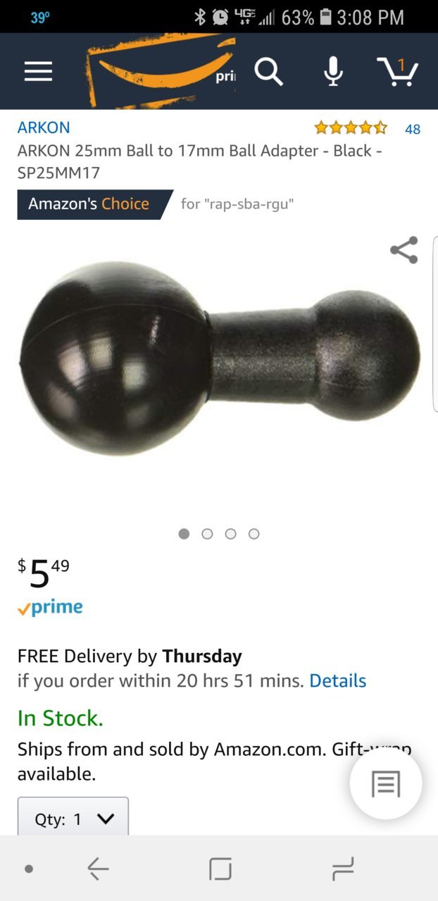

    So I can’t mount my charger to the RAM mount yet. The size of the ball is different.
    Here’s the charger: https://www.amazon.com/dp/B07HQDHV49/ref=cm_sw_r_cp_api_i_jrUgCbGAGZXTR
    The charger I bought uses a 17mm ball. Whereas the RAM mount I got with the DMM is 1”.
    So I ordered this adapter:
    https://www.amazon.com/dp/B01MZXRSST/ref=cm_sw_r_cp_api_i_ioUgCb7A2YWQ0
    It hasn’t arrived yet, but it all should work. Just haven’t tested it yet. I’ll update on Friday.

    I bought the same adapter a few weeks ago. Works great!

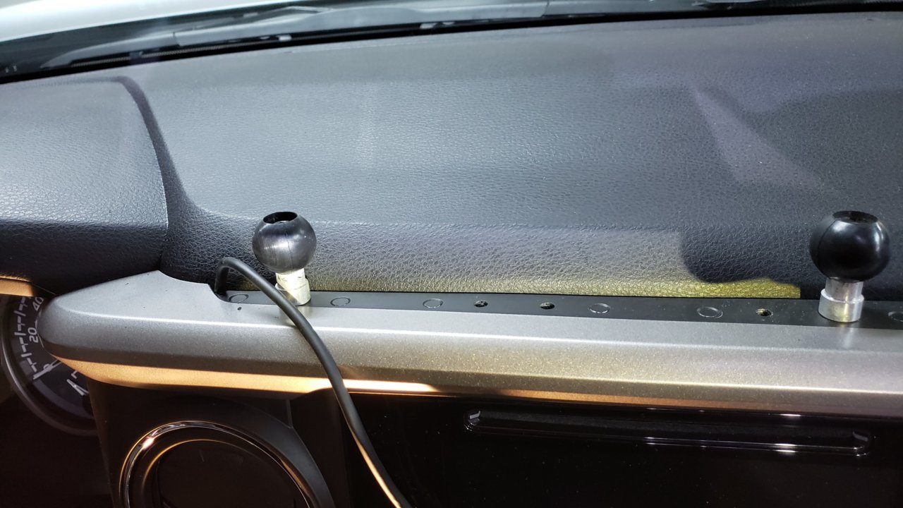

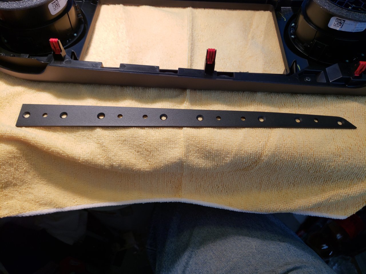

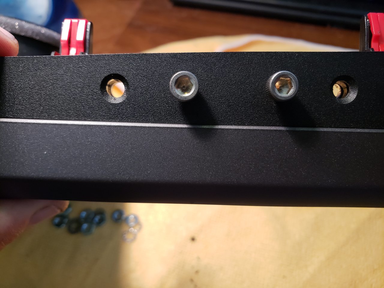

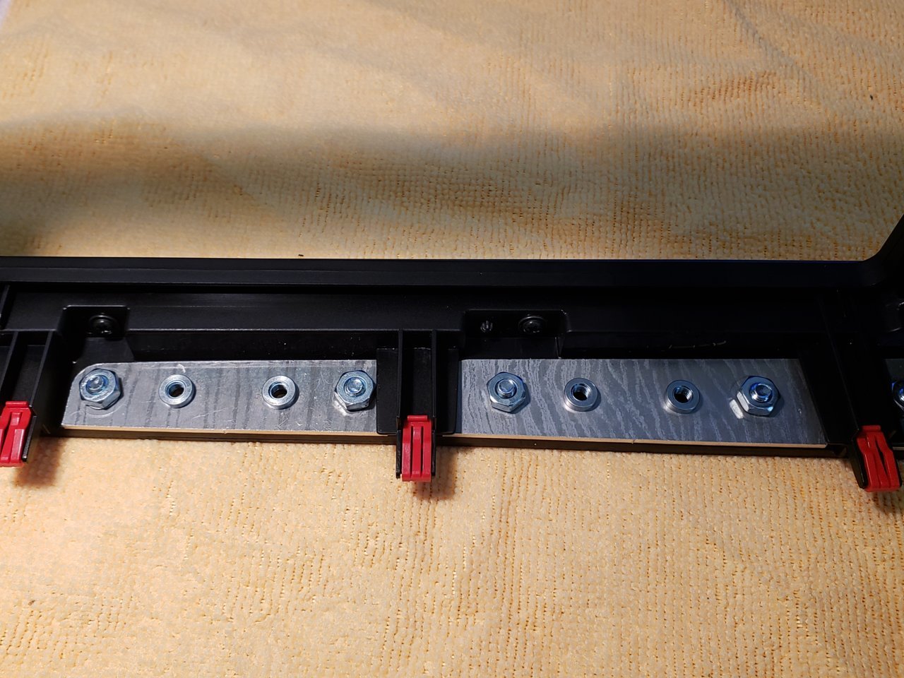

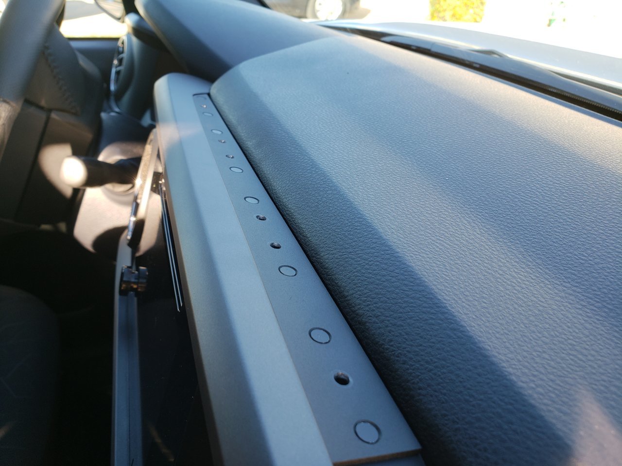

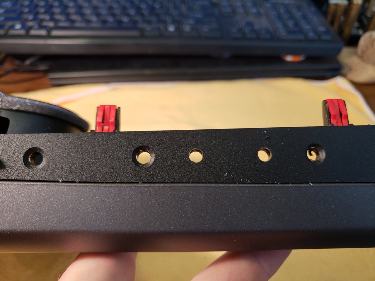

    Arrived today, Super easy install. although I did not tighten down the locating screws 100% on the first two plates, and it did make a slight difference when checking the alignment with the ram ball screw, I had to use the allen wrench to thread all the way in the first time, the rest where tighten all the way and I noticed that ram ball screw screwed all the way in by hand the first time.
    The top mounting plate, has a nice finish, and fits the space perfectly.
    I used several binder clips as clamps, this worked well, but did require me to move around a bit to get room to drill the ball mount holes.
    drill slow and let the bit do the work so you do not blow out the edges on the back of the trim
    like I mention above, tighten the locating screw up all the way, it did seem to make a difference for me
    Nice flush top surface...
    No trimming of the tabs was needed, But I can see where you may need to depending on your tools and skill
    Nice clean install. Although I may go back and tape off the holes I do not plan on using right away to keep the dust out. I drilled all the holes as I like having options, and when I needed a location on the mount I may not have access to a drill and #10 bit.
    The shiny aluminum spacer was sprayed with a coat of gloss black to help it disappear in to the background once in place

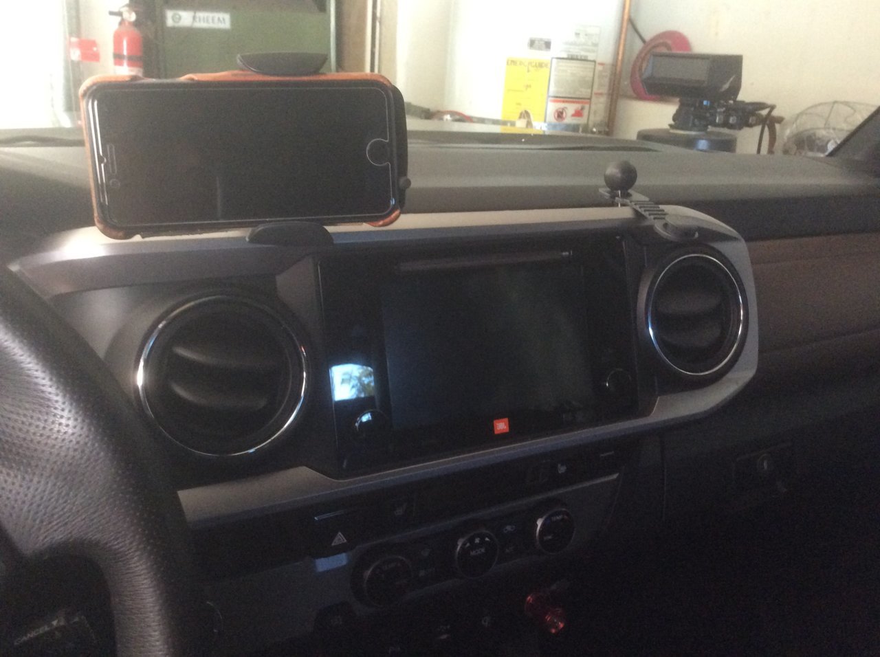

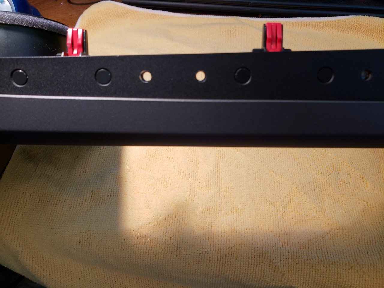

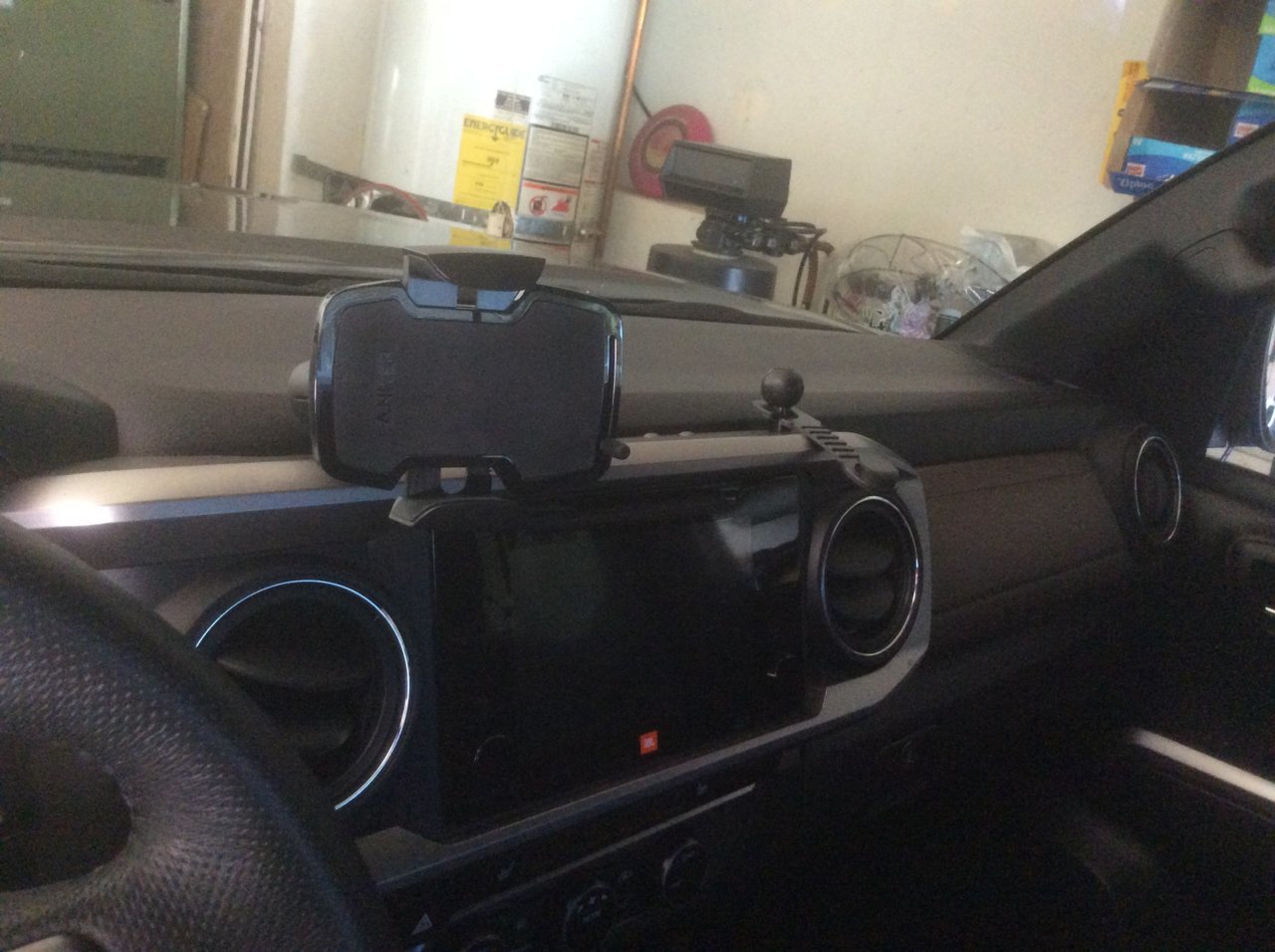

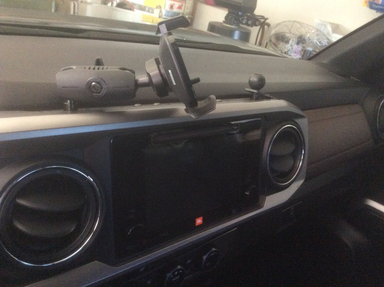

    F494F240-4BAF-4B46-B148-BEEB87767389.jpg 87A5C9FD-80C9-4676-B984-F8CEE0646945.jpg Easy installation of Taco Garage dashtop multi mount with Anker phone holder. Drilled all holes and plugged open holes with 10-32 x 1/2 button head cap screws. I really like the look and mount positions. Even put wife’s cell phone ring holder for her...F35D5002-B53E-4459-88C7-11E86407CC9F.jpg

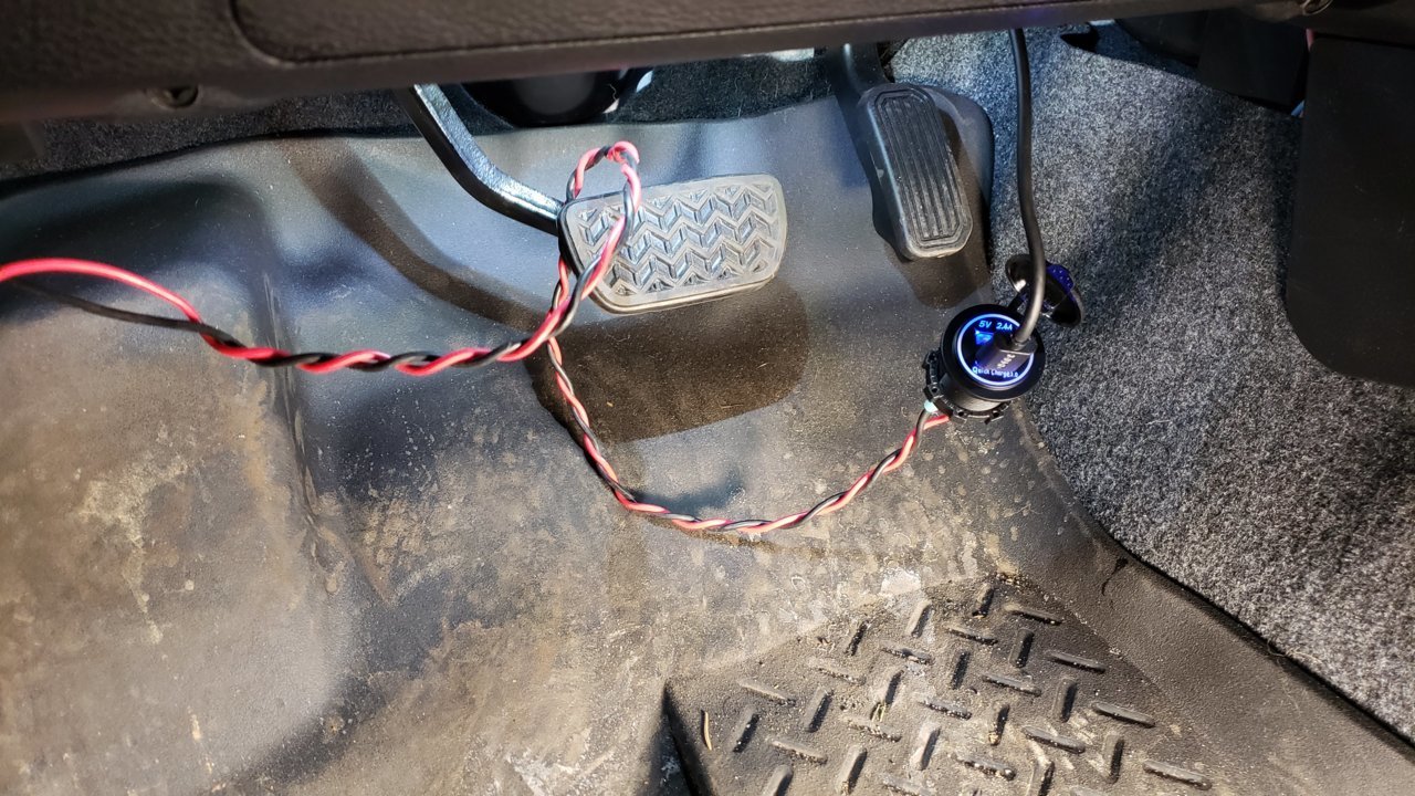

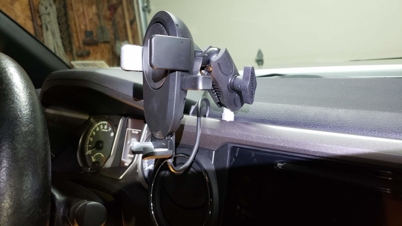

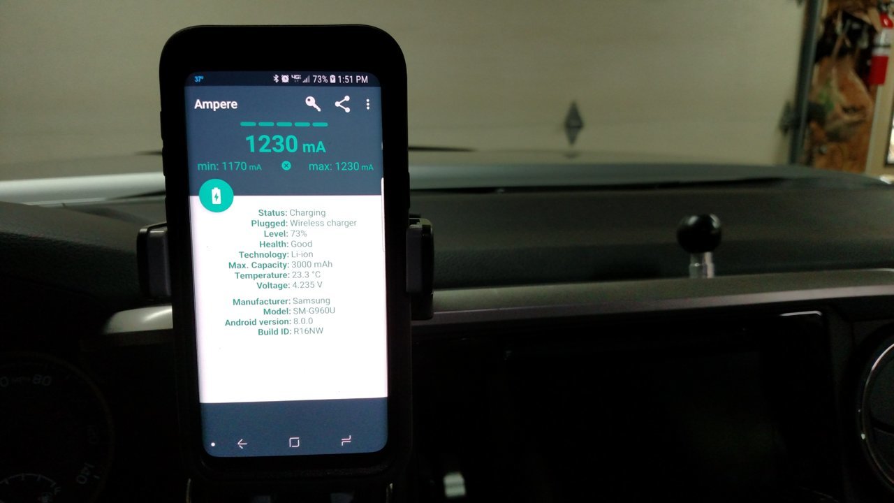

    I have had the DMM for awhile now with reg. phone holder, works Great. Got my Choetech fast charger mount and adapter ball today20181231_134048.jpg 20181231_134341.jpg 20181231_134432.jpg 20181231_132832.jpg IMG_20181231_135114112.jpg

    What model number holder is it?

    It accepts the ram ball with no problem?
    The reason I ask is because I see a vent clip.

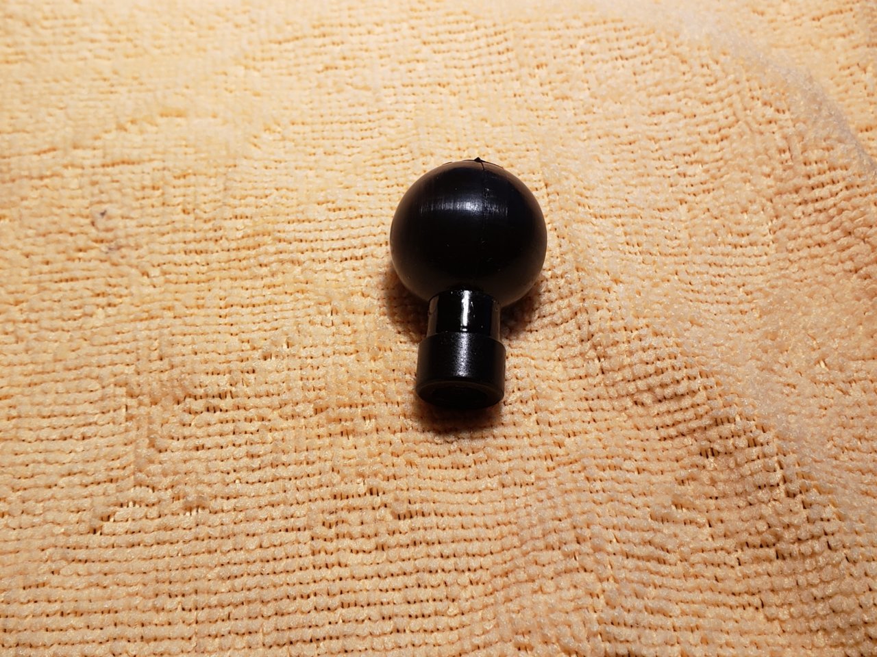

    I just posted the ball adapter to 17 mm to 25mm
