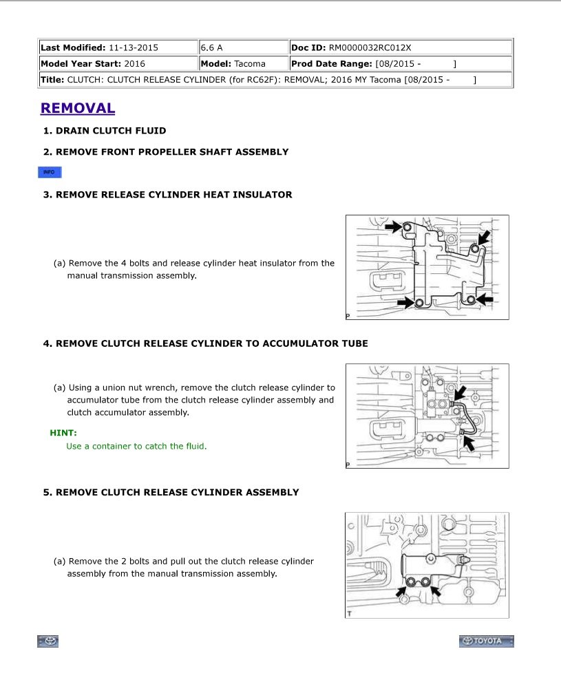

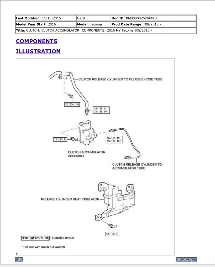

    I'm not sure if I should be posting this, but I had my head buried in the service manual this morning and found these:

    Just saw that they left the pilot bearing in the 5 speed (R156F) but removed it the 6 speed (RC62F)... There you go 4cyl guys, if it works, don't fuck with it!

    Awesome, I found that page last night as well. Thank you!
    What is confusing, is when I crawled under the truck, you can't see anything resembling a clutch slave cylinder. I was afraid it was INSIDE somewhere.. nope just under a little plate.
