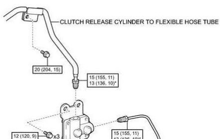

    I found this vid:
    It looks like the upper line on the 2005 is a hard line, but the simplicity of tweaking a bit is cool.
    The service manual says that the upper line is flexible. I am going to look tonight or tomorrow. I'm wondering if the support bracket for that flex line could be flipped?

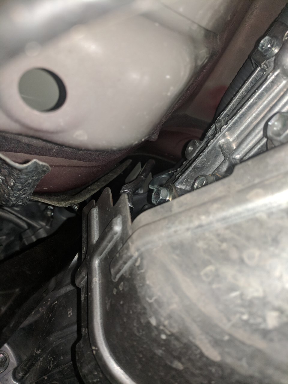

    It does looks like it is a flex line on the top side:
    The clip cannot be flipped. It is more of a channel that the line rides in.
    The area is kind of tight due to the second cat and the bracket that supports it. I will try to get sizes when the area is cool.
    @St.Germain . I was talking with a friend. He has a SnapOn double flaring tool that he used to reline his Bronco. I will dig around to see if it will work on metric sizes.

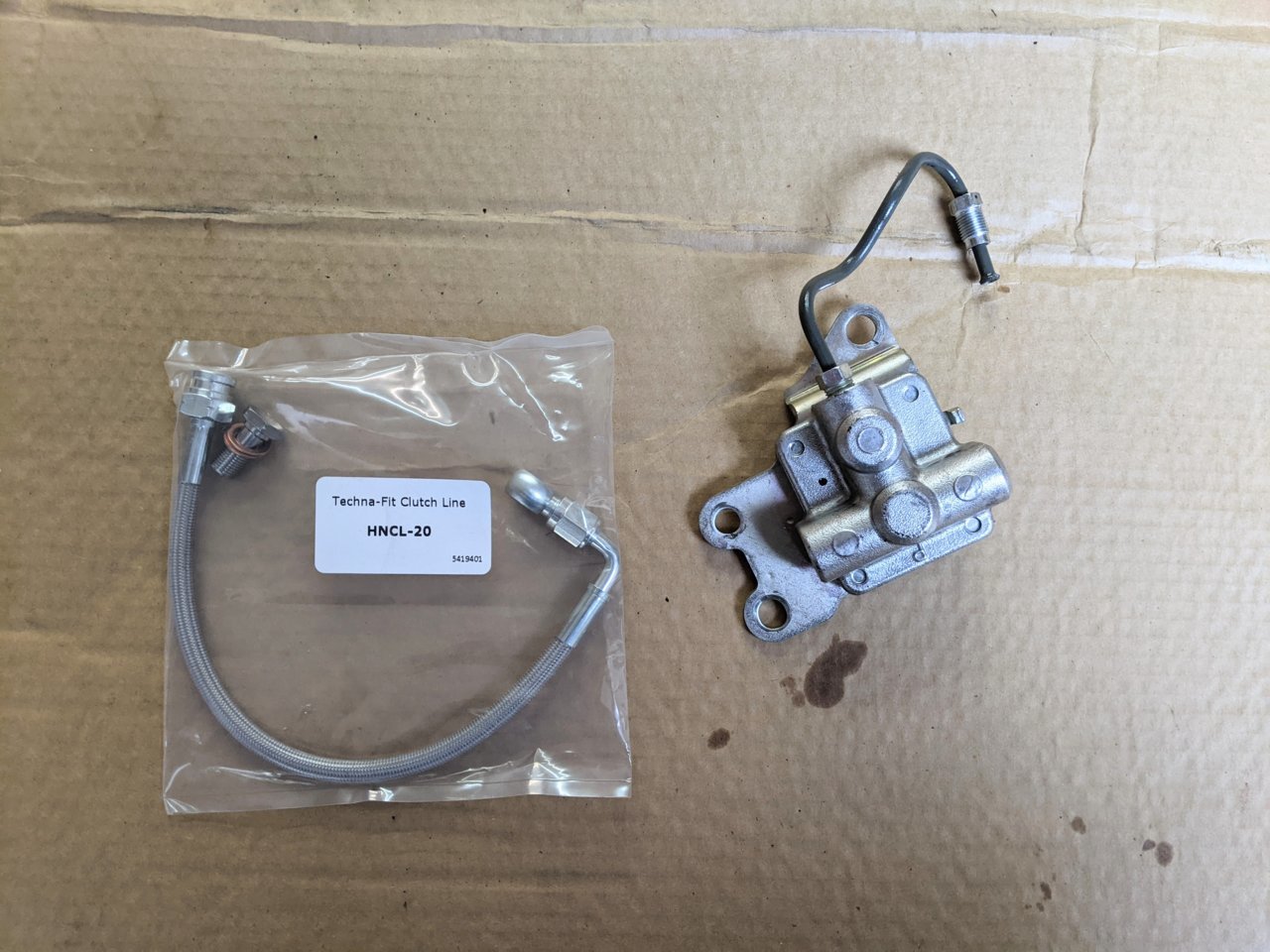

    Clutch delay valve delete

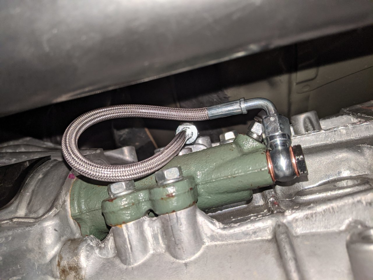

    I have done this on other vehicles and have not had any issues. The clutch and involved components are pretty simple... not much to go wrong. Guess if you had a warranty claim transmission related, you may want to put the delay valve back in.
    After the upgrade, clutch has a lot more feel and defined contact point. Much easier to accelerate quickly, shifting is smoother and faster!

    Nope, been 2 years and I’m not easy on my truck at times. One of my favourite mods.
