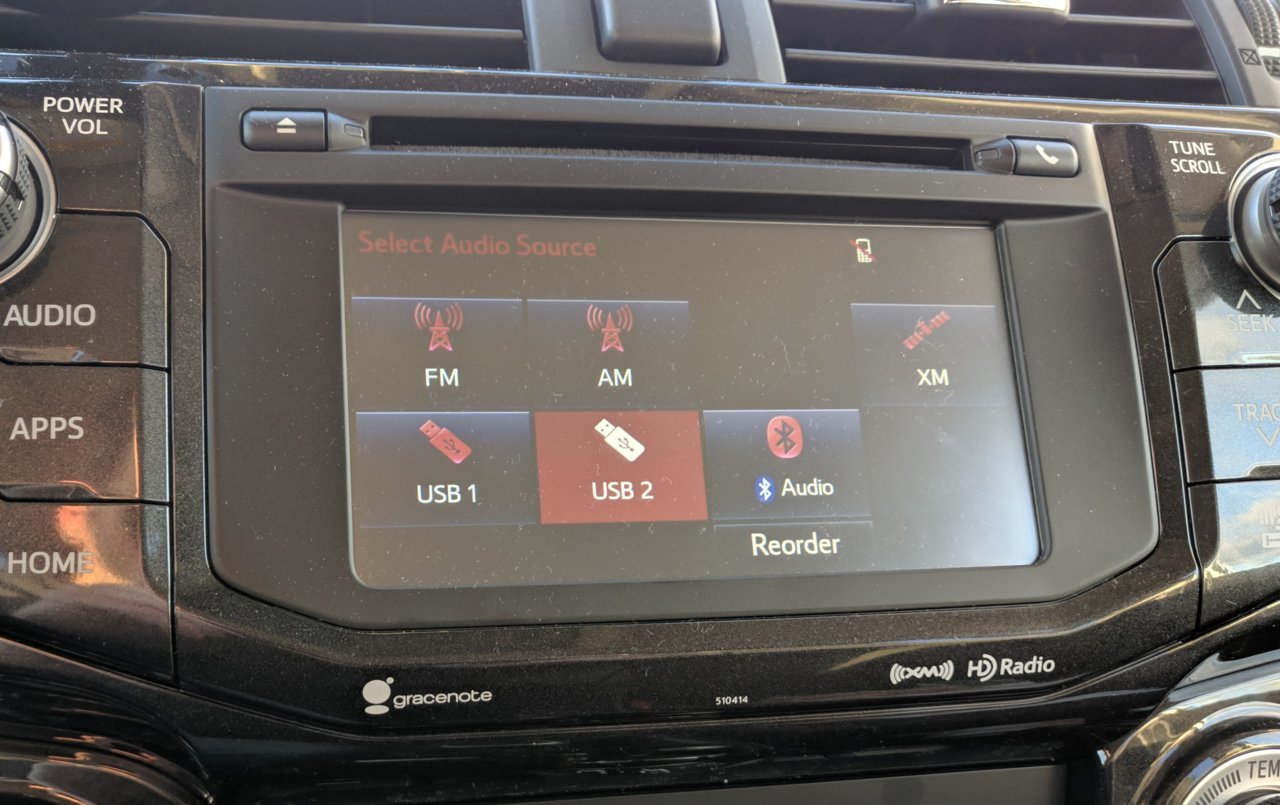

    The Entune units in the Tacoma must be different than the 4Runner. I was definitely able to use a usb hub with 2 usb drives. More than 2 doesn't work though.

    Just tried plugging in a four port unpowered, ancient USB hub into the regular data port. (2022 with 8" Radio + Nav, without JBL)
    Can see two USB sticks and play music from both.
    Plugging in iPhone (11 Pro Max) shows up as an iPod. CarPlay does not work, even if it's the only device on the hub.
