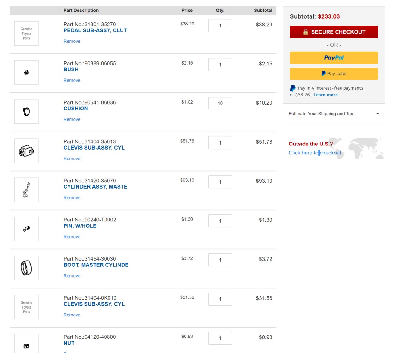

    Another question, thx for all your info. If I want to keep my stock master cylinder and just swap to the fj pedal, which of these parts do I only need? Also, the cushion part only comes in a 10 pack, but only need 2. Thanks again Dave

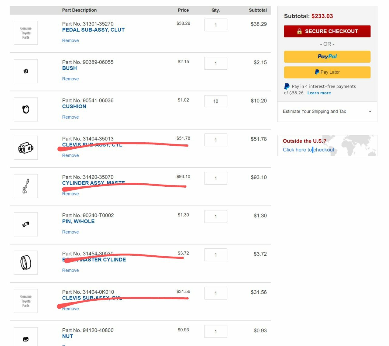

  13. Oct 18, 2020 at 10:57 AM
    #53
    su.b.rat
    su.b.rat [OP] broken truck
    Jul 30, 2016
    #193316
    9,869
    awesome that you are doing this, 3rd gen #2!
    i cannot be totally confident about the little parts since I've forgotten all the answers when i was researching, and i didn't install it myself. but I'm pretty sure you can skip the parts i marked out here. i know this is a nothing issue, but just to be clear your mc clevis will be plastic, which is neither here nor there for performance, but keeping your mc completely intact will save you almost half the price which is a huge win.
    like i wrote originally, when i did this the metal clevis was not available on its own, so that's why i bought another mc from the land cruiser, just to get the metal clevis. it looks like you can skip all of that more expensive stuff and [probably] just keep the clevis to pedal pin to connect the old to new. if i was you here, i would just get the cheap bushes etc to cover those needs even if you don't use them, all under $10 or so, right?
