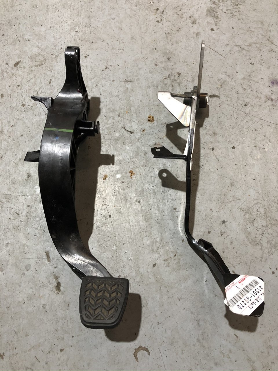

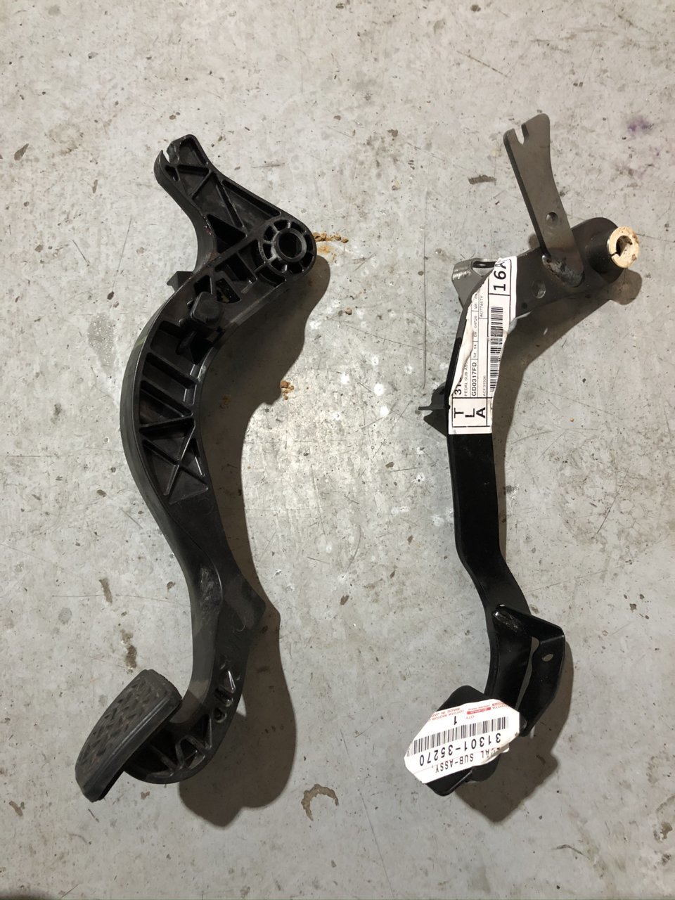

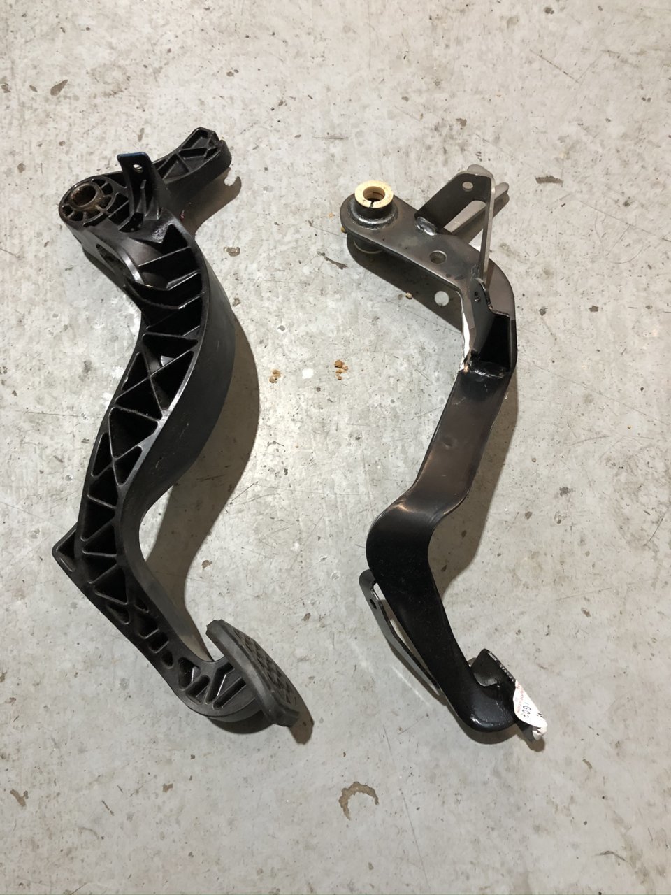

    Inspired from another thread (along with your post) and after several months I've finally bought the parts and will do the fj pedal along with dremeling the accumulator. :) Hopefully soon.
    31301-35270 Pedal Sub-Assembly Clut $36.52 1 $36.52
    90389-06055 Bush $2.35 1 $2.35
    90541-06036 Cushion $1.12 2 $2.24
    31420-35070 Master Cylinder $89.70 1 $89.70
    31454-30030 Boot Master Cylinde $4.06 1 $4.06
    31404-35013 Clevis Sub-Assembly Cylinder $49.55 1 $49.55
    90240-T0002 Pin W Hole $1.42 1 $1.42
    90386-08033 Bush $1.69 1 $1.69
    90206-08001 Washer Wave $1.12 1 $1.12
    90468-15006 Clip $1.12 1 $1.12
    Subtotal: $189.77
    Shipping: $19.99
    Tax: $13.88
    Total: $223.64

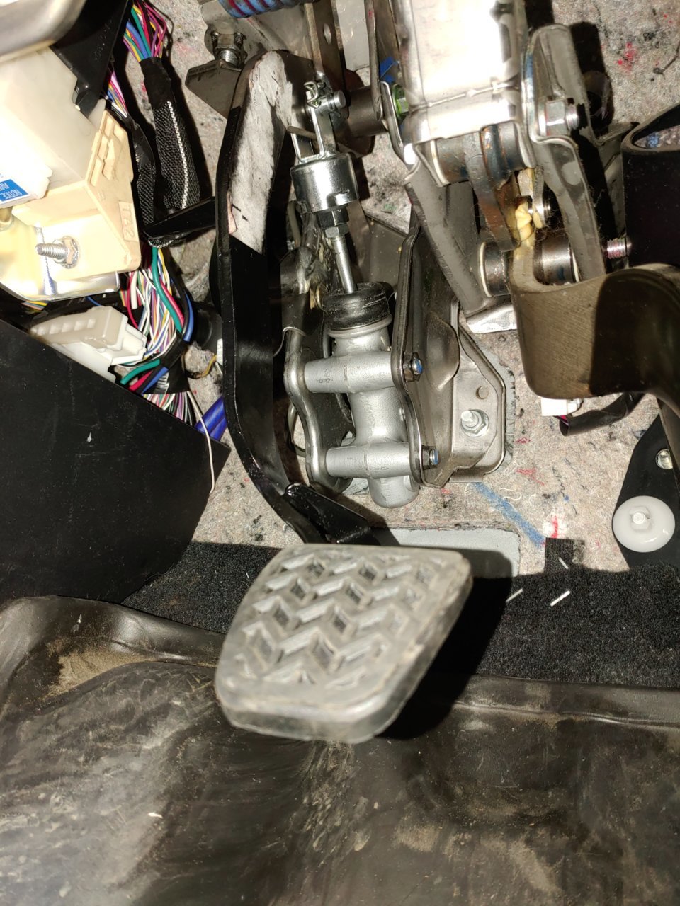

    I'm sure you'll beat me to it. Good luck!

    Probably not, I'm slow like a turtle. I like reading about mods more than doing them.

    FJ all metal pedal swap DIY instructions added to the FJ pedal swap post, thanks to @ShirtTucker and a heads-up from @tonered. are you enjoying it yet, over getting beat up by the install yet, ShirtTucker?
