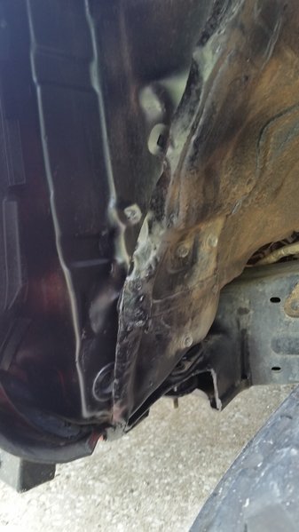

    So @rngr came by and we hacked up my truck. Cut 2.5" off the fenders and bedsides, 2" off the flares, and chopped the cab mount. Beat over the pinch weld, put the flares back on, and put in the front super bumps. I'll get to the rears once I have the charger for my impact back from my buddy. All in all it went very smooth, and I think it turned out great. Hopefully my new wheels show up this next week and I can get them on the truck.

    Yaaaaass bitch. Looks good, it's gonna look nasty on 35's

    Looks good dave. Doesn't look like you sneezed while cutting, so that's good.

    You need to cut your flares and put them back on.

    So way. It was easier than cutting the bedsides.

    Super duper easy. Do your fronts while you're at it. I'll bring you my saw.

    And I have the perfect blades for cutting the flares. Goes super fast.

    Looks great!!! What blase did you use?

    Used a jigsaw blade for "thin metal" that was I think 24tpi for the bedsides and fenders. Jigsaw blade for wood at 12-16 tpi for the flares. Angle grinder with cutoff wheel for the CMC. I used a not quite BFH for the pinch weld. Carter was an excellent extra set of hands, and we got everything done in about 3 hours, including the front bumpstops.
    Hopefully the only other cutting I do is for the high clearance rear.
