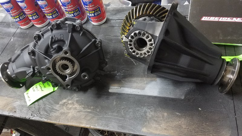

    Hey Dave,
    With 315 tires, what made you go with 4.56 gears vice 4.88?
    I ask because one of the reps I spoke with from ECGS recommended 4.88 if running anything larger than 285.
    ChadsPride likes this.
  4. Mar 13, 2017 at 4:47 PM
    #484
    Dave41079
    Dave41079 [OP] Words go here.
    May 18, 2015
    #155554
    4,226
    Dave...
    Nashville, TN
    The shittiest of boxes
    Things, stuff, and whatnot.
    4.20 gears on 315s would give you the same overall feel as 3.73s on stock tires. 4.56 is slightly overgeared which is fine with me. 4.88s don't really seem necessary to me, and they're weaker gears than 4.56s since there is less metal.
