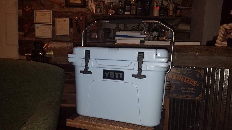

    Wife got me a cooler for my birthday. Also got Amsoil for the crankcase, front and rear diffs, and transfer case, oil filters, cabin air filter, and air filter.
