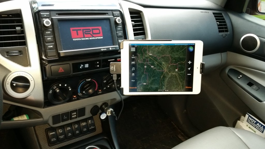

    So the wife had an iPad mini that she never used which means it recently got acquired for truck duty. I am going to use it for monitoring some engine parameters and using it for offroad GPS. I used a Panavise dash mount for the Tacoma, with two RAM 1" ball 2.5" bases and a short arm. Then there is a RAM roto mount and RAM iPad mini holder. It's a WiFi only iPad mini, so I have the Bad Elf lightning connector for GPS signal. I'm typically seeing less than 12ft for accuracy. I'm using Gaia and MotionX for offroad mapping, and OBD Fusion for engine monitoring with an ELM327 adapter plugged into the OBD2 port. I still need to hardwire a charge cable for it, but this should do for now. I'm heading out this weekend to give it a good test.

    I like that switch panel down there :spy:

    I can hook you up with the guy who makes them. He's kind of an asshole though, so don't get your hopes up.
