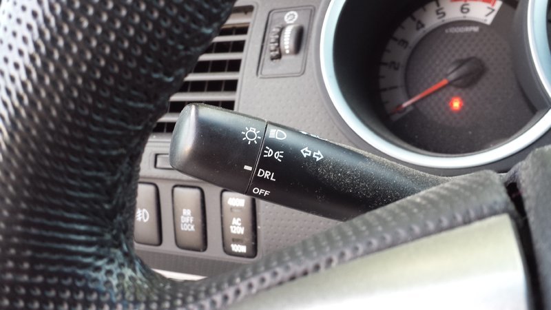

    Any chance you turned off DRL at the switch?

    Where is the switch?

    I'm not exactly sure where that switch would be and if there is one on my truck. My guess is that it would be near the fuse box under the steering wheel but I don't see anything that resembles a switch there.

    On my lowly base '13 they are a clearly marked position on the headlight switch.
