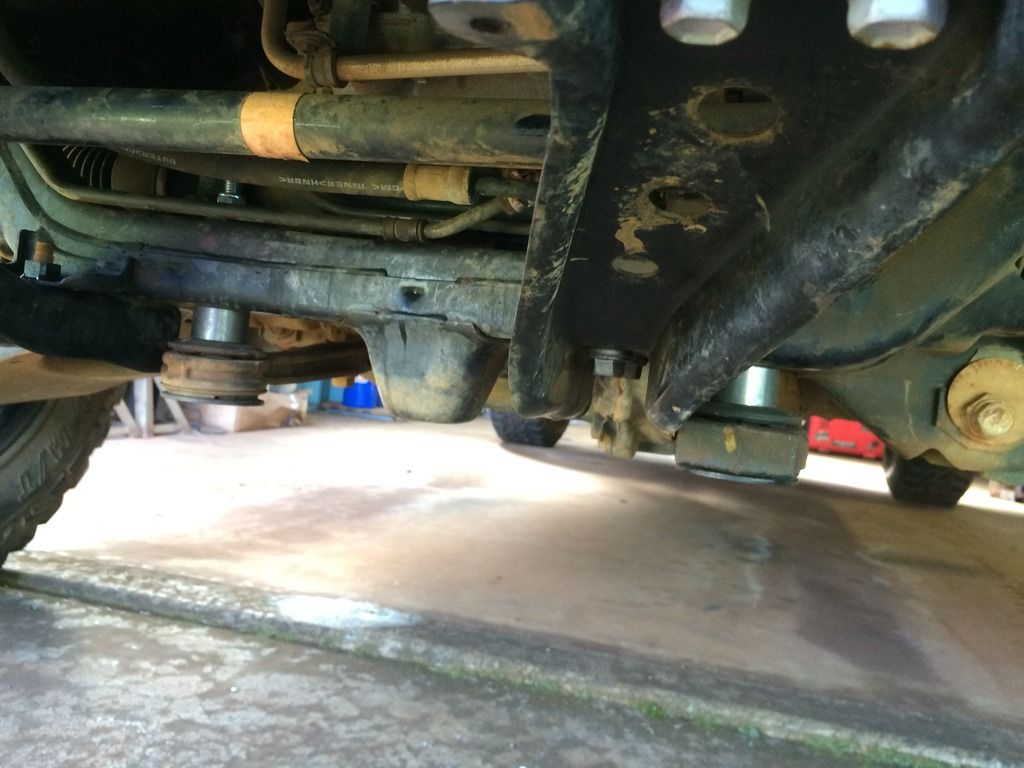

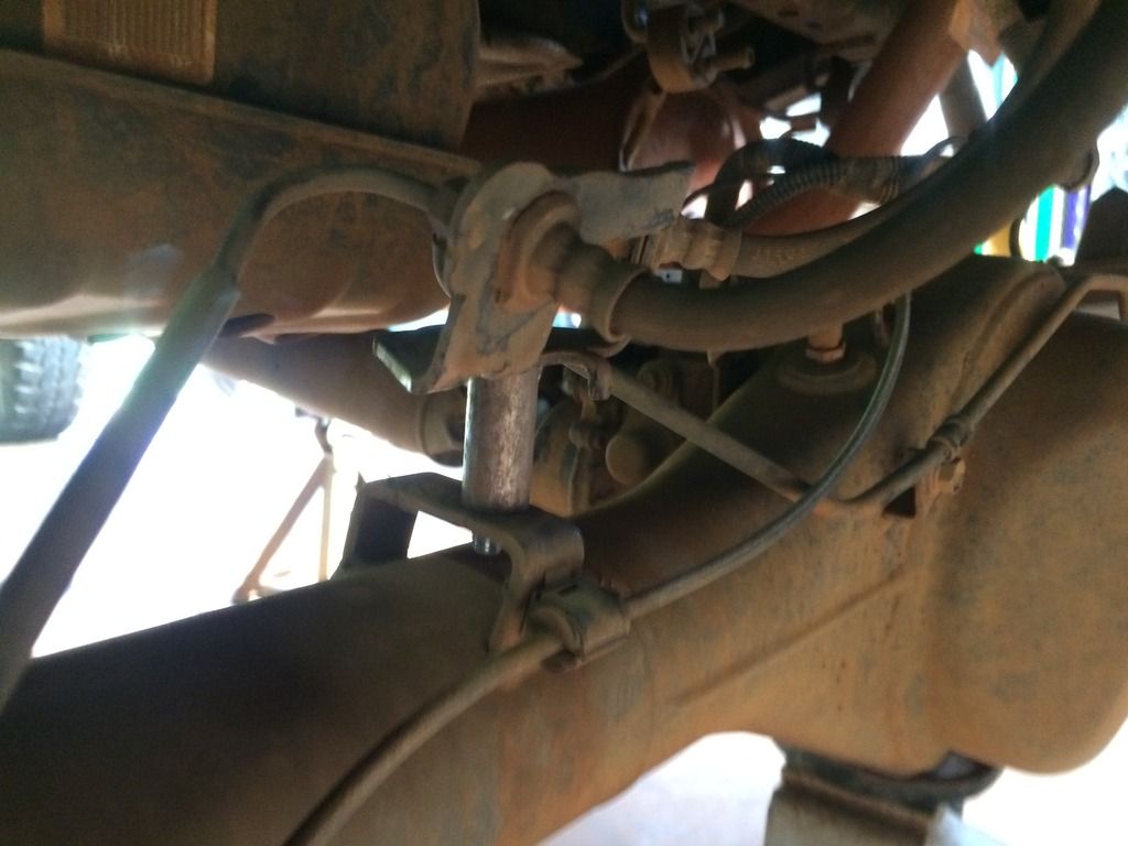

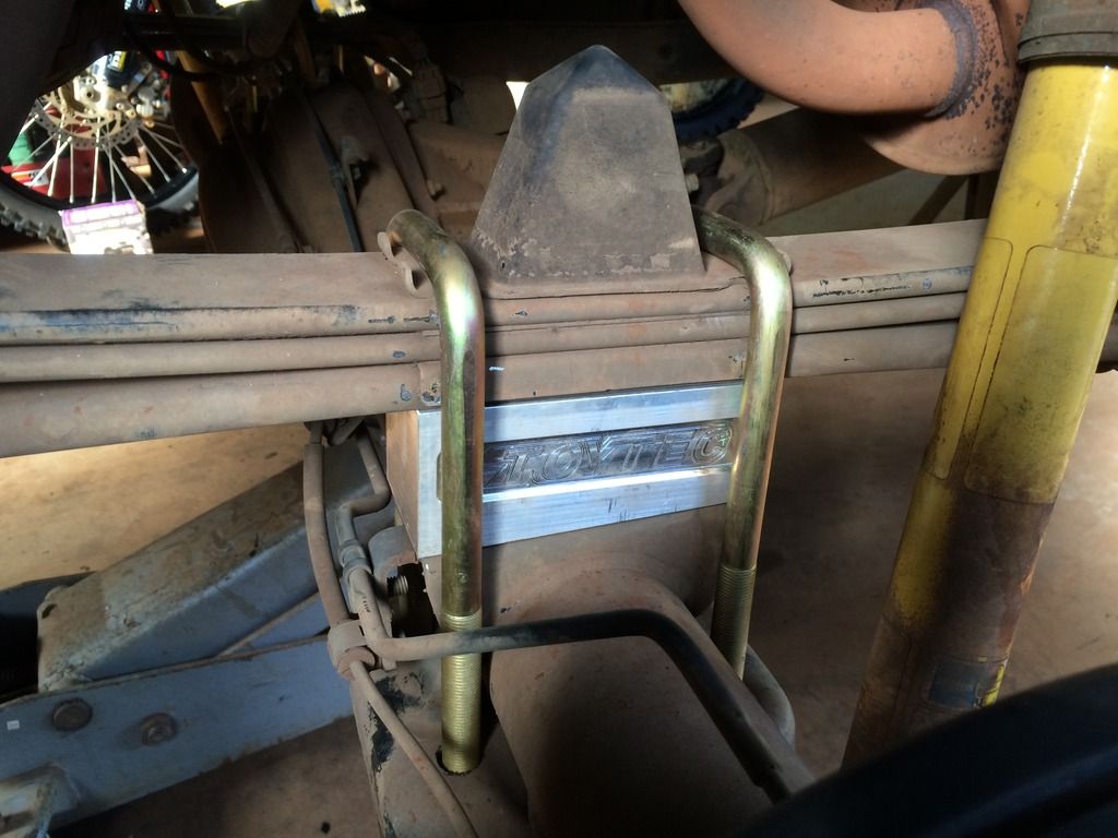

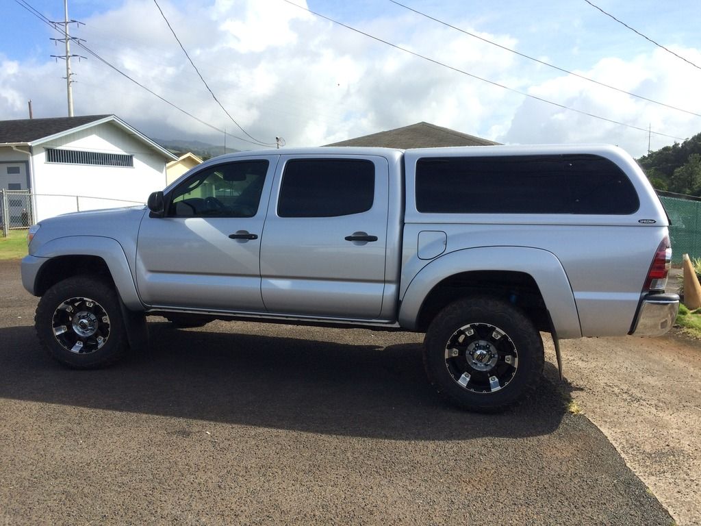

    Lifted for a friend. 2012 TRD Off Road DC/SB. 2 1/2" Daystar leveling kit with 2" Toytec rear blocks. Added a sleeve to space up the rear brake hoses.

    Just a FYI... be really careful with blocks. In the Jeep world they are frowned on. They pop out and some times split and can cause axle wrap.
