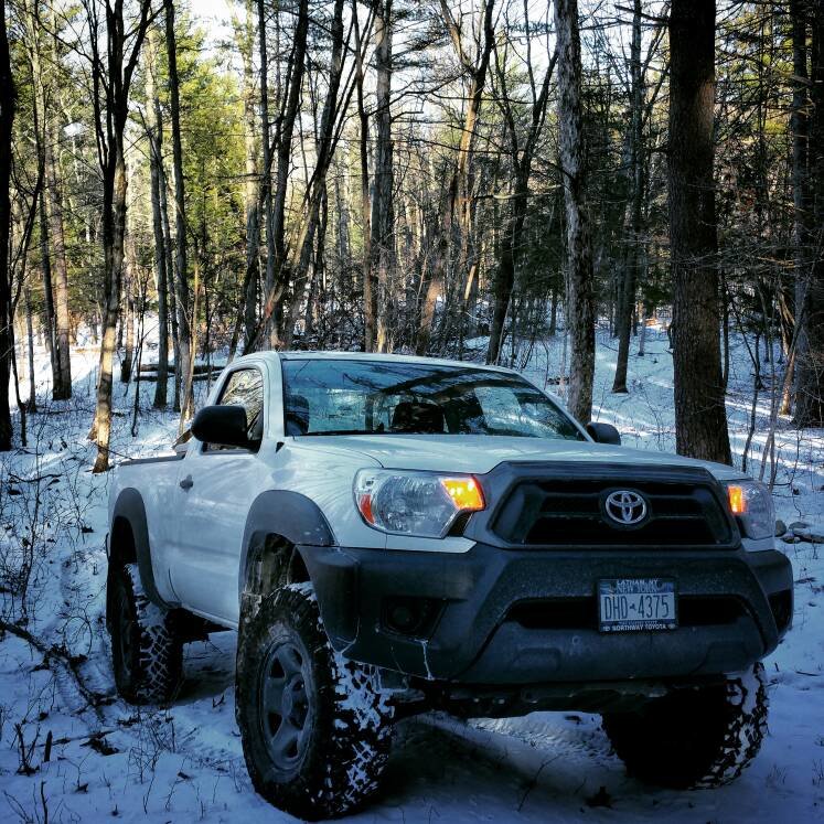

    Ive had the daystar kit on my single cab for about a year now. Easy to install same factory ride and cheap. I run 265 75 16 duratracs with no rubbing at all. Performs pretty good offroad with no swaybar. dd6fd069e6861696aa5c6c89c4c51ddf_469620d5c6860118524f6ab485b51c8a4d84c589.jpg

    Do you notice a difference in your street ride?

    i had it on my truck i think it looked good and i couldnt tell a difference in the ride. i will sell you mine if you end up wanting to get it
