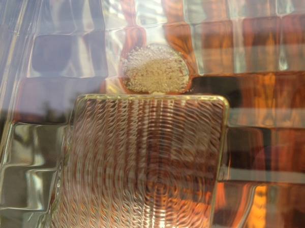

    Getting mine replaced tomorrow under warranty. Both lens have burn marks, getting the whole headlight for both.

    My original lenses melted, had them replaced at the dealer about 2yrs ago and have had no issues since...:cool:

    My drivers side started to melt on my 09 before I turned them off.

    The DTRL turns on when the car is on and when the E-Brake is in the released position. DTRL continues to be on if you just have your parking lights on
    DTRL turns OFF when you have your headlights on.
    at least that is how my 2011 goes.... But I disabled the DTRL because I didn't want to risk the burning of my lens, especially on my LS460 projectors...... My fog lights act as DTRL.

    I replaced the OEM bulbs to a lower temperature set on my 2011 DTRL before I saw any problems. It was an easy $10 preventative fix. Will look for the exact bulb type and #, there are a couple of posts out there about it.

    Mine looked liked FLETCH AKA's and I had them replaced under warranty about 2months ago and I immediately notice they didn't have a amber reflector like the one pictured above has (hence problem with the melting) they should be fine now. I thought they would have given me a hard time like every issue I took to them before but they replaced them @35k miles no questions asked. Very happy with replacement light bulb.
