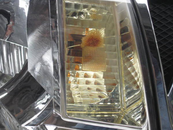

    Just noticed on my 06 tacoma, about 33K, that there is an issue with the daytime running lights. Noted on both, the inner lens shows to be cracked and the area just infront of the bulb is scorched, causing the crack I guess. Seems to be too much heat in there. I have not called Toyota or seen the dealer yet. Anyone else have a similer problem or ideas?

    Quick update, stopped into the dealer, they had never seen this problem. In the picture you can see the cracked inner lens and the scorched area infront of the stock bulb. Both light same deal. The dealer said it was about $1k repair, lucky for me I'm within the 3yr 36K, no charge. Although if it was out of warranty, I wouold have gotten with Toyota.
    Anyone see this issue? Guess either too hot of a bulb or a weak lens.

    Well here I am at 56,000 miles (+23,000 miles) and 18 months later and having the same problem with the daylight running lights! They are OEM.
    Both lenses are damaged in front of the bulb. Never did get an answer from the last time as to why this occurred.
    Called Toyota and the local dealer. Heard from Toyota National Customer Experiernce Group today--some girl told me my truck was out of warranty and that was that. She never saw a picture of what I was talking about or anything. I told there this could be a serious electrical issue as this is the second time--she did not care.
    I stopped by the dealer and spoke with the guy there, without Toyota stepping up there only offer was to provide the labor. These guys are $287.00 each side!
    For some reason I have a third party extended warranty. If I can convience them it is an electrical issue and not just a faulty lens they will cover it.
    I am not done with Toyota about this by any means. Does anyone have thoughts as to why this problem would occur????? I will add the new example, lens not cracked yet like the first one.
    Any help or thoughts greatly appreciated.

    i would imagine it has to be too much heat coming from the bulbs...maybe too much wattage to be that close to the plastic? definitely call the toyota customer service and bitch that this is the 2nd time and there are others that have had this issue

    As I mentioned, after contacting Toyota USA HQ number and got a reply from Mr. Lentz's assitant (go right to the top for results). It has gone back and forth, they assume that I may have added HI lamps, but it is all stock! They say they really don't see this on the Tacoma but see it a lot on Highlander, but usually due to HI lamps.
    Well they still don't know why I have had this issue twice but they will now take care of it the second time, even out of warranty.:) Pays to not take no for an answer. I told her I still want to know why this occurs, don't want to have it happen in another 23,000 miles and have the hastle again. If I find the answer I'll add it to the post.

    Looked at my truck today, and mine are starting to melt. Guess its time to add a switch to turn them off or I'll swap out the lens once it gets real bad with the extra set I have. I added them to the truck which have been installed for 2 years now.

    Well good news is I still have my 06 Taco, bad new it has been another 30,000 miles (now 86,000) and my stock (dealer replaced) daytime running light lenses are melting again. This is the third set. 33000, 560000 and now again at 86000. Can't wait for the go around with the dealer and Toyota about this. As I have mentioned I have gotten them to cover this DEFECT the last two time. Now they have two more lenses to replace. I've seen this has been a continuing issues even with much newer models. :mad:

    I researched this awhile back but never came to a head on it. I installed myself some DTRL later on with the quick swap DTRL relay. My bulbs are single filament bulbs and IIRC only two wires going into the socket. Can you double check your bulbs and find out if they are double filament and if so, are both of them lighting at the same time? I have yet to have this issue and I live in one of the hottest places in the country. FWIW: I may move to CLW in a few years for my next transfer so maybe see ya around? :)

    The DRL are original equipment. Just got a good look and the bulbs have a double filament, right now neither is burnt out but now the DRL don't come on, however the turn signal works, did not see an issue with fuses. I'm sure I get the out of warranty BS, not for me, this is a manufacturer defect that is also a safety hazard, this will be on their dime for the third time. Be nice if there was an LED option to change ove to.

    I'm pretty sure my setup is a single filament. I forget but I could double check. It makes me wonder if theres two different DTRL setups.

    from what I've read so far this has happened to many people with DTRL. An easy fix would be switching out to LED's since they burn cooler than the stock ones.
