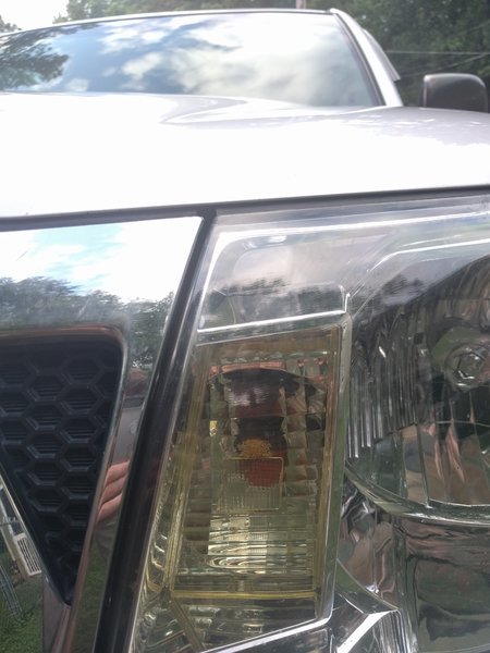

    So my DRL are melting the headlight housings again, just as they did before I had them replaced under the recall / TSB. Is this still active? I can't seem to find if they are still replacing housings.
    Been approximately 1.5 years or so since I had them replaced.
    Any insight would be appreciated

    [OP] can you post photos of your headlamps--the upgraded ones are readily identifiable.
    The originals look like this--note the plastic DRL sub-assembly, and the prismatic diffuser moulded into the lens (below the burned spot):
    This is a replacement housing--the sub-assembly is made of glass, the prismatic diffuser was eliminated:

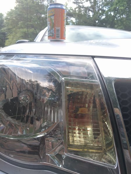

    IMG_20170523_193228.jpg IMG_20170523_193240.jpg I'll be damned, those reckless morons at the dealership bamboozled me. Thank you for the information, grabbing the pitchfork and torch tomorrow.

    Yup looks liken they installed a new set--of the defective headlamps; damned idiots. Shit like this is why Toyota is losing it's edge.
    Here are the part numbers for the upgraded housings:
    See if you can get them to order the "sport" housings--they have a dark gray surround that makes them a bit distinctive:

    Please do this would be great intel; however I'll wager the repair order will show the part numbers for the upgraded housings--where they are now is a whole different story:
    To be nice, it could be that through just plain incompetence they installed a "new" set of obsolete housings they had "on-the-shelf";
    Or, it could be deliberate malfeasance in which they ordered the upgraded housings but installed installed the obsolete housings--the repair order indicated the upgrade housings were installed and the obsolete housings were removed from parts inventory, replaced by the new ones;
    Or, they took the obsolete housings off a new or slightly used truck on the lot, installed them on the customer's truck and put the new ones on the vehicle in inventory--perhaps a "technician" took them from his own truck so he could get the new ones;
    Or any number of possible scenarios in which the customer got a new/newish set of obsolete housings and the new housings went somewhere else...

    So after getting the run around from the service concierge, I finally got ahold of the service manager who asked for photos of the housings, VIN and odometer. I got the impression he wanted to make things right, so I'll give him a day or two as requested and see where it gets me.

    Part Qty: 1 Part #: 8111004163 Part Desc: HEADLAMP ASSY, RH
    Part Qty: 1 Part #: 8115004163 Part Desc: HEADLAMP ASSY, LH
    So they did install the incorrect part on the truck.

    So per Ty, they actually documented replacing my headlight assemblies with new, still defective assemblies. Should help my case if they try and give me the runaround.

    It does a lot more than "help" your case, pretty much seals it.
    The next question is was this incompetence or deliberate? Based on my experience with dealers it could go either way...
    Here is the last revision of the TSB (PDF, 230kB), it includes a table showing both the old and new part numbers for the housings:
