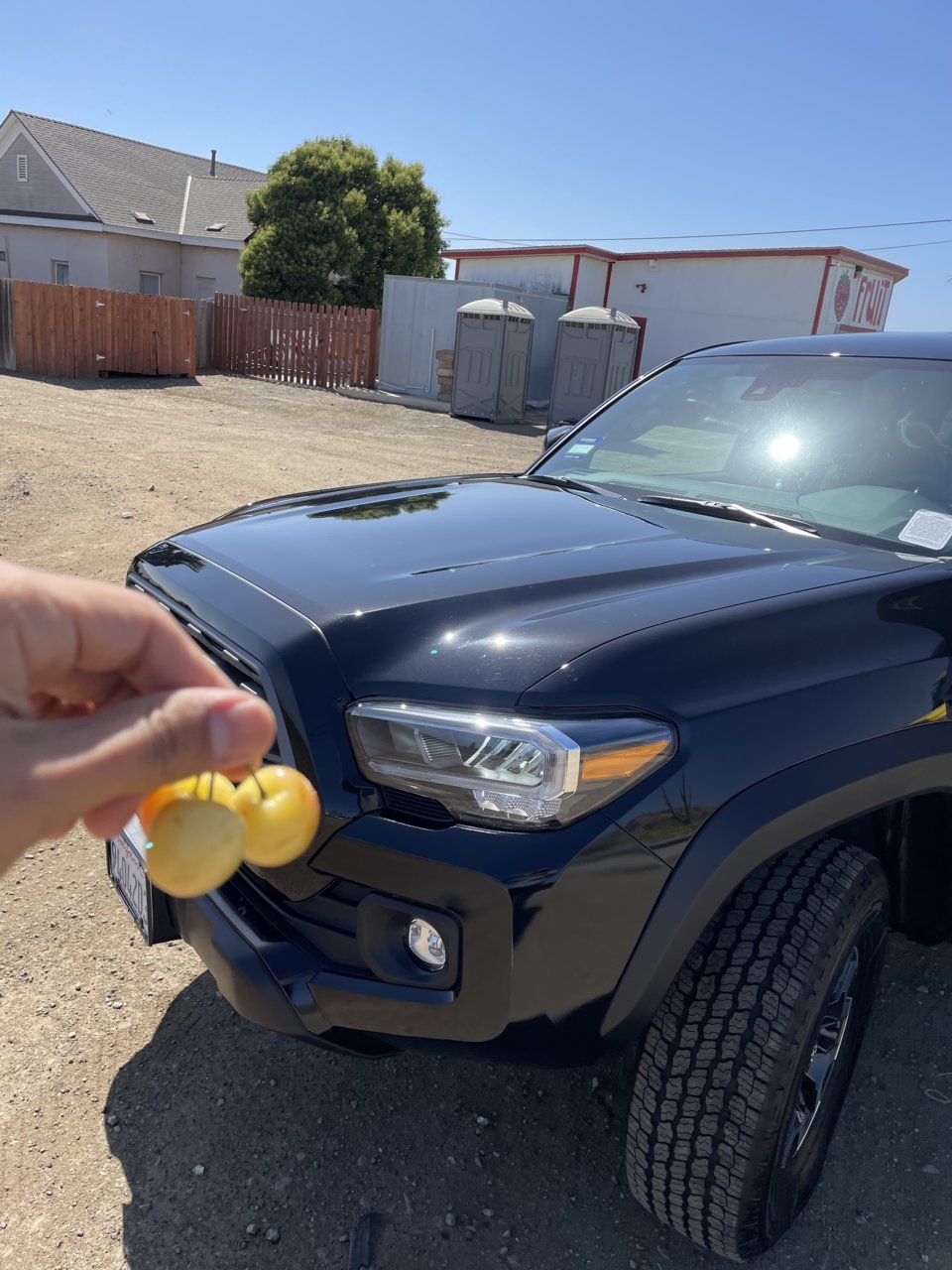

    here’s a photo of with the car on and no light bar from DRL

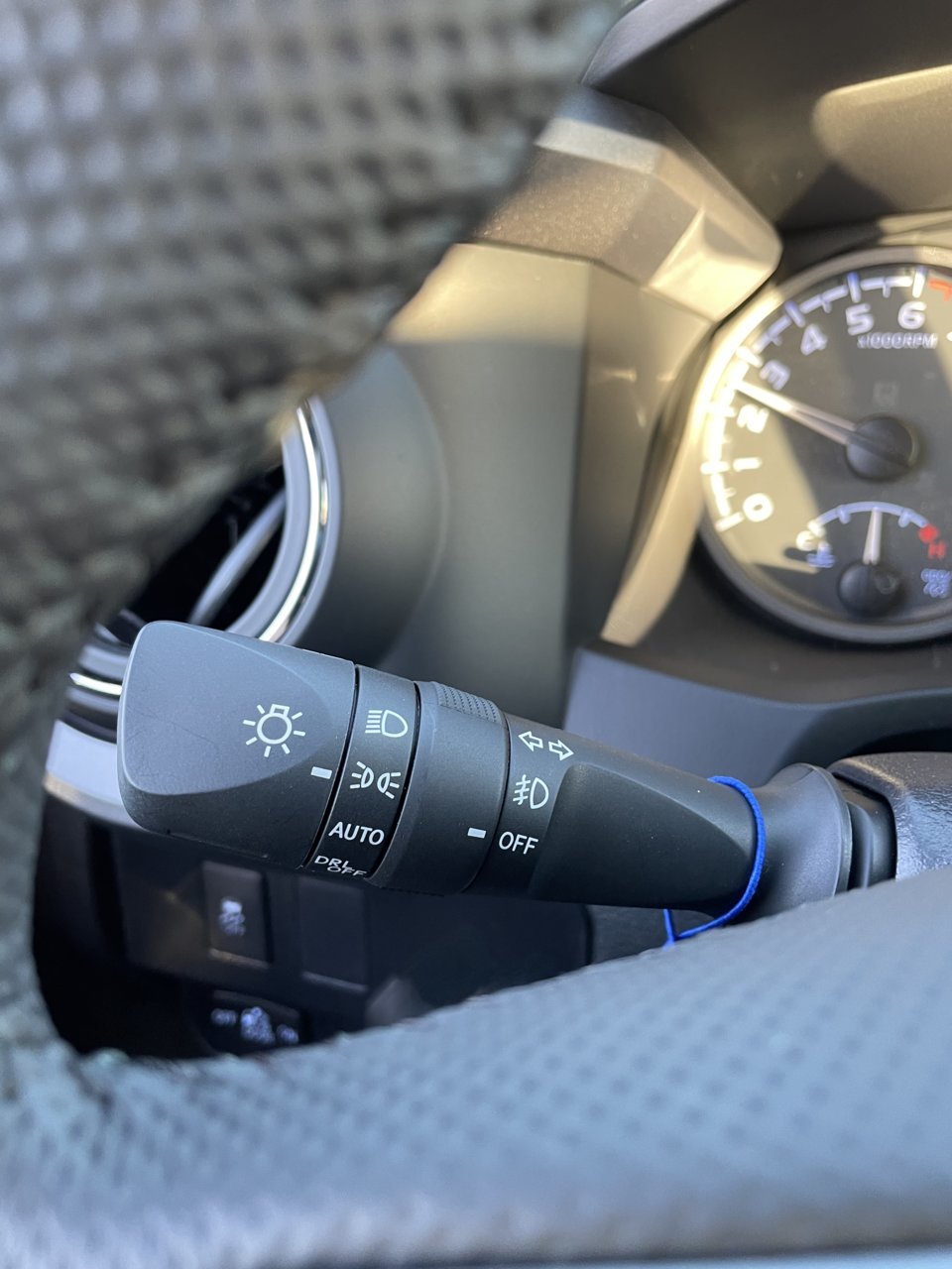

    Is this the spot.
    suaveflooder[QUOTED] and Skydvrr like this.
  6. Jun 6, 2021 at 7:08 PM
    RedWings44
    RedWings44 Well-Known Member
    Apr 28, 2020
    #326226
    8,009
    Michigan
    2017 Black TRD Off Road 4x4, 2019 MGM 4Runner SR5
    They should still come on with "auto."

    In auto with the engine on parked, they didn’t come on

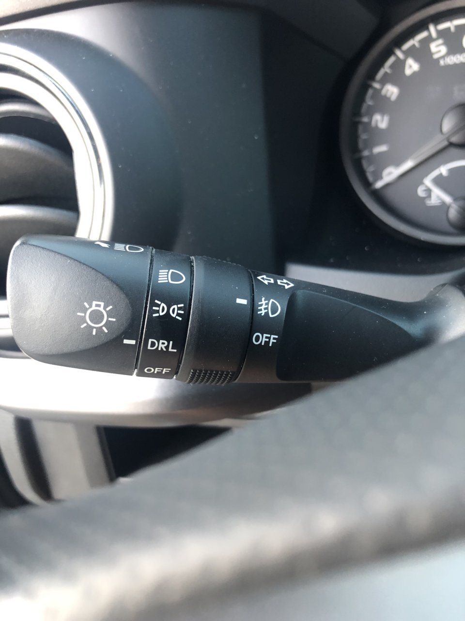

    drop it to auto and take off the e brake and then pull it back on. Should stay on. My stalk is different. They changed it from the 19 on up

    My 2020 has the same stalk as yours, I don't have factory leds either, maybe it's different for those
    suaveflooder[QUOTED] likes this.
