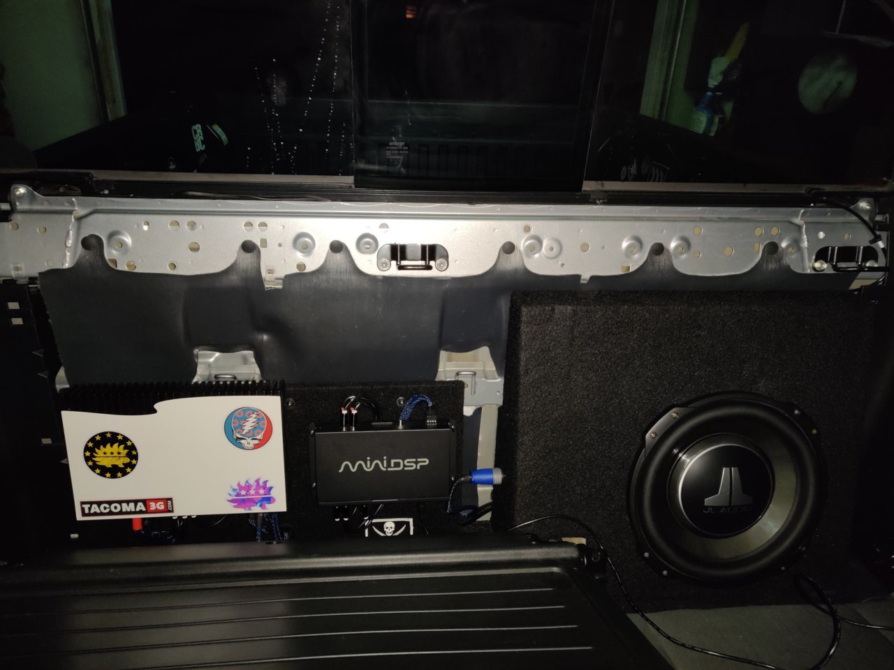

    Well the miniDSP came in today. No annoying whining noise. All the games and levels have been set correctly. I haven't even gotten to eq-ing each of the channels and it already sounds great.
    Initial throw together crossovers-
    Widebands - 1200hz - 20000hz 24dB slope
    Woofers - 90hz - 1200hz 24dB slope
    Subwoofer - 20hz - 90hz 24dB slope
    This is the initial tune, just to get me rolling. I'm going to be using Andy's tuning guide and Room EQ to.eq the channels.

    I sounds like it needs some tweaking, but it sounds nice. When the sub gets here it will sound much better honestly. It definitely sounds nicer than it did with the passive crossovers. The widebands on the dash sound crisper.

    badhabit2break and rob feature like this.

    Night and day, eh?
    Gotta love some Erin's - he's been testing a ton of stuff lately.
    Is that a Speakon connector on your sub box?

    Yes/no. It's a speakon connection but my wiring. Bad position though lol.

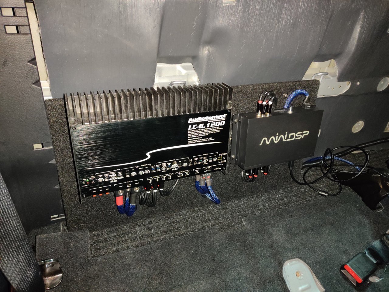

    After a couple of weeks, I've decided to go back to the Morel Tempo Ultra tweeters instead of the CCWR 254 widebands. I was missing just a little bit of detail at the top. I have them crossed over at 1800 24dB slope with the 6x9 drivers topping out at 1800 24dB slope. The detail at the top is a lot nicer. The passive crossovers that came with the set crossed at 3200 6dB.
    I still haven't gotten the opportunity to get rolling with the REW to EQ each of the channels - it just seems like there isn't the time to dedicate to it right now. That said, I used Erin's time alignment calculator and set up 3 listening positions, and they sound great!
