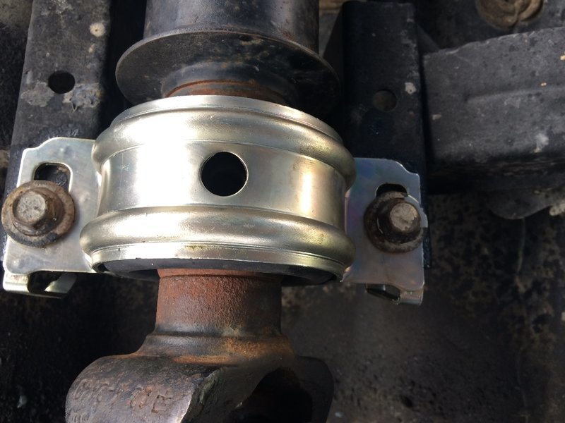

    Here's another one if it helps! And thanks so much guys for taking the time this morning! Appreciate it a lot!

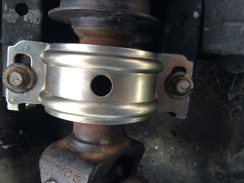

    Looks off center to me. The gap right above the bolts should be the same distance.

    It does look like its crooked? The bolts arnt even on both sides? That might be the problem?

    Is it a factory carrier bearing or aftermarket? I once used a non-factory bearing and it wore out super quick, within a year. Although in my case it was mostly the rubber disintegrated after just one winter rather than the bearing itself.
    BTW, it does look crooked on the driveshaft. You may be able to get it straight but I suspect the bearing may be ruined if it got pressed on like that. Assuming the carrier isn't just forcing it to twist. You may be able to loosen the bolts and the whole thing straightens out.

    the bolts should be equal distance from one end or the other otherwise its twisted...

    I wouldn't keep driving it that way. All you have to do is loosen the bolts and even the gaps. If you don't have the tools see if a buddy can do it for you. Were talking just a few minute job.

    What you may try is, strike the u-joint yoke ears with a wooden mallet. It is possible to install a u-joint too tightly inside the driveshaft yokes. I wouldn't think a little bit of eccentricity in the carrier bearing would cause this since the bearing is basically floating in a rubber boot.

    Oh, wow... Yes, this ^. Just put my glasses on and looked at the pic again. That is more than "a little".

    Just evened the bolts taking for test drive (crossing fingers)

    Ugh.. Evening the bolts didn't fix the squealing still there in 2-3 gear 4th to fast to hear.
