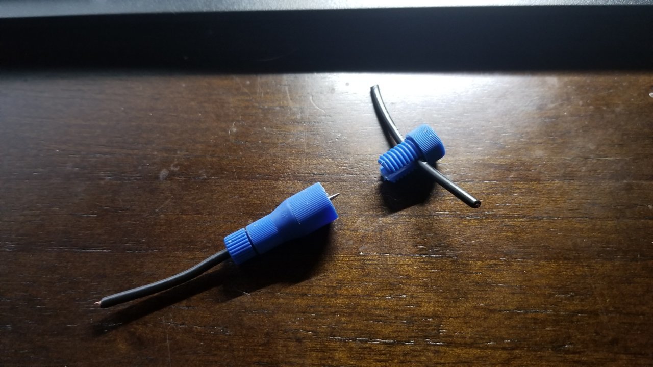

    thanks for the info! but the "power" wire on the grill wiring harness had a wire tap already installed...it unscrewed from the tap end, and the pre-installed half had a "spike", the piece that screwed off was slotted for the wire you tap into, place that wire in the slot re-insert to other half screw/tighten it up bam done! when I took it off the green wire, all that I saw was a puncture left in the green sheathing of the wire, wrapped green electrical tape around it and moved on...wish I knew what this type of wire tap was called...thanks again!

    Posi-taps...

    that'd be the one

    Posi taps > scotch locks
    Use plenty of dielectric for a minimal amount of weatherproofing
