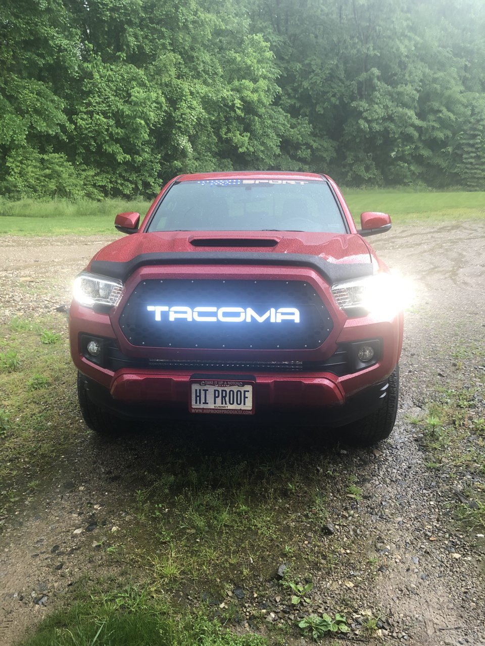

    My grill arrived yesterday and it took longer to wire power to it than it took to install it. Nice grill, I really like it thanks Danny

    That looks pretty good man

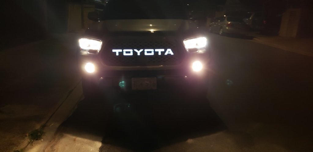

    That happened to me too lol cop followed me i thought i was going to get busted
    But he only asked where i got it from hahah
    Yup attention grabber

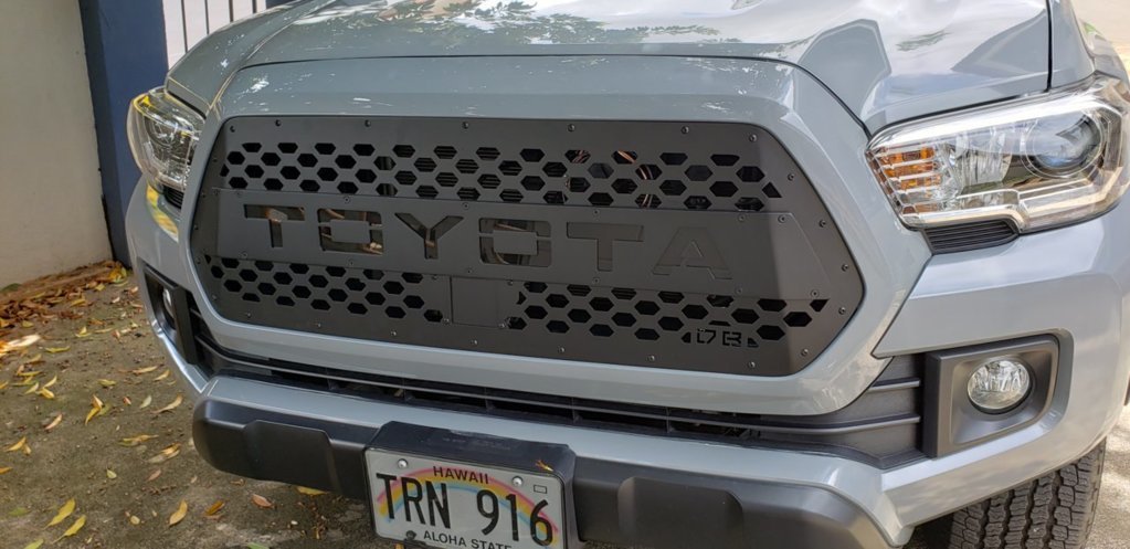

    I almost messed it up big time lol
    Ill share my experience about this thing
    Hoping itll help and dont go through what i went through hahahah
    Test fit
    The holes for the screws dont fit right
    If you forced it in the grill will not aligned right to the plastic
    Made the holes bit bigger so i can movwd the grill up down side to side perfect fitting with the plastic
    I have used may soldering iron
    Just melt the plastic
    While the grill is in there
    (You dont want the holes too big)
    Then use blue loctite thread lock
    DO NOT OVER TIGHTEN
    It will bend the plastic this is a very rigid grill
    Just snag fit is enough

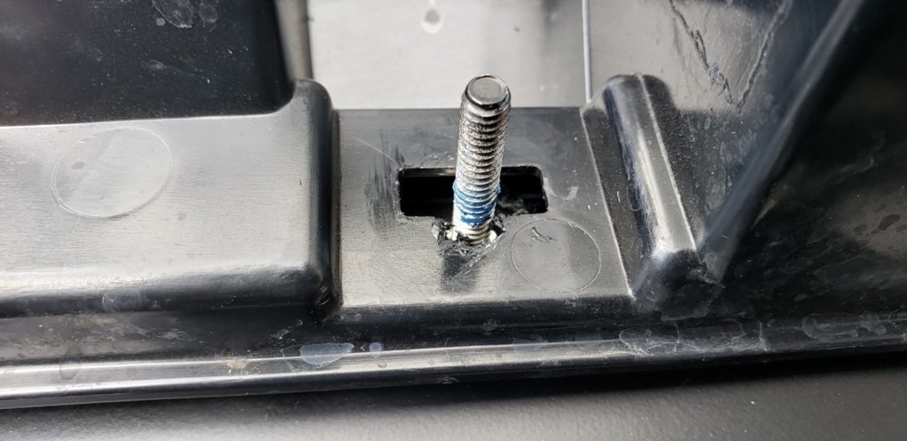

    Heres one of the bolt and the holes
    Its a tight fit
    And if you just forved it in
    It will not sit prefectly with the plastic
    By making the holes a bit bigger you can perfectly align it with the plastic
    Centered
    And the easiest way to make the holes bigger soldering iron just melt the plastic20190429_102408-1.jpg

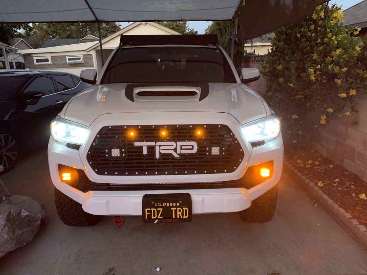

    9C91DBE5-4DFA-4BCA-832C-BDB85AB53ED1.jpg. 300 industries, I added the Raptor look lights
