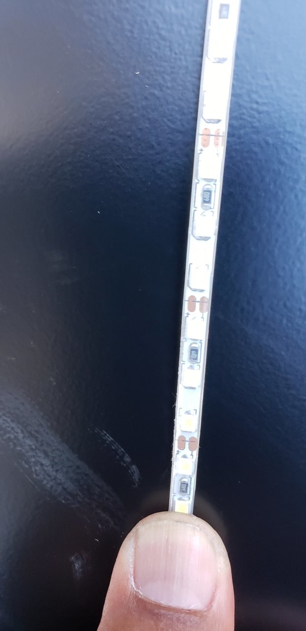

    Update

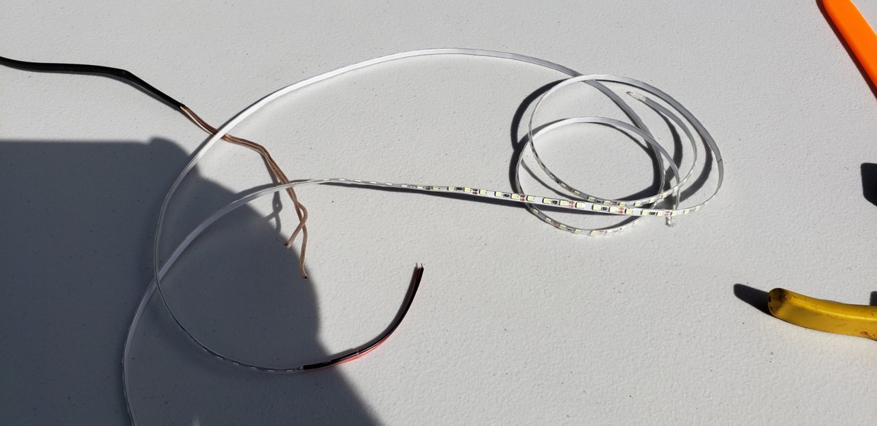

    I received the led from danny
    couple days ago
    But didnt have time to do it
    The led is just a regular led strips
    Nothing special
    (If i knew the led was like that i would of just bought a replacement on ebay

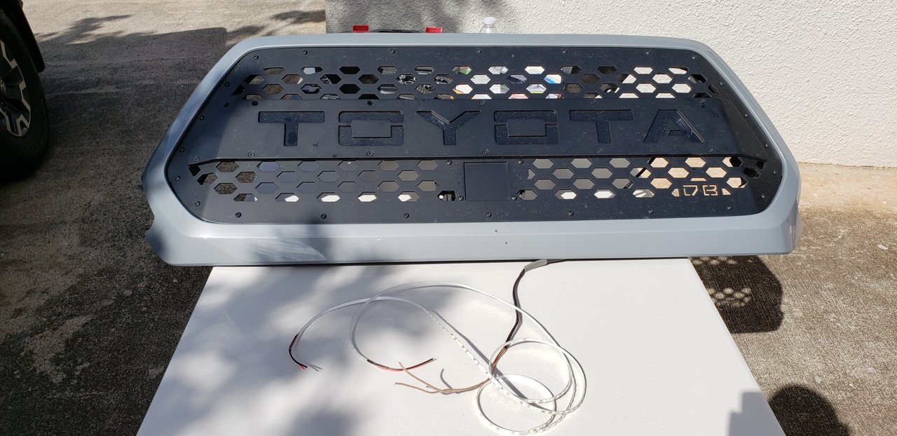

    Removed the grill from the truck
    Removed the toyota sign from the grill
    By removing 14 screws
    Heres the hard part
    Once those screws are off
    Itll come apart in to 3 pieces
    The led is sandwich between the black plastic
    And the toyota logo
    When you get that led aligned
    You put another layer on top
    To sealed it off and screw it back on
    Youll need zip ties to hold everything i place then screw it on the grill

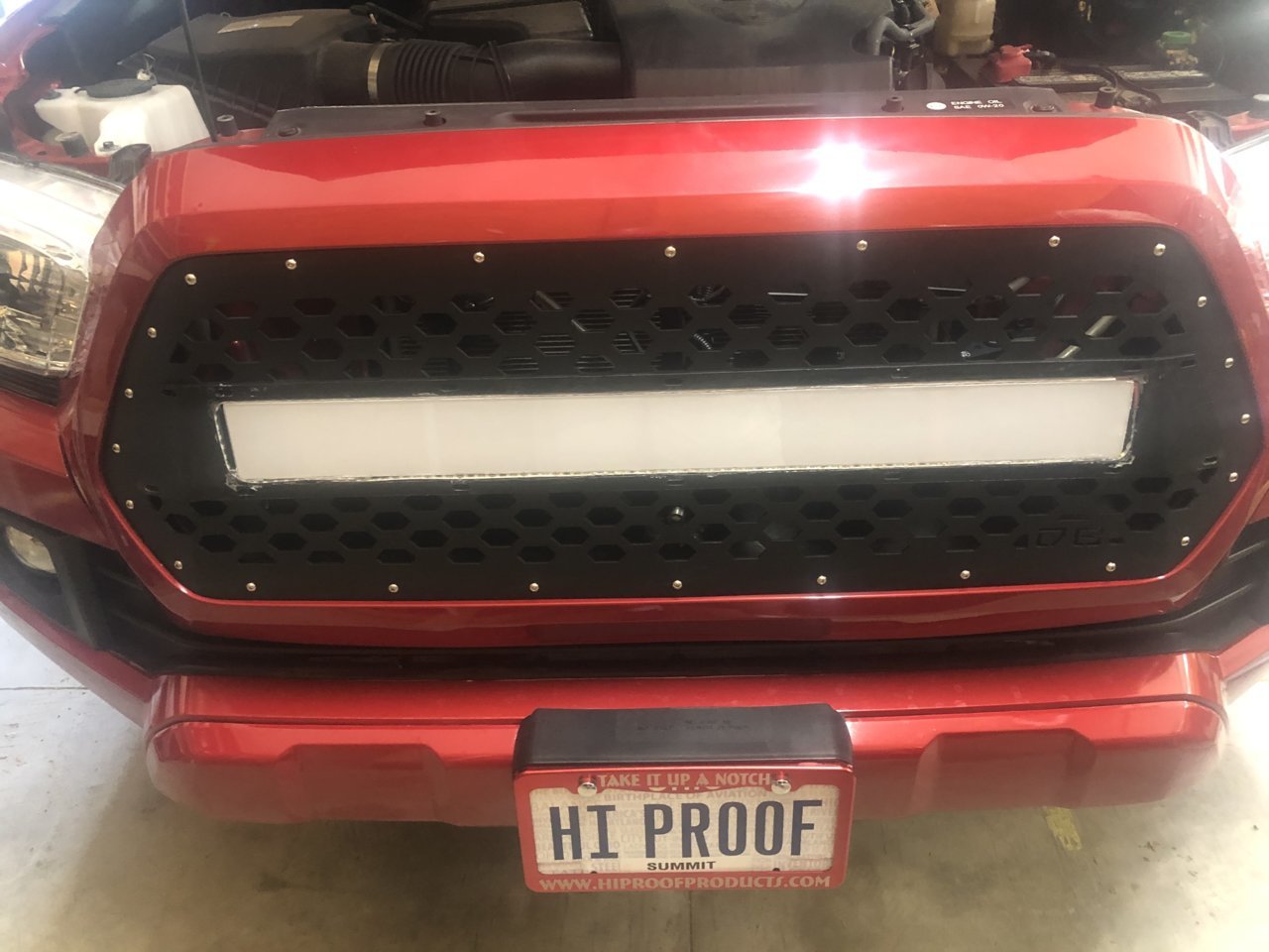

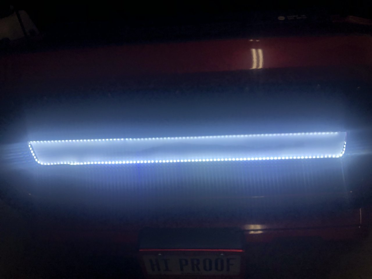

    86236B9D-65C9-40B4-A003-C67C2B028DA9.jpg 0E25D18E-6A50-42D7-9552-70DB364B073E.jpg 86236B9D-65C9-40B4-A003-C67C2B028DA9.jpg Mine is white acrylic. Are the any marks or numbers on the led strip itself?

    I dont see any numbers on it
    Just cut to length and good to go
    Im thinking of changing mines too to clear
    This was a clear acrylic but they painted it black

    I guess the thing that concerns me is that the led strip you show is not waterproof. Waterproof led strips have a thick silicone put on them as they are manufactured. That said i’m sure it’s a matter of time until you will be doing this all over again since it will get wet every time it rains or you wash your truck.
    I have some of the waterproof led strips ordered for a light i’m going to place inside the hood scoop. I’ll post a picture of that once it is finished.

    Is the acrylic painted on only one side? If so i’m assuming it’s the side facing the backside of the grill
    trdtacomahi likes this.

    Oppss this aint waterproof led?
    Lol ill be ordering a waterproof on ebay then

    Yes its painted the inside facing the radiator

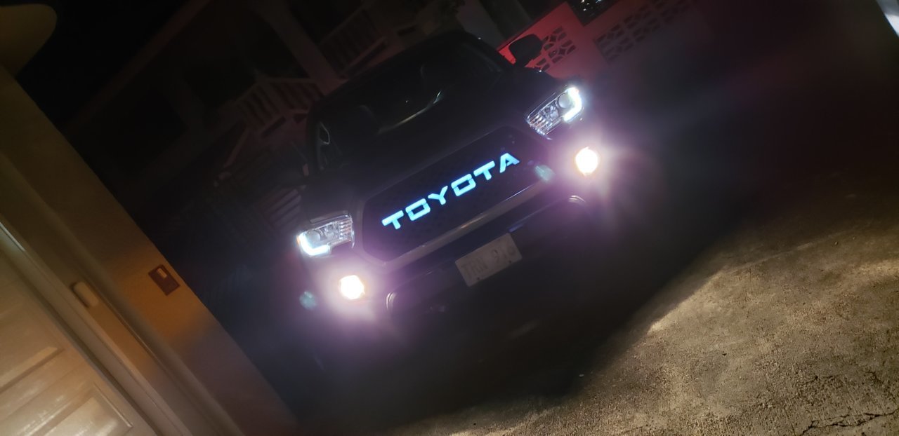

    Soo glad its working again
