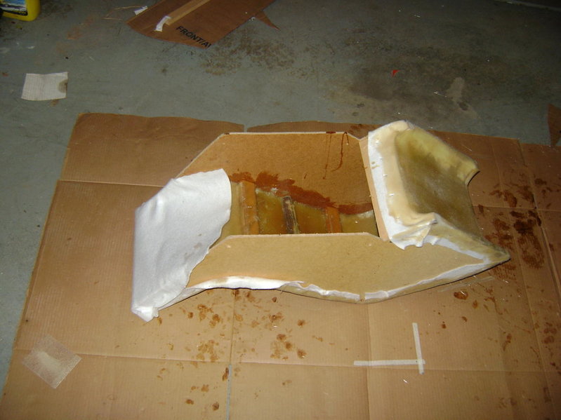

    thats a good point. I will more than likely be carpeting it. does anyone have some photos of their fiberglass box in the making? I know there are a thousand sites on the web that have how to's on this but its always nice to see one meant for a Tacoma :)

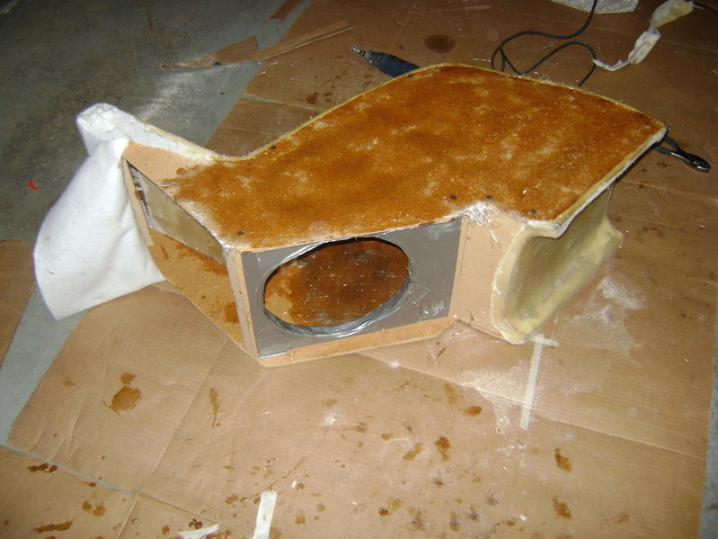

    you can see in this pic on the inside in addition to the wood braces i made some from cardboard.
    i had to use the wood braces to hold the sides apart exactly 11 inches while i wrapped the outside with fleece. they became part of the interior structure as i applied the glass. then i added the ribs about 4 in total to the areas in between. the sides being hardboard seemed to be strong enough with 2 applications in the inside of the box and one on the outside. despite they were flat surfaces i did not need any reinforcement in these areas. the hardboard itself becomes pretty stiff when resin soaks into the fibers and the glass mat in addition to that makes it strong. also the surface area that is insupported in this box is relitivly small so it wont flex. but in the back of the box your making along the wall your going to have to reinforce it because its a long span with no support. in fact i would even reccommend you cut some small peices of 3/4 MDF in strips to add bracing between the front and back of the box.
    you can add these later by using a straight edge across the front of your box and measuring the distance and angle between the botom of your straight edge and the back of the box. then cut a brace to fit in and glass it to the back. you can then glass it to the back of the front peice when you install it later.
